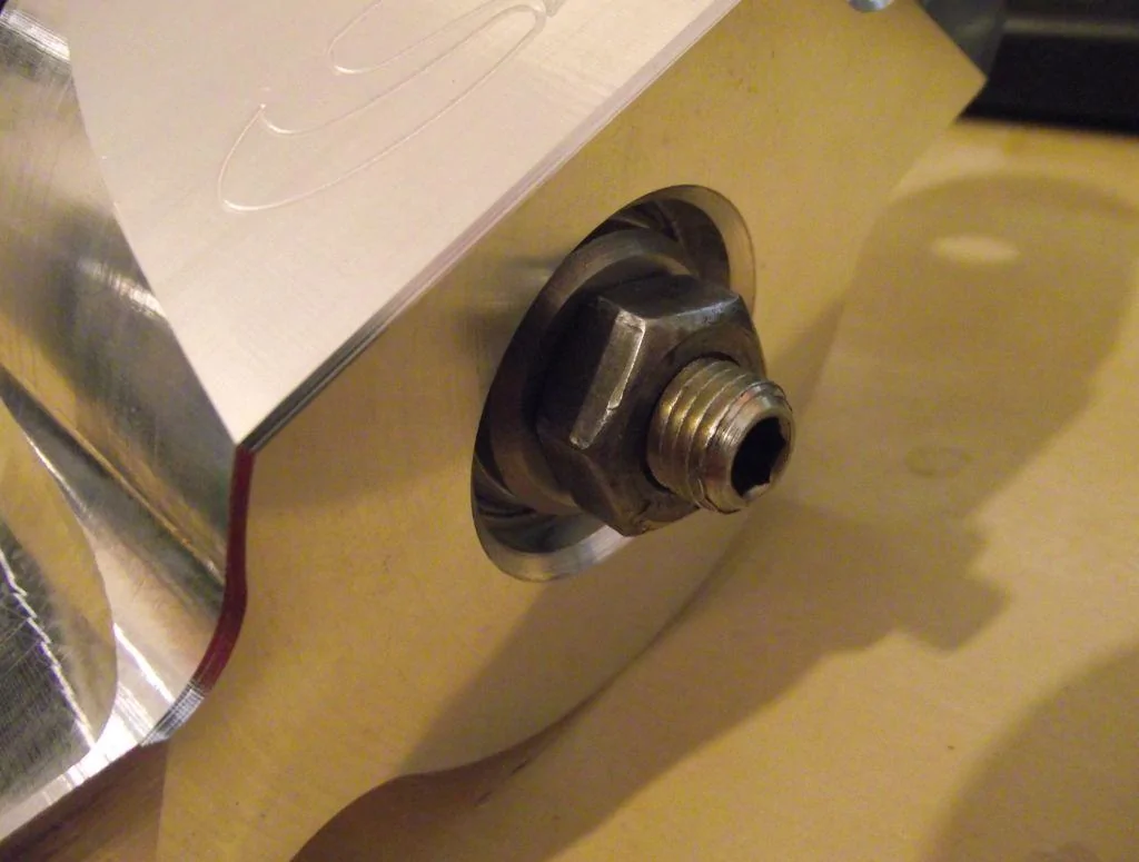

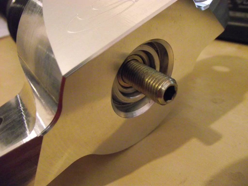

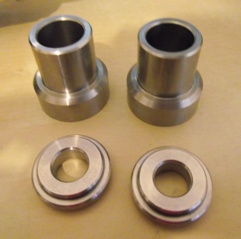

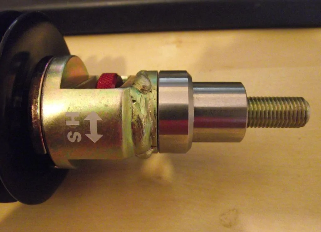

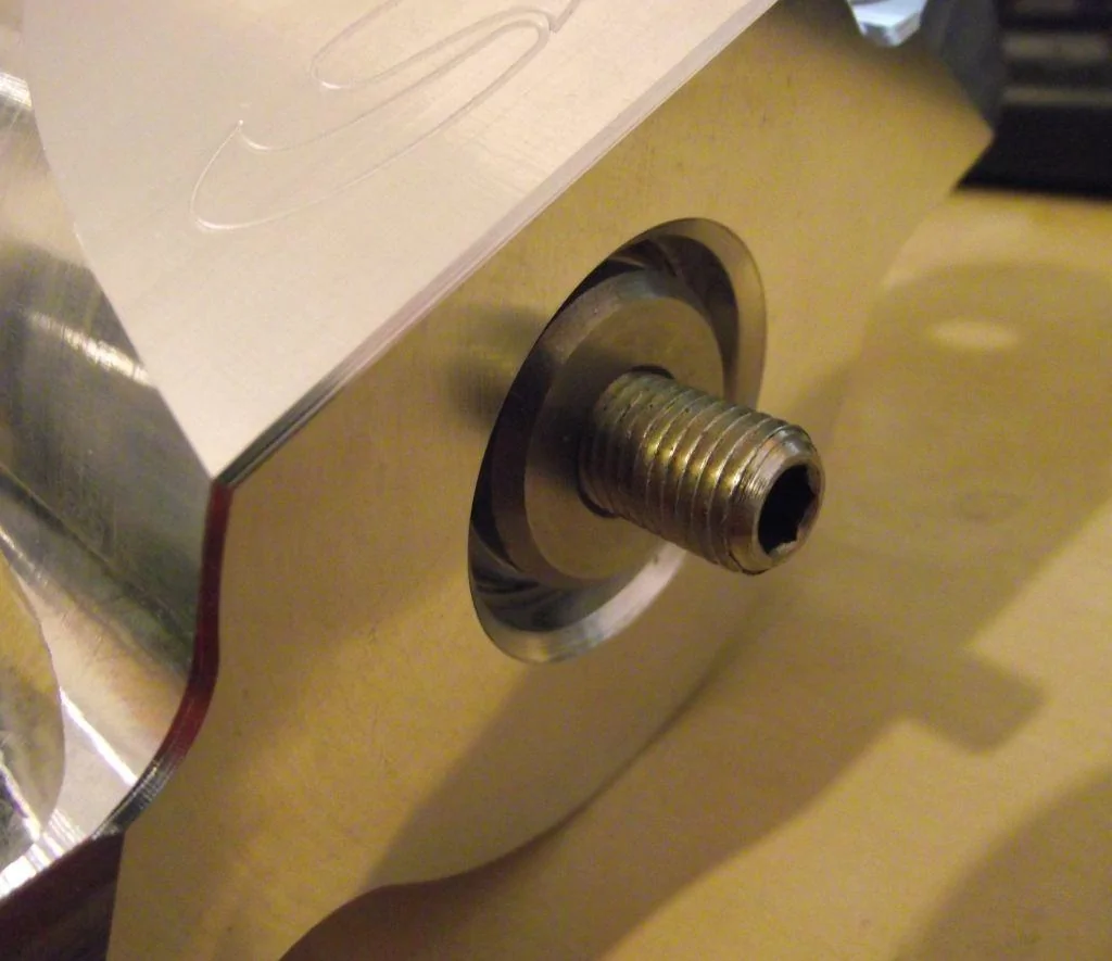

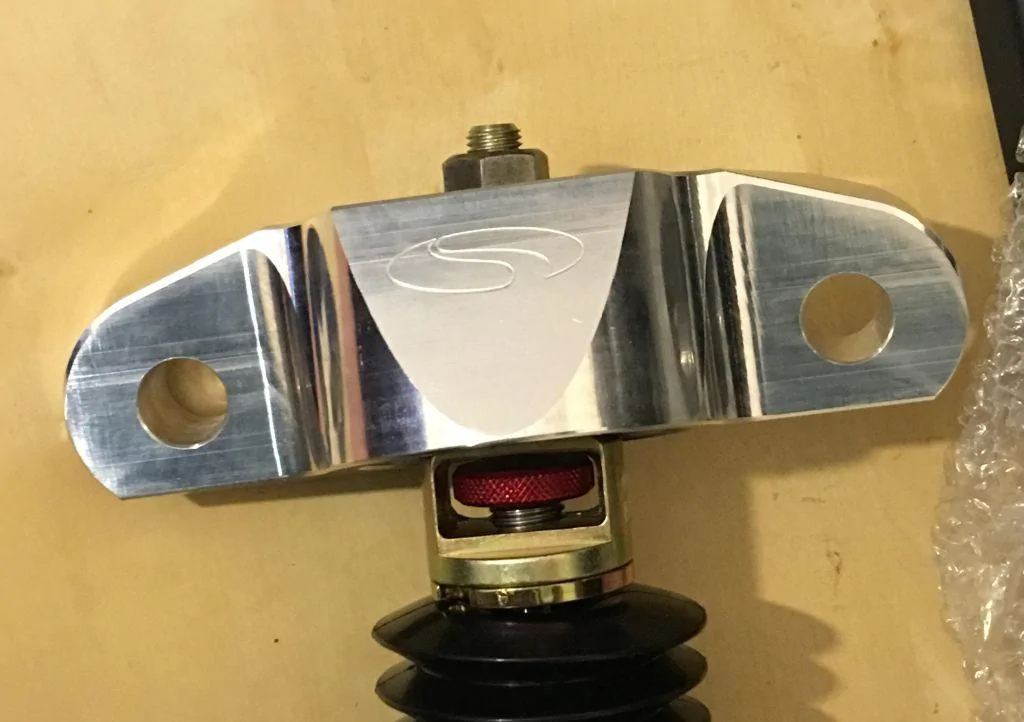

The wait is over guys.. here they are, made from stainless so should last forever.
I am also putting the fitting guide here..
Pic 1. The kit
Pic 2.Place top hat onto Pedders rear shock.
Pic 3. Drop Steeda mount onto Pedders shock and top hat
Pic 4. Add smaller top ring.
Pic 5. Add Pedders supplied Nyloc nut. (I have used plain M10 fine nut here).
Pic6. View of assembled shock.
Once these spacers are fitted the length of the shock must be adjusted in accordance with your ride height. Note these spacers are for track use only. They are not supplied with any guarantee other than to allow fitting of Pedders rear shock absorbers to Steeda Top mounts. You fit these at your own risk and I will bear no responsibility for any actions or events that occur as a result of having these spacers fitted to your car.
