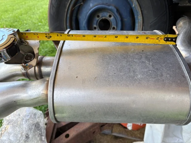

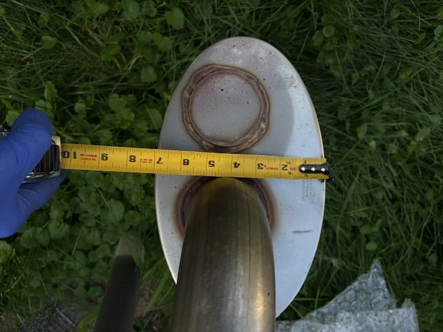

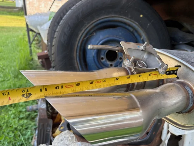

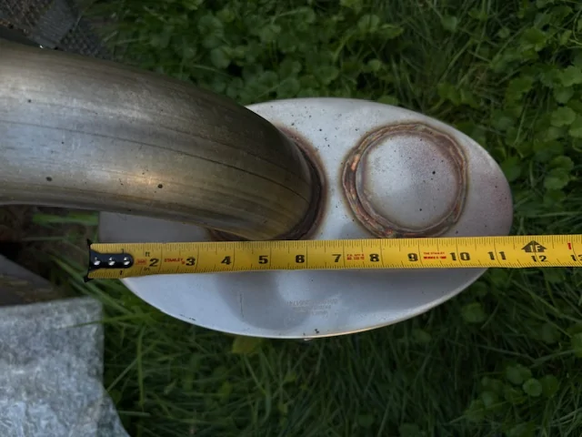

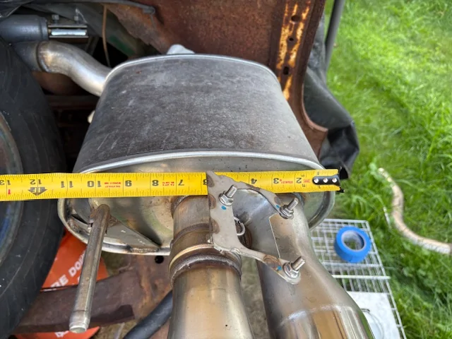

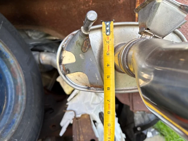

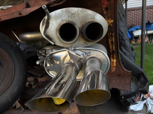

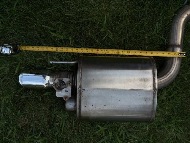

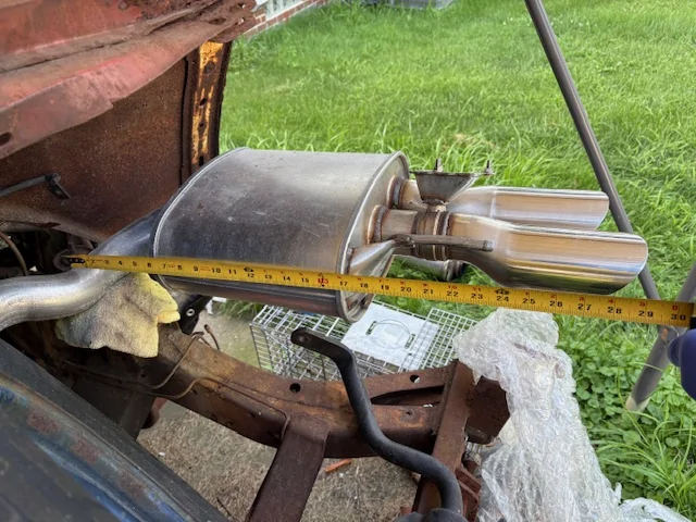

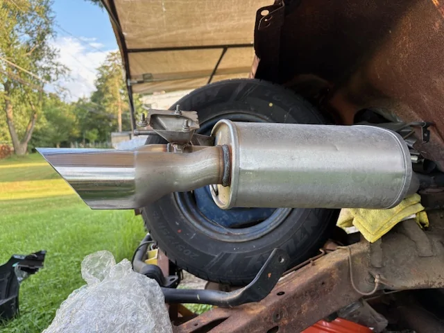

OEM GT active mufflers are 2.5" inlet aluminized steel with welded on tips. GT500/Mach 1 are similar but have significantly expanded and lowered tips. Aftermarket mufflers are either 409 stainless steel or 304 stainless steel and have several options for shapes and tips. Attached are some images of the OEM 2022 GT active right side muffler compared to a Corsa Extreme 304 stainless steel muffler with clamp on tips.
