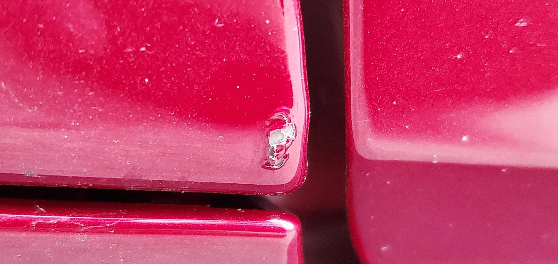

Hey guys any opinions on what I can do to fix this small rust bubble ?

Where is that occurring? If its on the hood Ford will replace it under warranty ('16 and up have a 5yr unlimited mileage panel corrosion warranty). Just had mine replaced - '16 GT w/PP

It's on the drivers side fender right towards the bottom, where the fender and driver door meet and there is a gap. What are the odds the fender will be replaced ?

Sure that's not regular debris damage? FWIW it might be the light, but it almost looks like there's a scrape/rub or something along the bottom part of that panel.

Doesn't look like rust. More like a paint bubble that broke open. Take it to the dealer and see what they are willing to do about it.

I thought it was damage from debris at first and i know the picture doesn't do it justice with all the dirt but it was a paint bubble that sorta popped open and that is the result.

That is clearly a paint blister and should be covered under the 5/60 Paint and Corrosion Warranty. Starting in 2016, “perforation of metal” is not necessary for aluminum body panel replacement (if damage warranties such a repair). It states it right in your 2016 Owners Manual.
If it were debris damage, there would not be an outward bubble - it would show as a divot with chipped clear/paint layers around the point of impact.
Here ya go, check this thread I had posted a while back and the pdf in it:
https://www.mustang6g.com/forums/th...table-vs-non-warrantable.121829/#post-2541196
