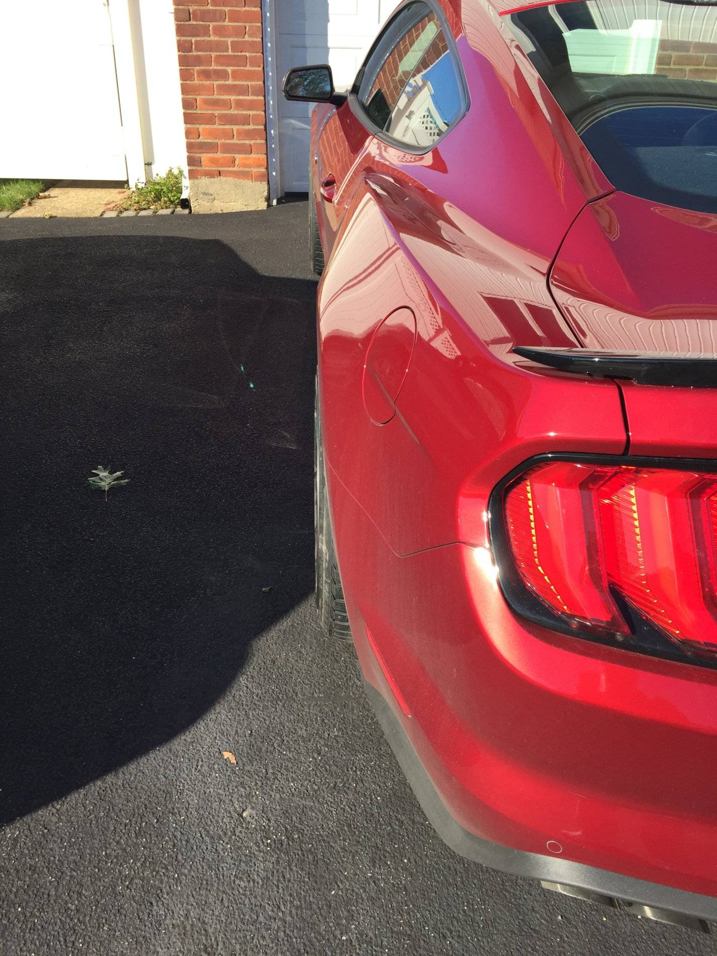

I just so happen to have a VMR V710 19 X 9.5 ET22 that I placed recently on the front and back of my GT PP2. your 19 x10.5 ET22 will stick out even further. Since these are an 1" narrower, add another 1/2" to the width you see here so they will be even further out.

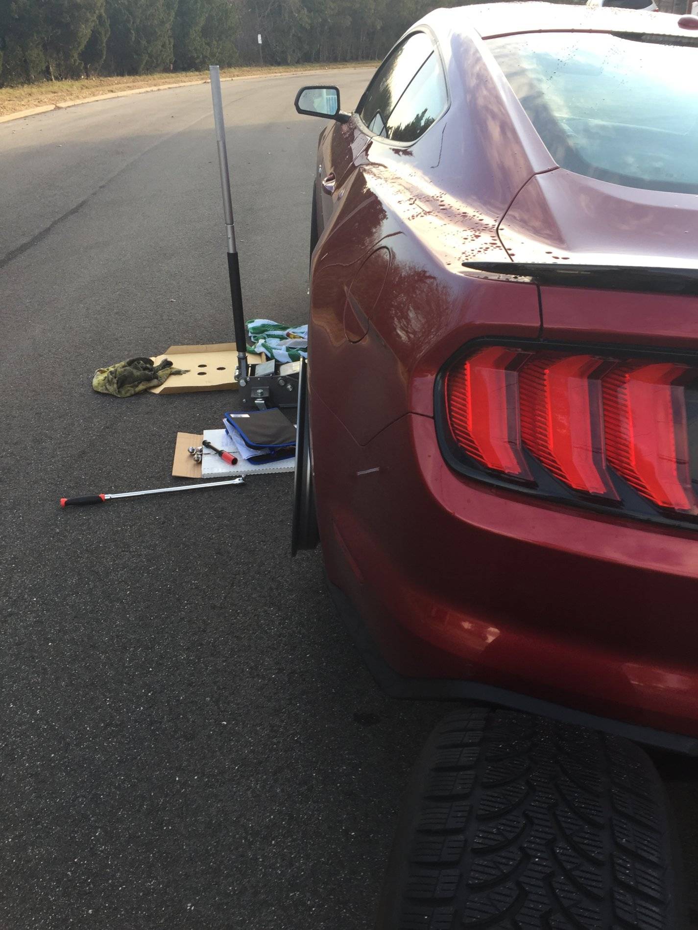

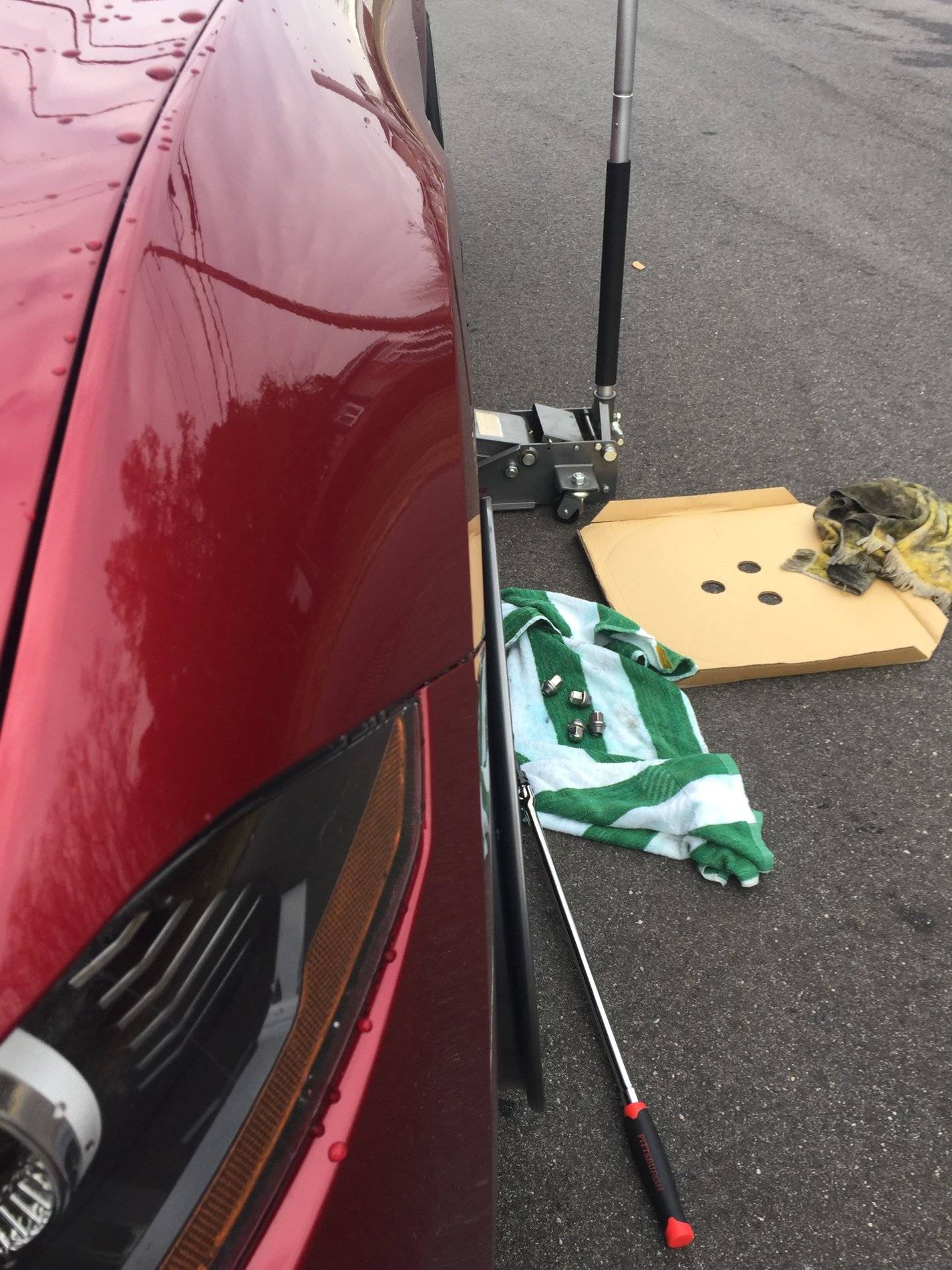

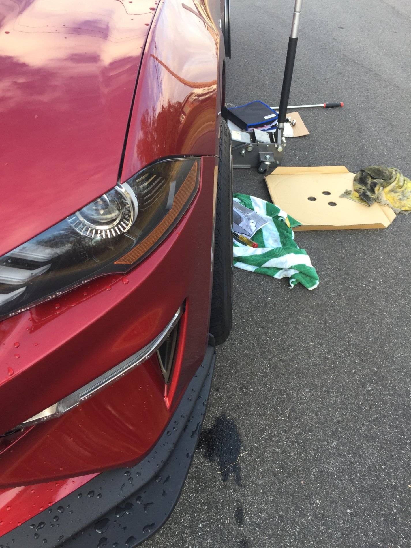

For me, I will be running 19x9.5ET22 in the fornt and 19x9.5ET45 in the back. I am waiting on the ET45 since the vendor and I were concerned about clearing the 15" Brembos. These wheels I am using for snow tires and was looking for a narrower setup than the stock PP2.
Stock PP2 has:
Fr: 19x10.5 ET24
Rr: 19x11 ET48
This is how they look
Front stock PP2 - 19 x 10.5 ET24
Rear Stock PP2 - 19 x 11 ET 48
