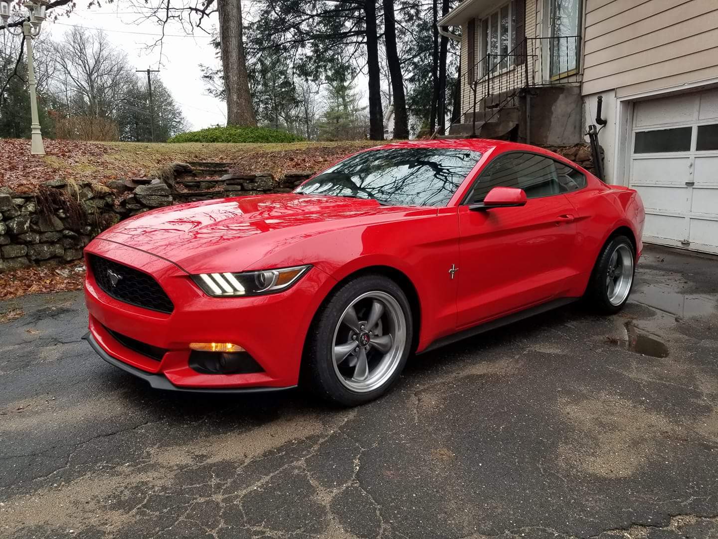

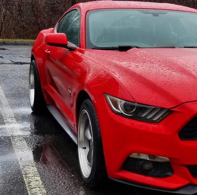

I was originally worried about how far they would stick out but it honestly doesn’t look bad from these pictures. A guy on the FB group installed these exact wheels with 275/35 and stock suspension with no issues. I want to go 275/40 with lowered suspension which has me worried about rubbing the outer lip of the quarter.

Well you're only lowered 0.5". You'll honestly probably be ok, but hard to know for sure. That's definitely too much poke for me, but obviously subjective. Excessive poke = sloppy modifying in my eyes, unless it's pure road course track car.

The poke to me doesn’t look to bad and I actually like the aggressive fit it has but the smaller tire diameter definitely is an issue with his setup. Way to much open space between the wheel and body... I just now have to decide if I want to take the gamble on this setup...

The rear is small in the pictures due to the 275/35 setup. That overall diameter is only 25.6”. I’m looking at getting 275/40s which will be 26.7” overall diameter. Stock wheel diameter is 27.3” on our 18x8 rims.
The point of discussion here is that the rear 18x10 wheel I am looking at has a very aggressive +22 offset meaning the wheel is sticking about 12mm or about .5” past the rear quarter lip just like in the pics above.
