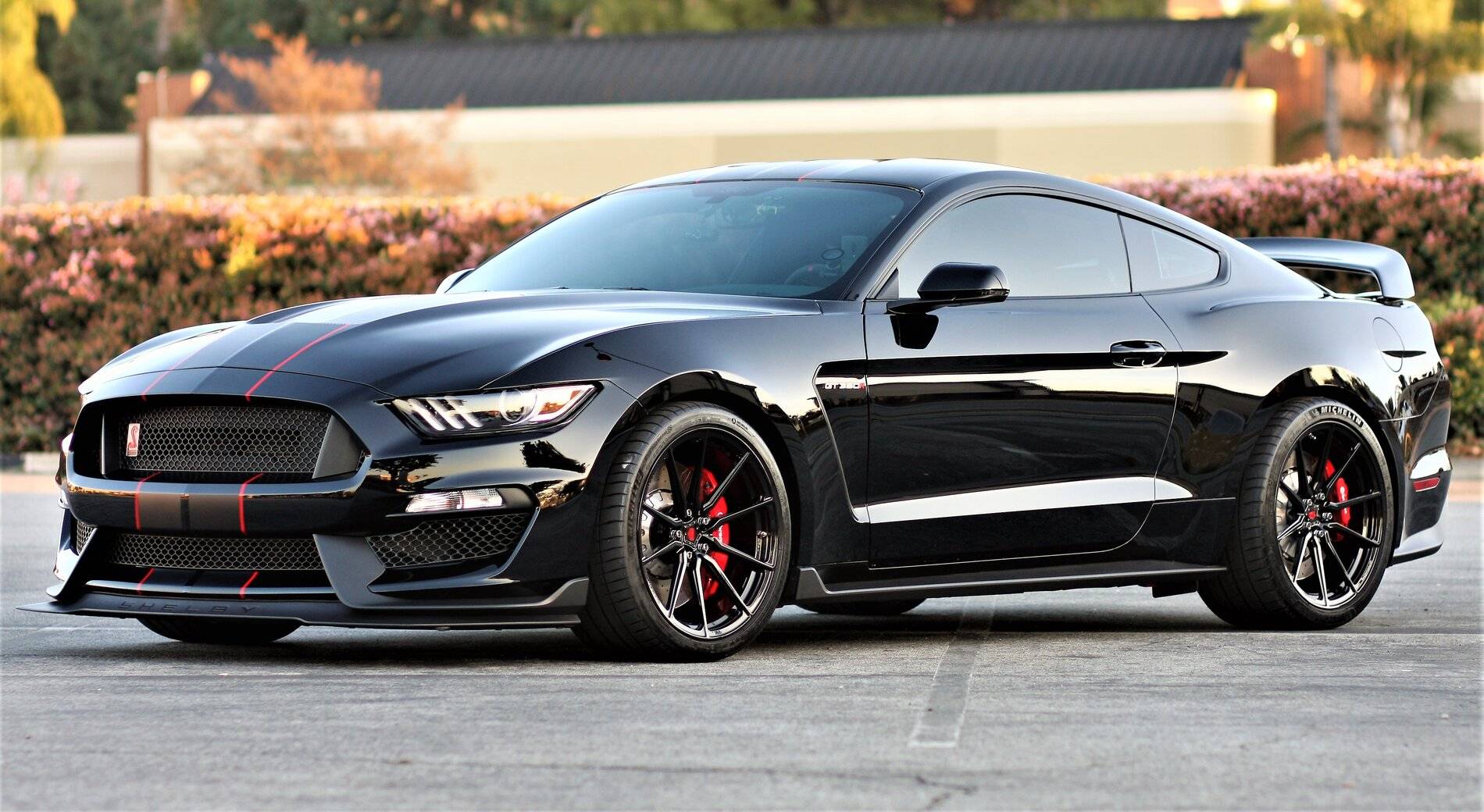

the primary reason to go to 20" is aesthetics. it lessens the gap bw the tire and fender, all things being equal. i think 20's look real good on the gt350...example of mine with the vossen M-X2:
and yes you can run front and rears size same wheels but you'll need spacers on the fronts, something like 20x11 ET52 all around using a 30mm spacer on the fronts (effectively ET22). but you cant just get any wheel in that size bc most wheels wont clear the calipers on the gt350, hence you got to find a wheel that works with our cars. if you want lower cost, check out P51s or the SVE R350 or the SVE SP2 wheels.
basically it can work you just have to figure out what wheels you want and if they'll clear the calipers.

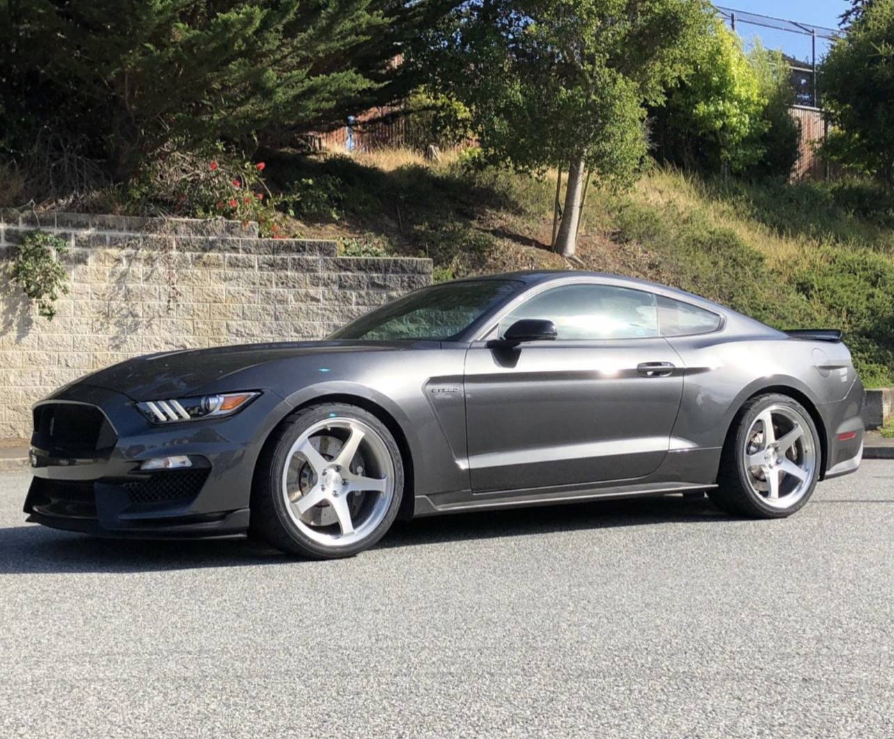

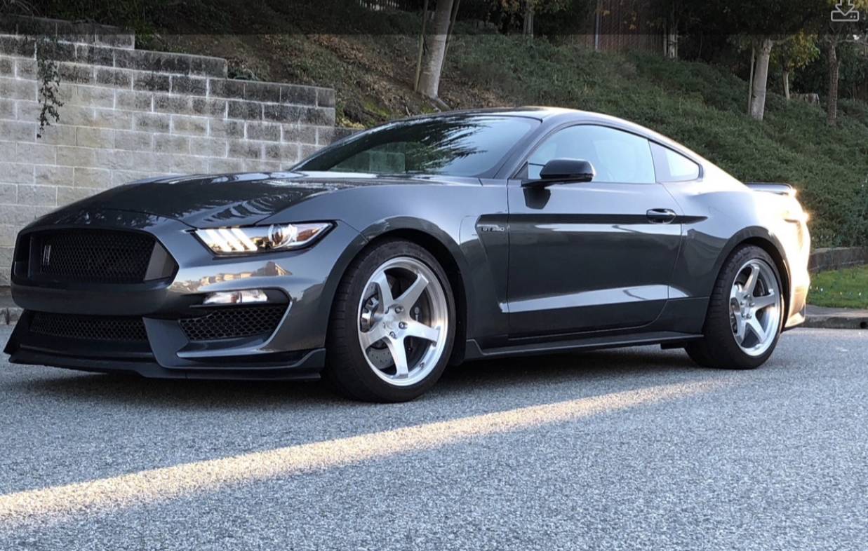

This is right on. 20’s do I think look better on an S550. I made the mistake of going 19” with my first set of wheels and within 6 months had another set in order in 20”. I spec’d specific offset rims for f/r but do get why running the same f/r works out for some people. Do keep in mind that you will very likely need longer studs in front if you choose the spacer route. Good luck, there are many great choices.
