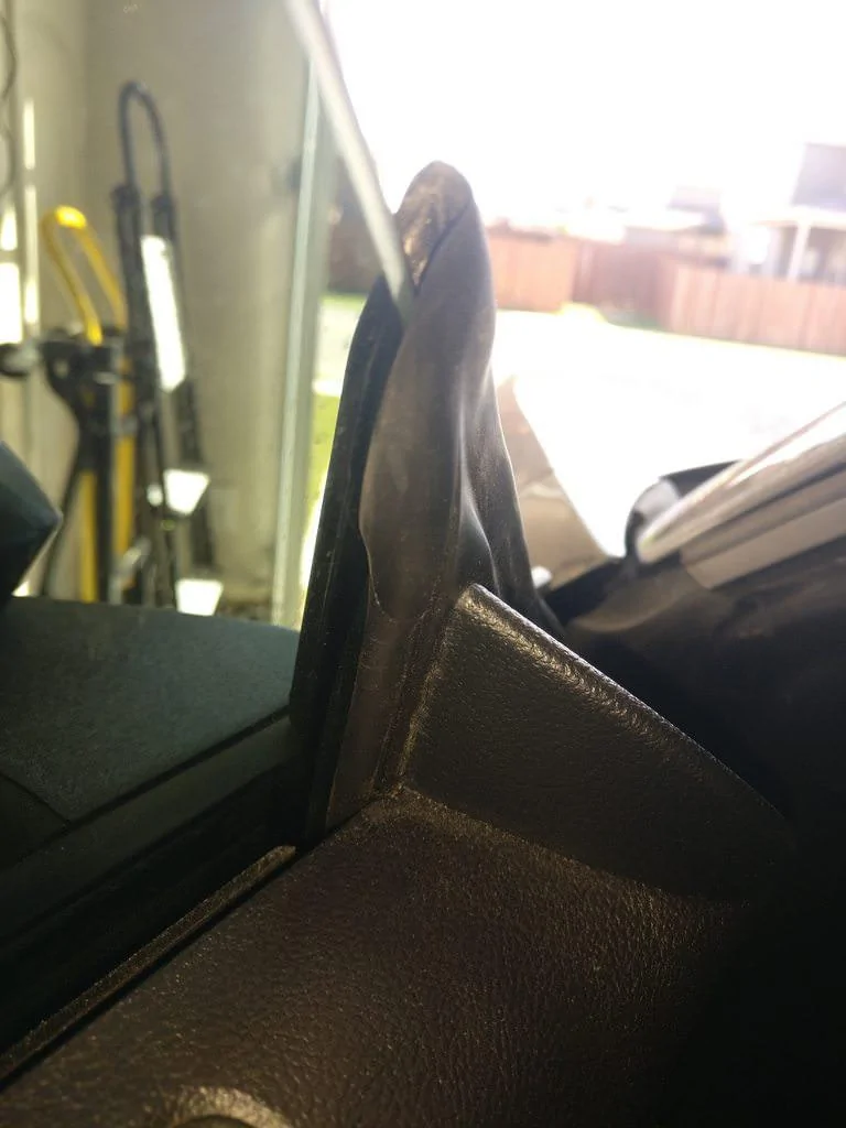

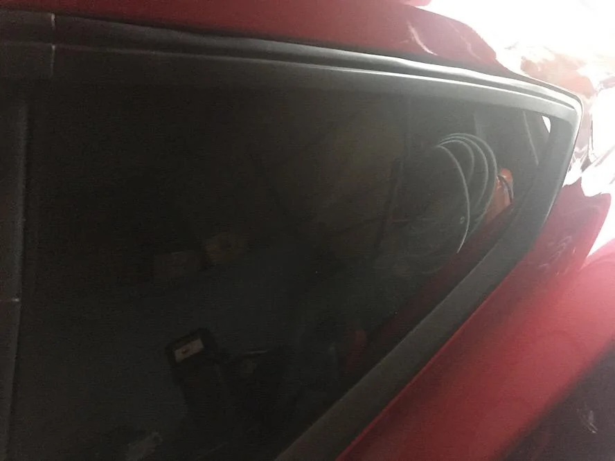

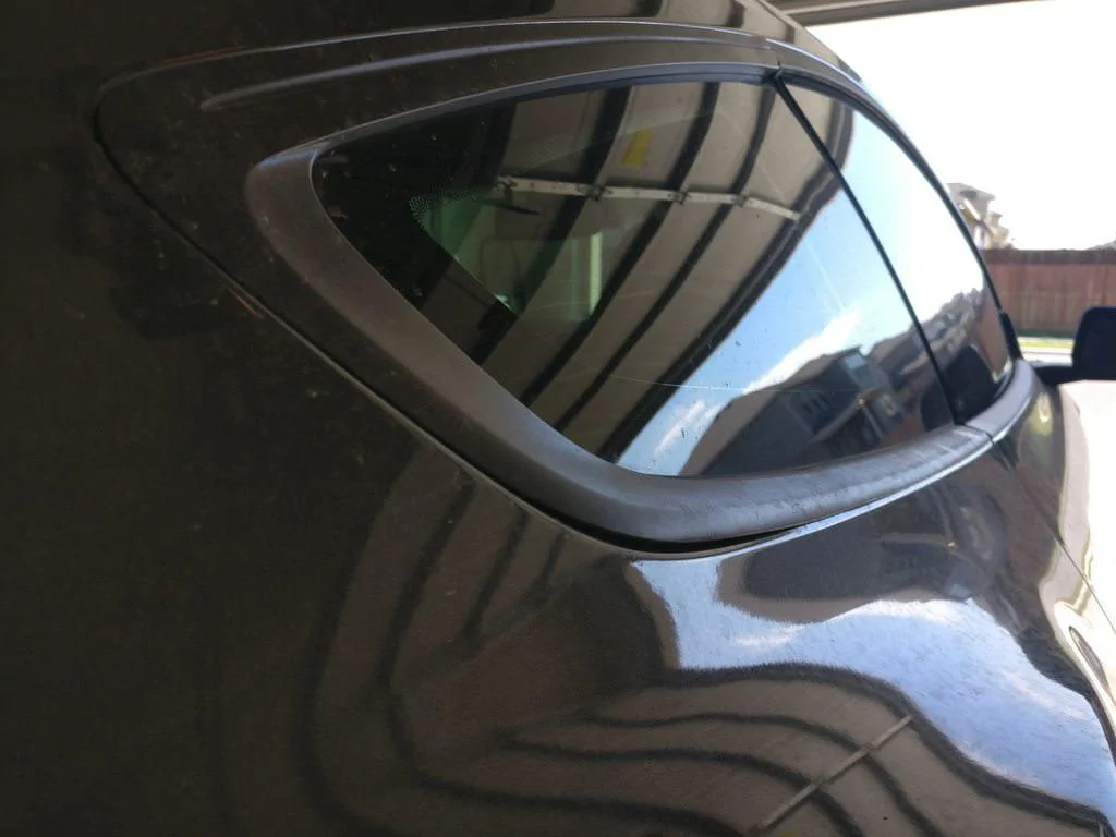

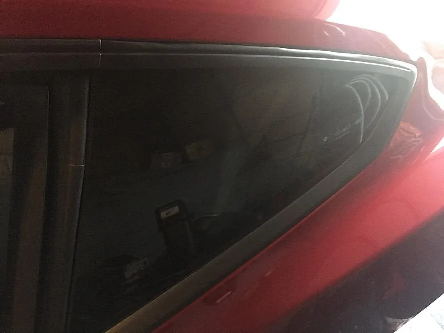

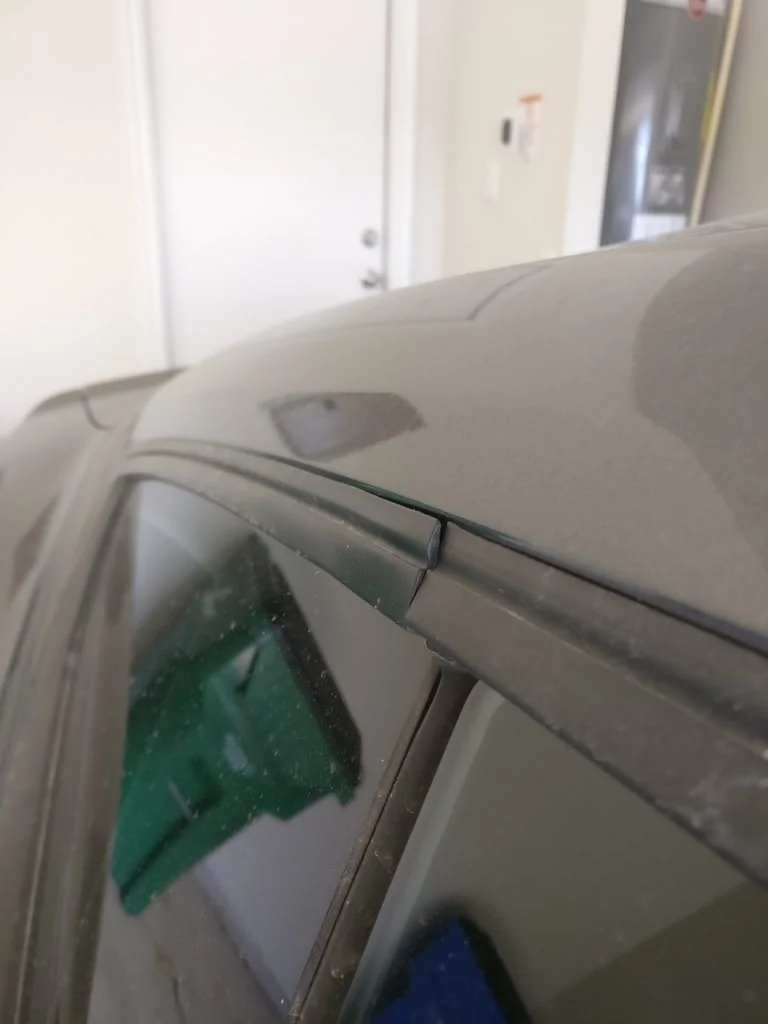

Anyone else having this issue? The rubber on the rear quarter windows are slightly peeling and the rubber by driver side mirror is folded in when the windows are rolled up.

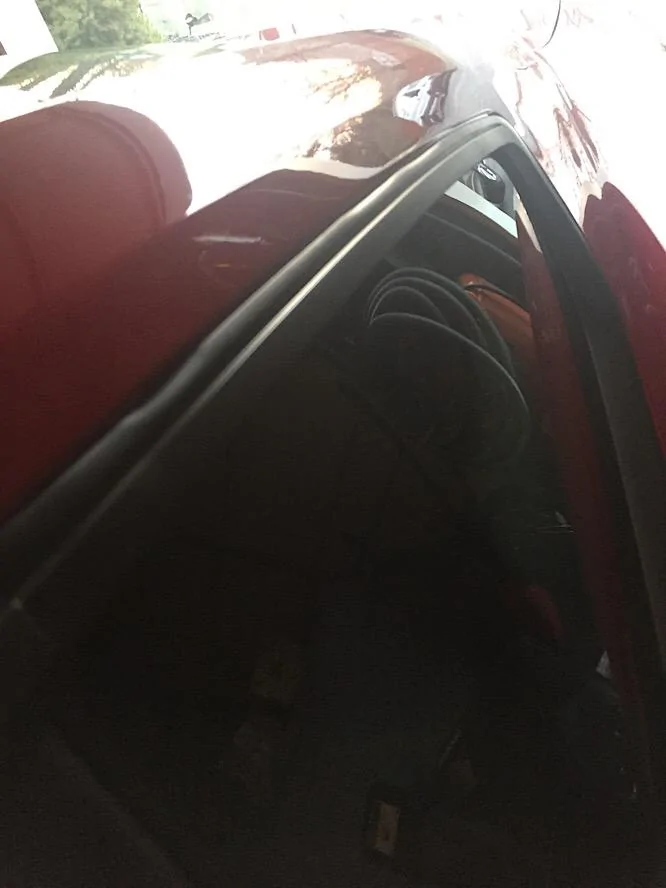

This was my driver side 1/4 glass on my prior 2016, before replacement of the glass. You can see how the black surround was all rippled and curling under at the top where it meets the roof line.
