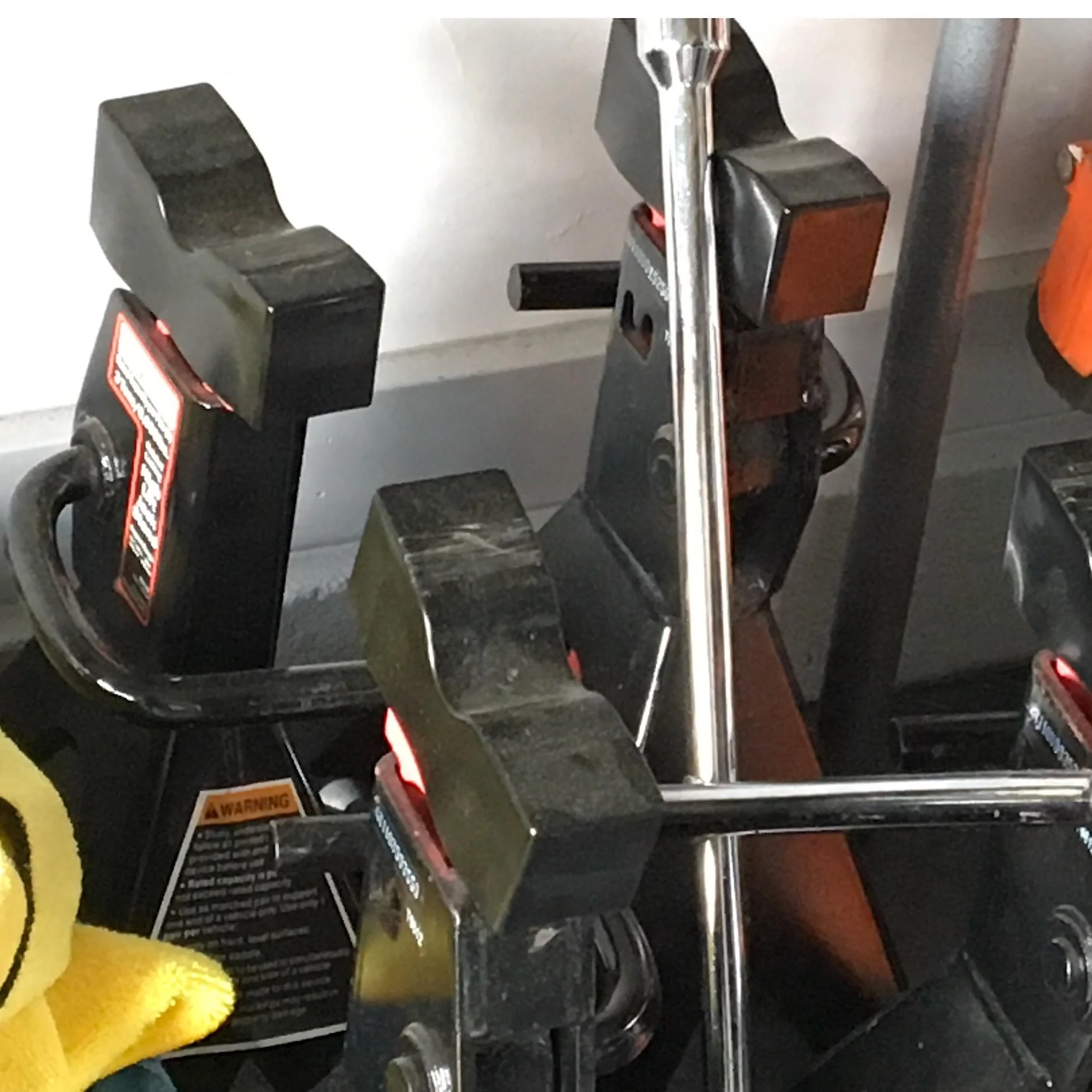

I installed Steeda's jacking rails on my car immediately after driving it home. They've been great! However, they've only ever touched a rubber hockey puck that I set on my jack and then the Ford service center's lift.
A few days ago I pulled the trigger on a set of axle backs that will be here Thursday. However, my jack stands have metal tips and I don't want them to scratch the jacking rails.
Do rubber tips exist that I can slide over the metal of my current stands?
Is there some other way to pad them effectively so the metal doesn't touch the jacking rails? I was thinking maybe a few layers of gorilla tape or something like that.
Thoughts?
Thanks! :)

You can use some microfiber towels folded in half.

Las year I bought a new pair of jackstands at Harbor Freight. They also had rubber pads for about 15.00 for two. I use those.

Go to you local Home Depot (or similar), buy a 1' section of 3/4 i.d. rubber hose, split it length-wise end-to-end, then cut it into sections as wide as the contact patches of your jack-stands.
Place the rubber hose sections on your jack-stands and viola, you have rubber pads to keep from scratching your jacking rails.

I put a couple layers of THICK Duct Tape on them and my jack, works like a charm

So I tried putting the ramps behind the wheels just to make sure it'd be safe to back up on them. They literally cleared the rear bumper cover and exhaust tip by a few millimeters. Once I get in the car I'll be scraping for sure.
Looks like it'll be several layers of gorilla tape on the jack stand tips.
Thanks for the suggestion though.

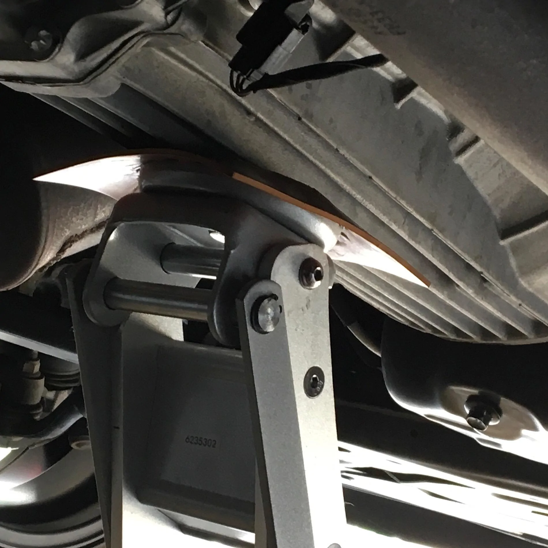

Cobra Jet
Feb 12, 2015
771
17,574
20,001
I use the rubber gasket material from Lowe’s in the plumbing dept.
:eyebulge:
Are you really jacking the car up by the transmission???
