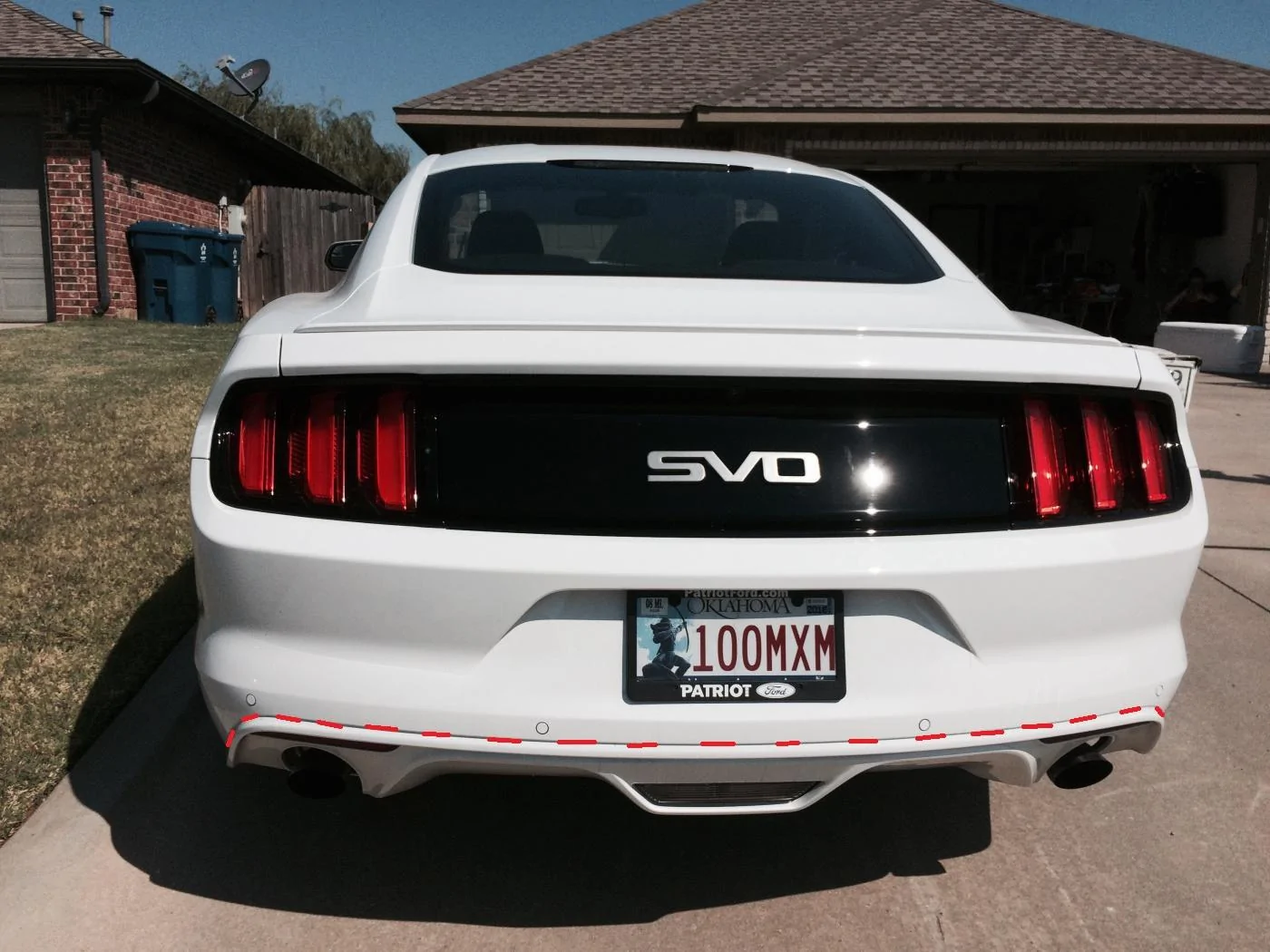

I've checked and double checked both my premium and base bumper as well as my Roush valance.
Fitting will require two things:
a)Trimming the base bumper at the molded seam all the way across the bumper.
b) Using epoxy to mount L-brackets for the Roush extensions. I recommend thin bar-stock AL hand bent (easy) and drilled for exact fit.
You will also need: 6 - M6 speednuts and bolts.
I will try to get some pics up of the cut line, I didn't make the brackets as I used a premium bumper but it is really obvious what to do when you get in there.
