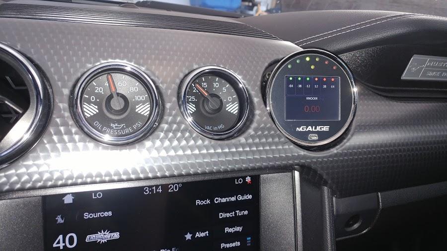

Did you find it easy to use the Ngauge? Did you have to do any data logging? Was there Base tune spot on?
NIL8GM
Aug 22, 2017
Ottawa
2017 GT
Ngauge is very easy to use. I like the fact that I can actually use it as a gauge. I have it mounted in one of the vents. Their intial tune was spot on. I watch some parameters for my own curiosity but data logging was not a requirement from them like some others.
I guess it's always your choice, but I would never consider putting a custom tune in my car without datalogging. I use Livelink, good tool. For tuning devices I believe you can choose between the ngauge or SCT4.
Their initial tune had some issues, second was very close minus a couple of shifting tweaks I wanted, third was very good. I'm happy with the end product as well.
