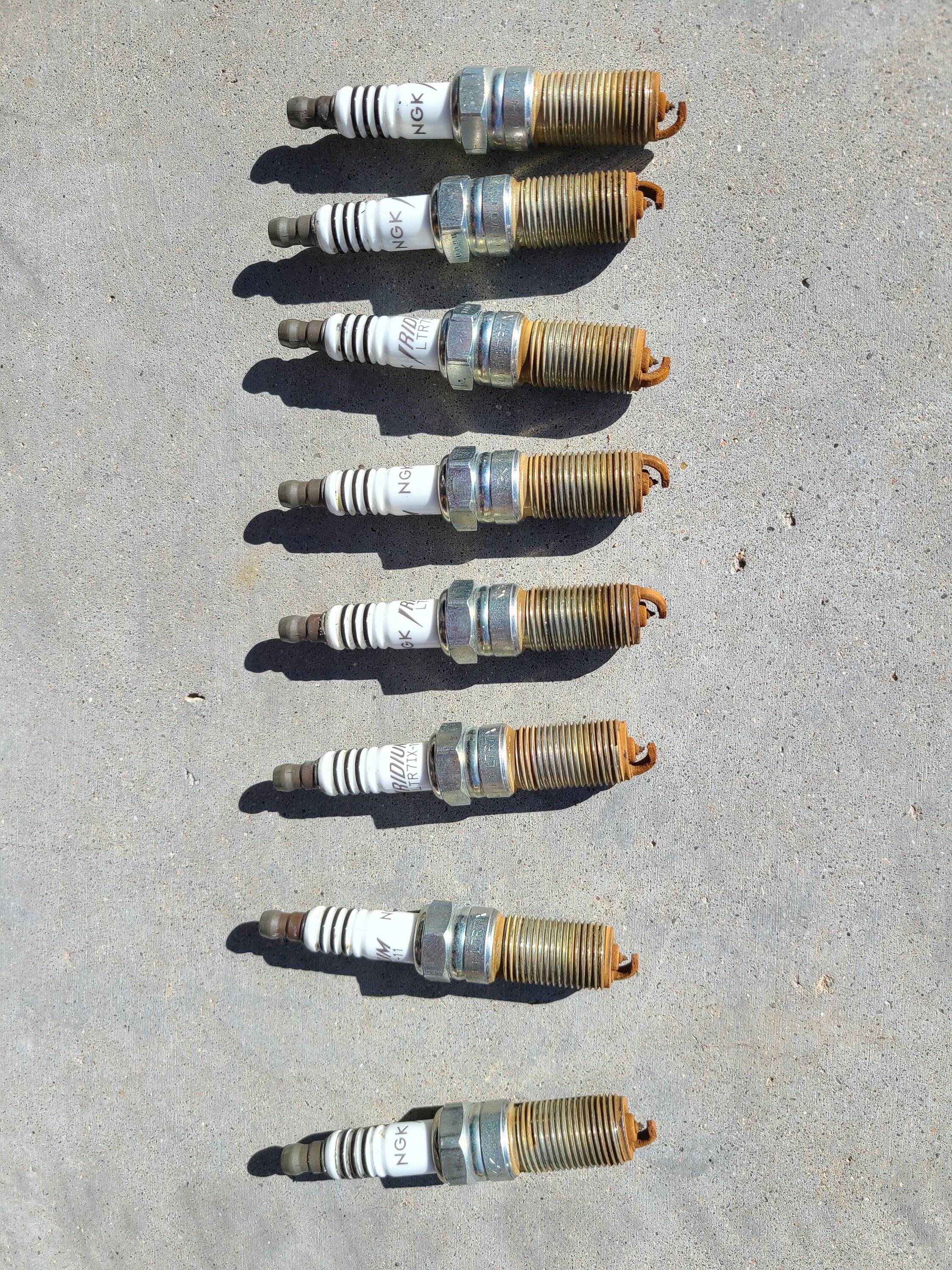

Not sure what your issue is but I doubt it's from running few tanks of boostane. I'm also on az shitty gas so I've been running 8-16oz of boostane in every tank for the last year and a half (30k miles) with no issues. Well other than having to change or clean my spark plugs every 10k miles. This is what they look like at 10k.
Mine were definitely orange/ red but not that bad. I was only using about 3oz per fill-up of the professional just to put me at about 93-95 octane.
