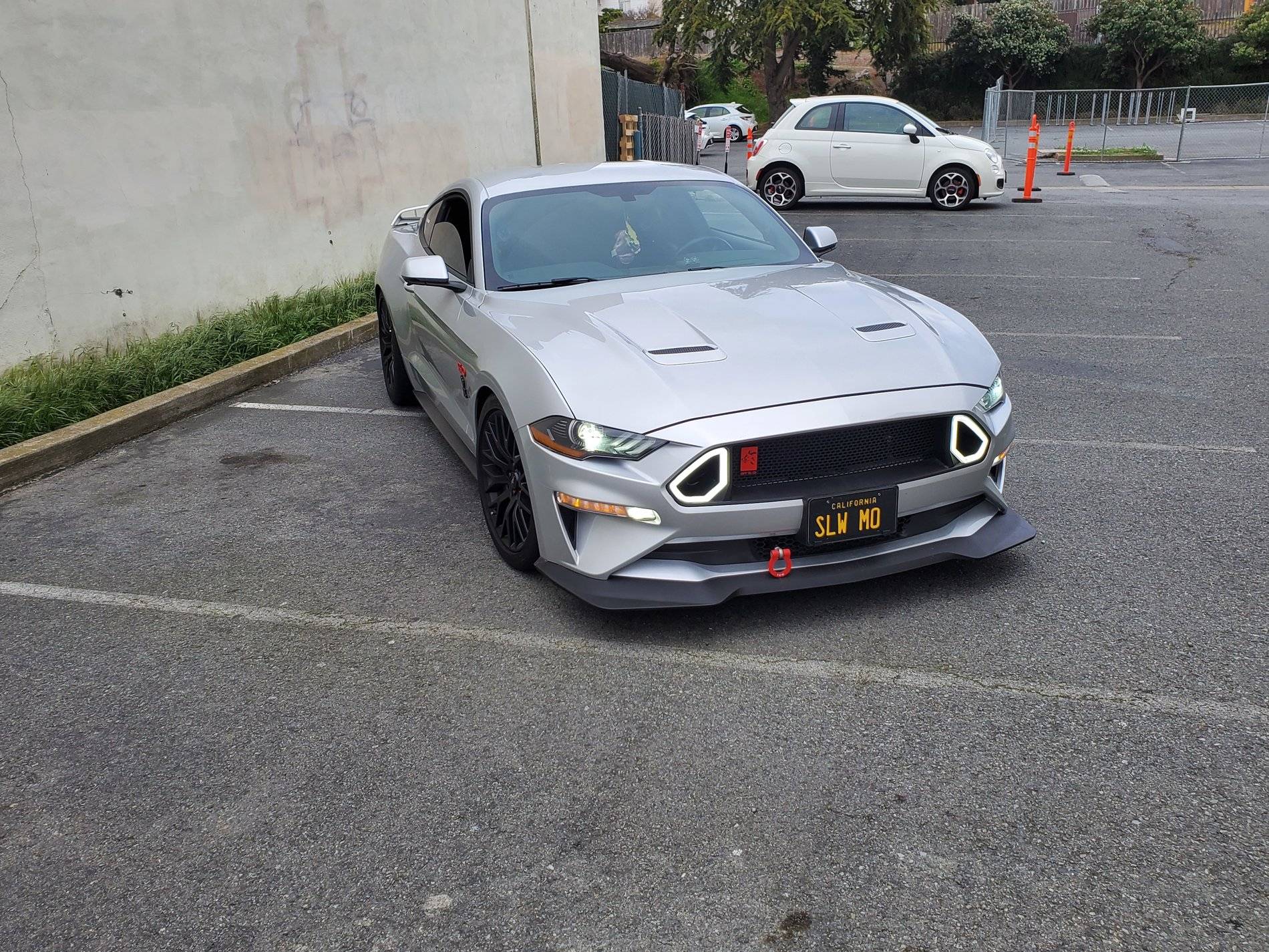

Roush Phase 1 Kit looking to tune!!!
IMMRSCOOBY
Apr 13, 2020
California
James
2018 mustang gt
Lund is who I use and have nothing but good things to say. Still working on a revision now, but it’s feeling good! I also have a Roush car and use the Ngauge.
Lund told me they won't do tune on my phase one roush supercharger
