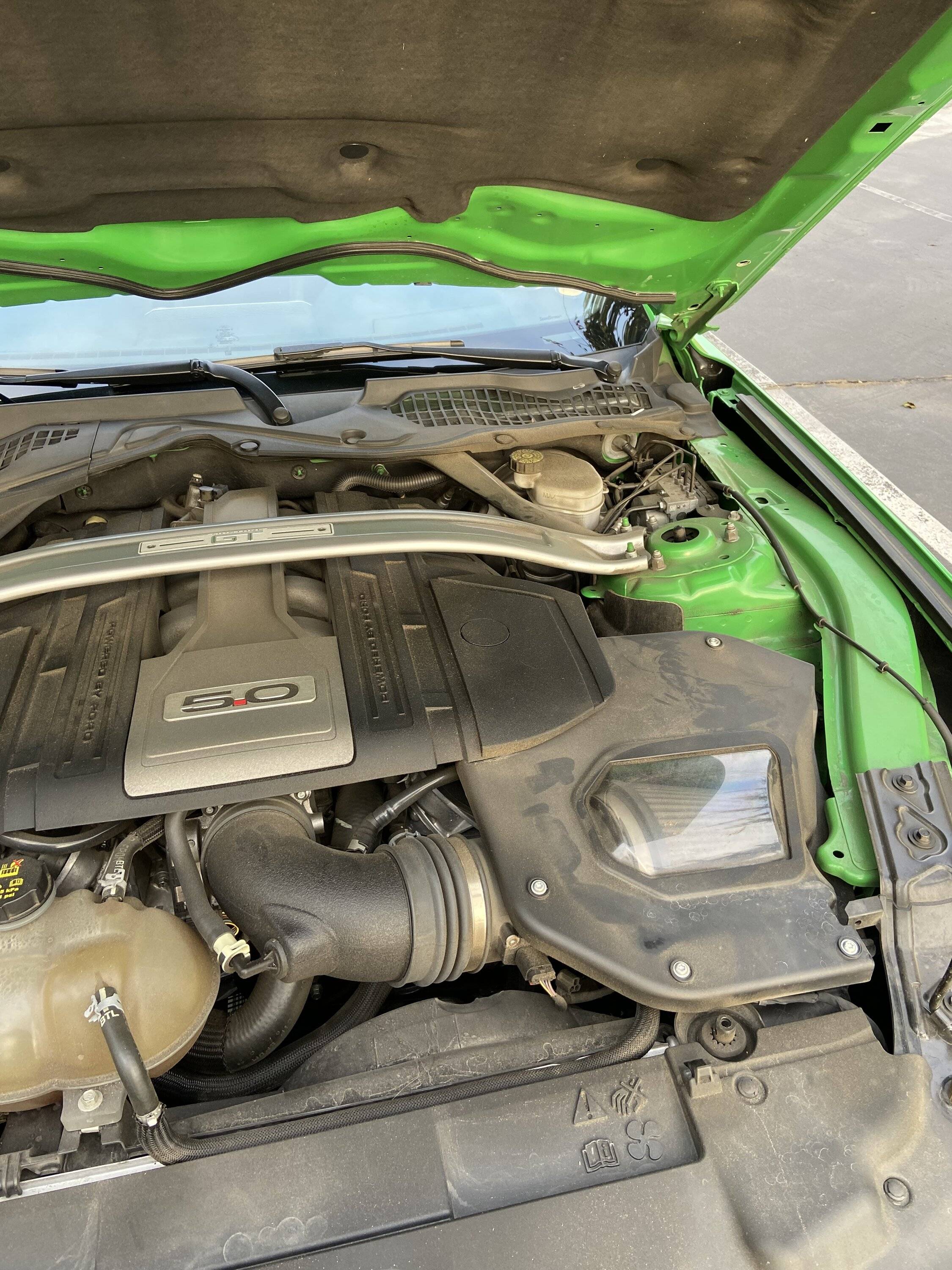

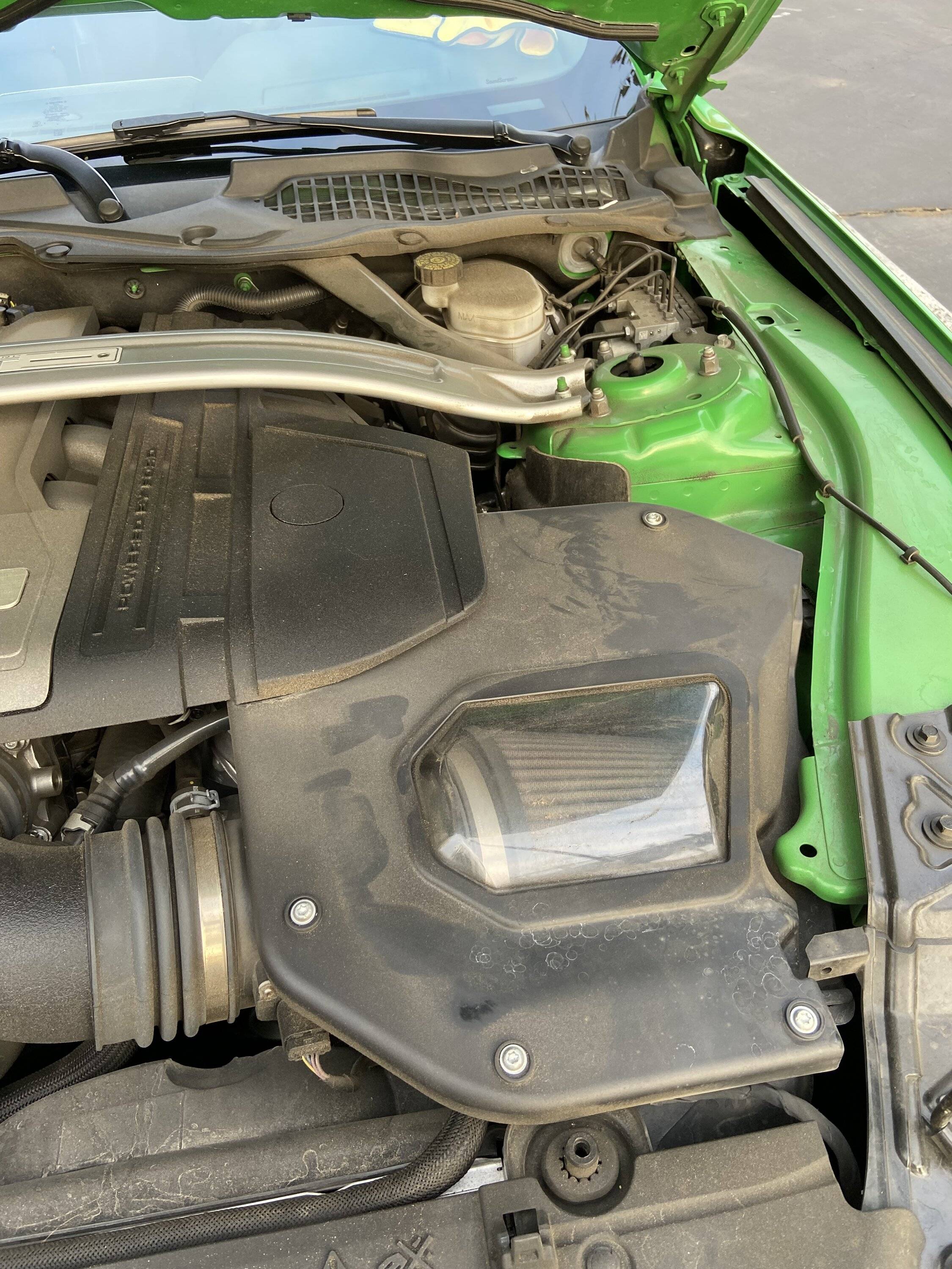

LoL. Sounded like I was going to do the intake tomorrow morning. I meant take the pictures tomorrow morning. Mines been on since I bought the car. I had some help from some buddies and this is what we did. It’s just laying on top to be honest. I didn’t want to cut it so we did this. Now that I’ve looked at it as well as the engine bay I need to clean this thing really bad. My filter is overdue to be cleaned too.

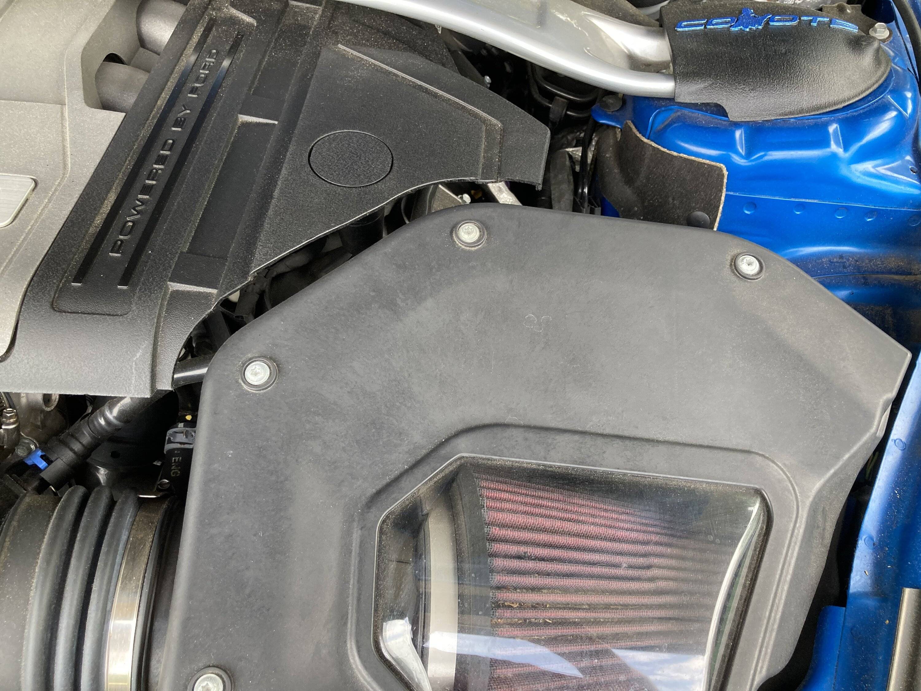

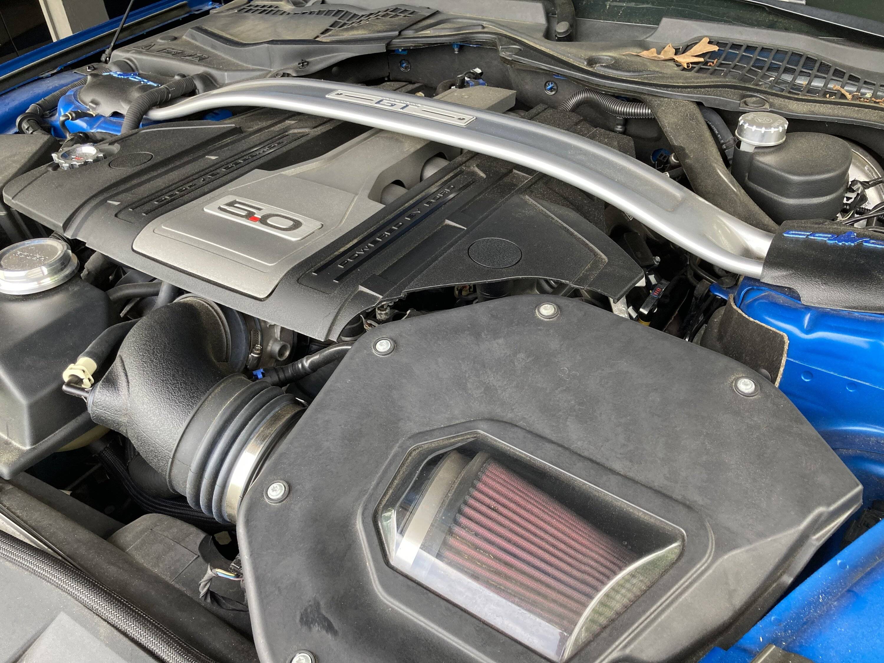

Mine was installed by the previous owner. Totally unremarkable to me until your post. I looked at it, and thought it appeared normal. Here's how it looks, in case you want to consider just cutting around it.

It looks clean, it’s crowded but clean. If I was going to keep my plastics on I’d rather this then cutting them up. But that would be my preference. Now on another note, what are ya gonna do with all that dirt? Cultivate it or use it for cattle grazing?😂

I know right? I have let it get too far. There is a place near me where I can have them do it and then I will just have to be more proactive on keeping it up.
