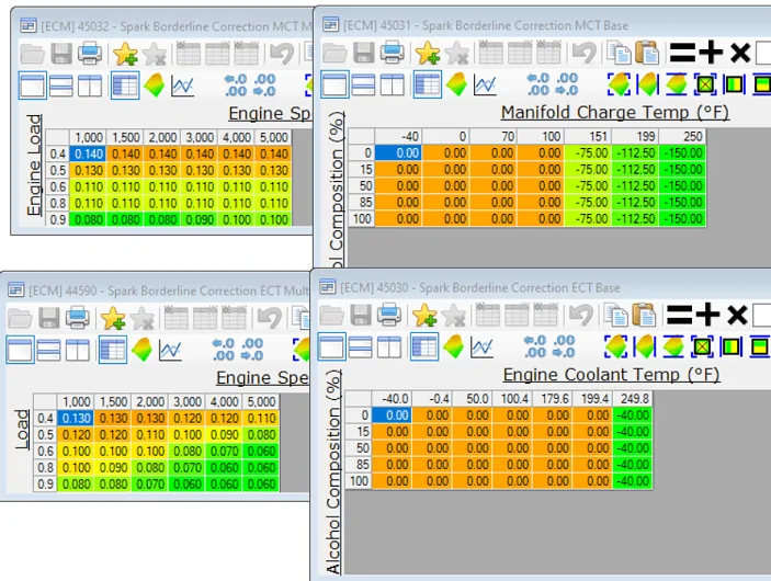

You got me interested, so I dug around and found a supposed 2018 Roush tune on the internet. Here is a screenshot of the tables related to IAT2 (labeled as MCT), and also engine coolant temp timing retard. The way these tables work is that the ECU looks up the load and rpm and then multiplies the modifier there with the base value in the other table with MCT or ECT vs Fuel alcohol composition. I guess that is for flex fuel vehicles, but flex fuel is disabled in this tune. Example for MCT would be if you are at 5000rpm, 151 F, and WOT, the multiplier would be 0.1, and base would be -75, so total timing retard would be (0.1)*(-75) = -7.5 degrees
For IAT2/MCT, they start pulling timing at only 100 F. As a comparison, the Whipple tune for my car doesn't pull any timing until 150 F.

That’s interesting but That’s probably 2 cals ago. I’d be interested to see something for 2019. Too many people with recent Roush kit purchase are happy for there to have not been changes versus the scores of people who were very unhappy on the earlier 18 kits
I’m still waiting for an updated calibration. Put a call into roush less than a week ago.
The technician even mentioned about an update for “heat soak improvements”. (A10 only) He said to check back in October.
Perhaps the autos have priority over the manual trans cars due to the stick shifts being the minority.

Actually I believe how the tables work you’re car would slowly start to pull timing as soon as it went over 100. It interpolates between 100 and 151. So the correction at 125 would roughly be half of the -75
