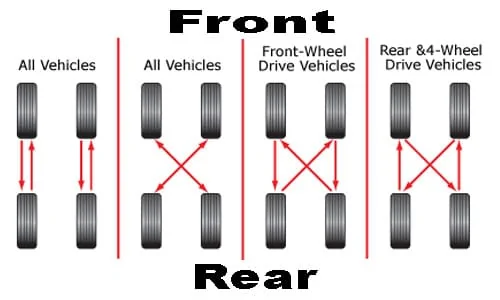

How do you go about it on your Mustang :shrug::headbang: :ford:
Going L-R will call it:
All Vehicles - All Vehicles 2 - Front Wheel Drive Vehicles - Rear & 4 Wheeel Drive Vehicles

Staggered set up would be the PP option, wider in the rear!

Staggered isn't show in there and would be what a lot of guys here have, it is where you can only move side to side (and the tires have to be symmetrical).
Those first two are def not how they taught us to rotate tires in my auto mechanics class...
I don't understand the last two. Why would that matter at all for what drivetrain you have? Either way you're rotating tires all around after multiple rotations.
Square set up ftw here; it's why I put 285's in the back as well as the front!
