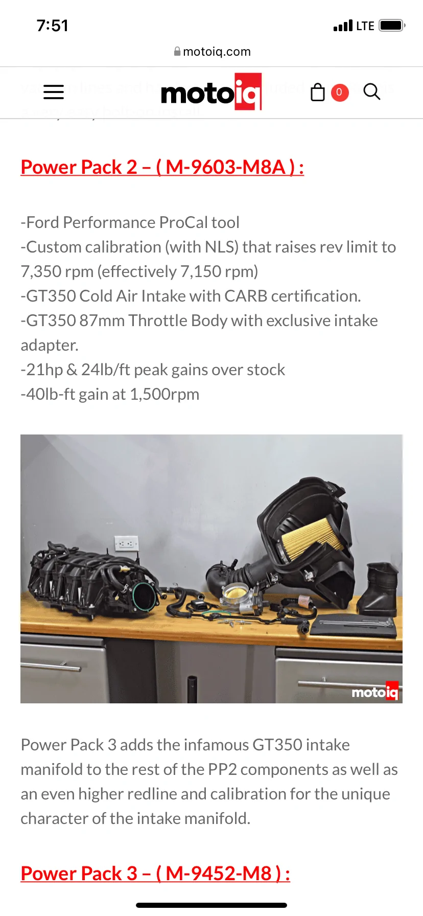

You made 425 to the wheel with essentially the Ford Performance Power Pack 2 and catted headers on 91 or 93 I’m assuming? Sounds very generous to me. Do you know if that’s SAE or STD dyno numbers? I’ve been reading this stuff for DAAAAAAYYYSS like obsessive and I’ve NEVER seen those kind of numbers SAE on pump gas with that setup you have. Man Ford doesn’t even advertise that much gain in Hp…. 21 HP gain is what they say. So I think maybe you have a unique set up.
i believe I have what’s generally consistent for FBO numbers from my research. 455 on E85 is 535 hp to the crank with a 15% drivetrain loss.

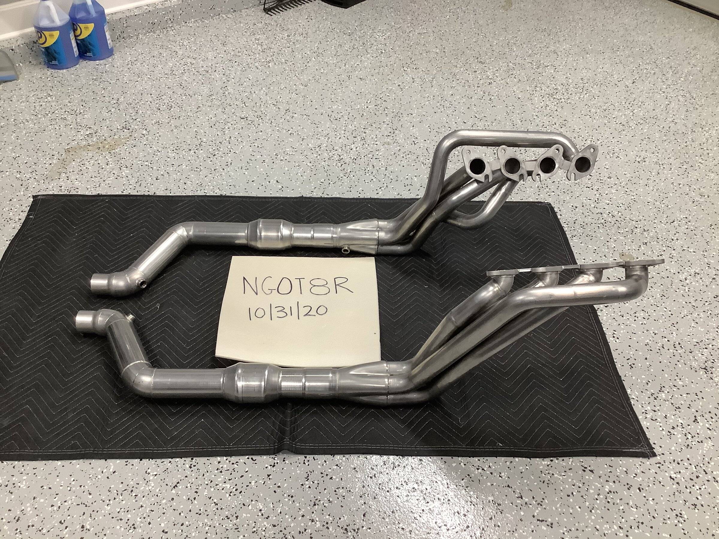

Does anyone have a recommendation on how to install rear O2 simulators or MIL eliminators or O2 spacers or foulers whatever the hell they’re called there’s so many different terms. I have CEL on bc I have catless headers. Does it require drilling into the headers or how does this work? Would something like this work?
http://www.bigdaddiesgarage.com/mini-cat-cel-fix.html
You should have O2 bungs in the pipe. They may have plugs in them right now. If so, you would remove those plugs, screw in the spacers and then screw the O2 sensors into the spacers and plug them into the factory O2 sensor harnesses.
I don’t think mine came with rear bungs. Tuner said EPA won’t let him turn them off and he just ignores it on his mustang.
Oh okay, we’ll in that case, you’ll have to have an exhaust shop or a skilled welder drill holes in the mid pipe and weld in O2 bungs and then follow the information in my previous post. It’s been said that mounting the bungs/O2 sensors at a 45* angle (like in the pic below) will help them live longer on E85.
