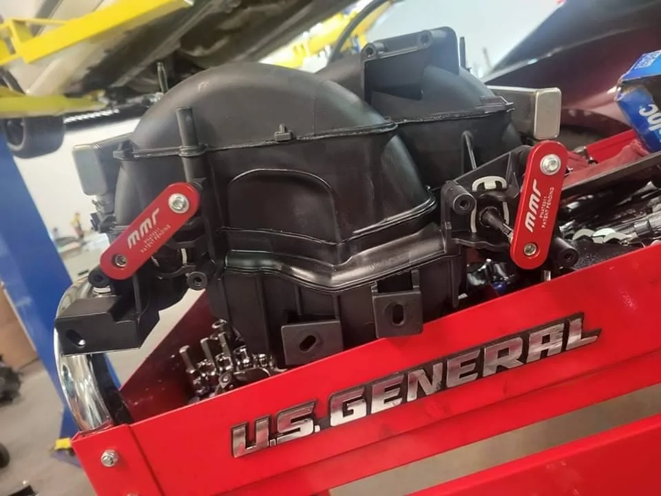

JLT, GT350 TB, 18 intake, 47 lb injectors, Texas Speed (catless) long tubes, Flowmaster X-pipe & cat-back (already installed). $2105 for labor, custom dyno tune 3 tunes (91, Flex, E85), fuel swap, IMRC lockouts, using my SCT device. Bama officially history.

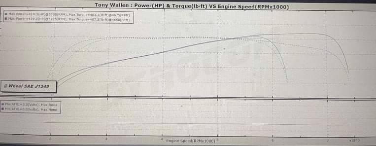

SAE dyno: 414 RWHP (91 gas) @ 5700 RPM; 439 RWHP (E85) @ 6725 RPM.
STD: 455 RWHP (E85)
This may sound aggressive but… if it’s 15% drivetrain loss…. 455 is 535 at the crank. Even 439 is 516 at the crank. Even if it’s only 12% loss… 439 is 499. So safe to say 500 Hp car now!?
Rev limiter 7800, I was advised to shift @ 7500 (good Lord help me)
Shoutout ā€œET Motorsportsā€ local shop in Broken Arrow, OK & ā€œOrtiz Performanceā€ for custom tuning. Overall great experience & recommend.

Hopefully I can get a refund with VMP IMRC harness it was $70, tuner said it’s crap.

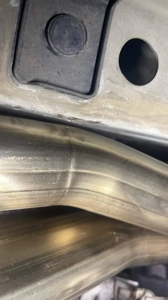

I’m not happy that expensive headers rubbed my frame & caused false knock, but they fixed that by creating clearance & denting it slightly with permission. I really hope this doesn’t reoccur later…. But the group seems great to work with. I didn’t know E85 would cause peak power at higher RPM. My father is picking the car up, I told the owner to leave it on E85, I want him to feel the 🌽 power (he had an 03 SVT cobra).

@Twall, you’ve done well with your combo. Everything sounds like it went smoothly, except for the header rub. How did the shop dent the primary to gain clearance from the frame rail? How much clearance is there now?
