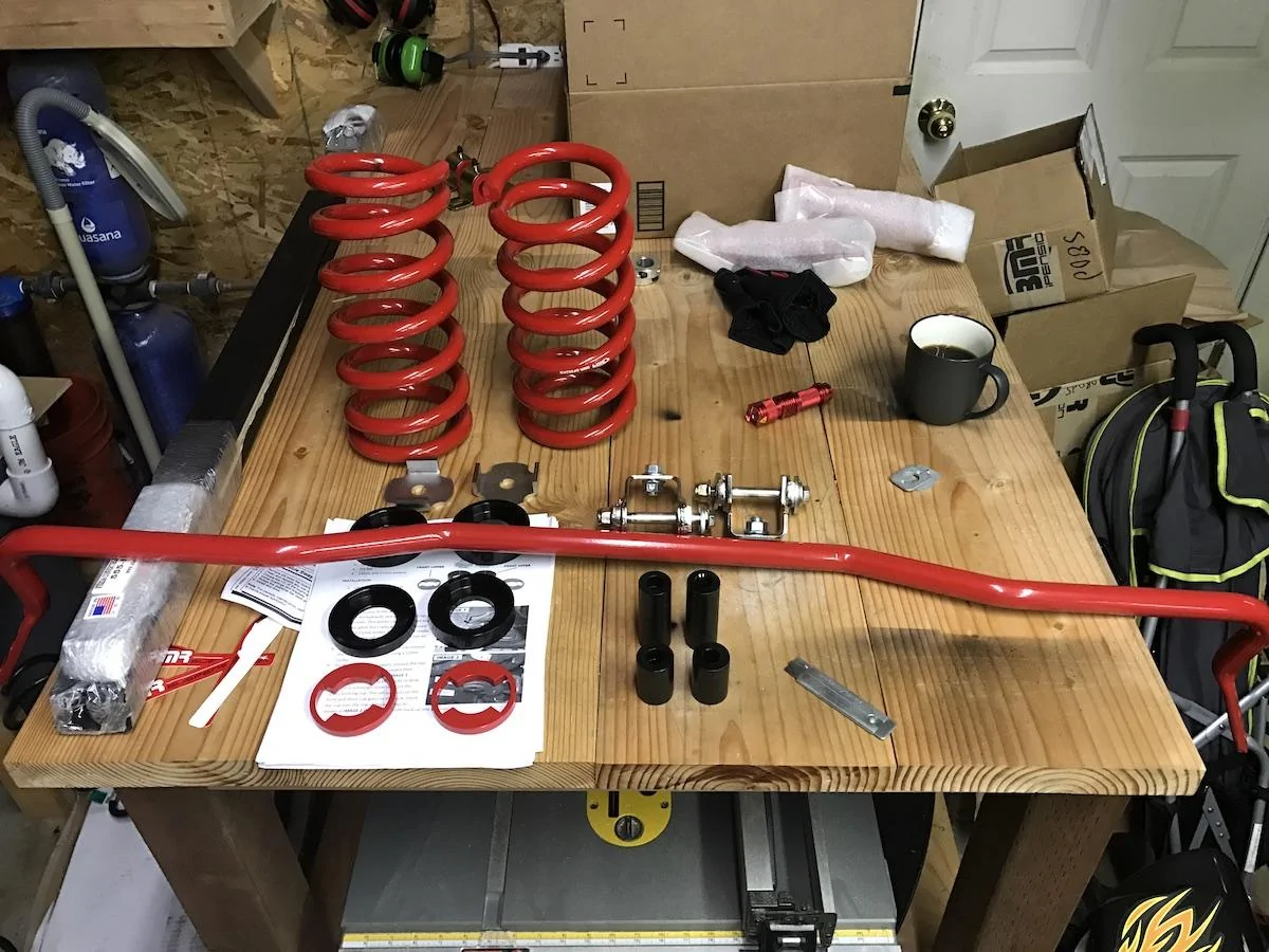

Here's all the stuff that went on the car this morning.

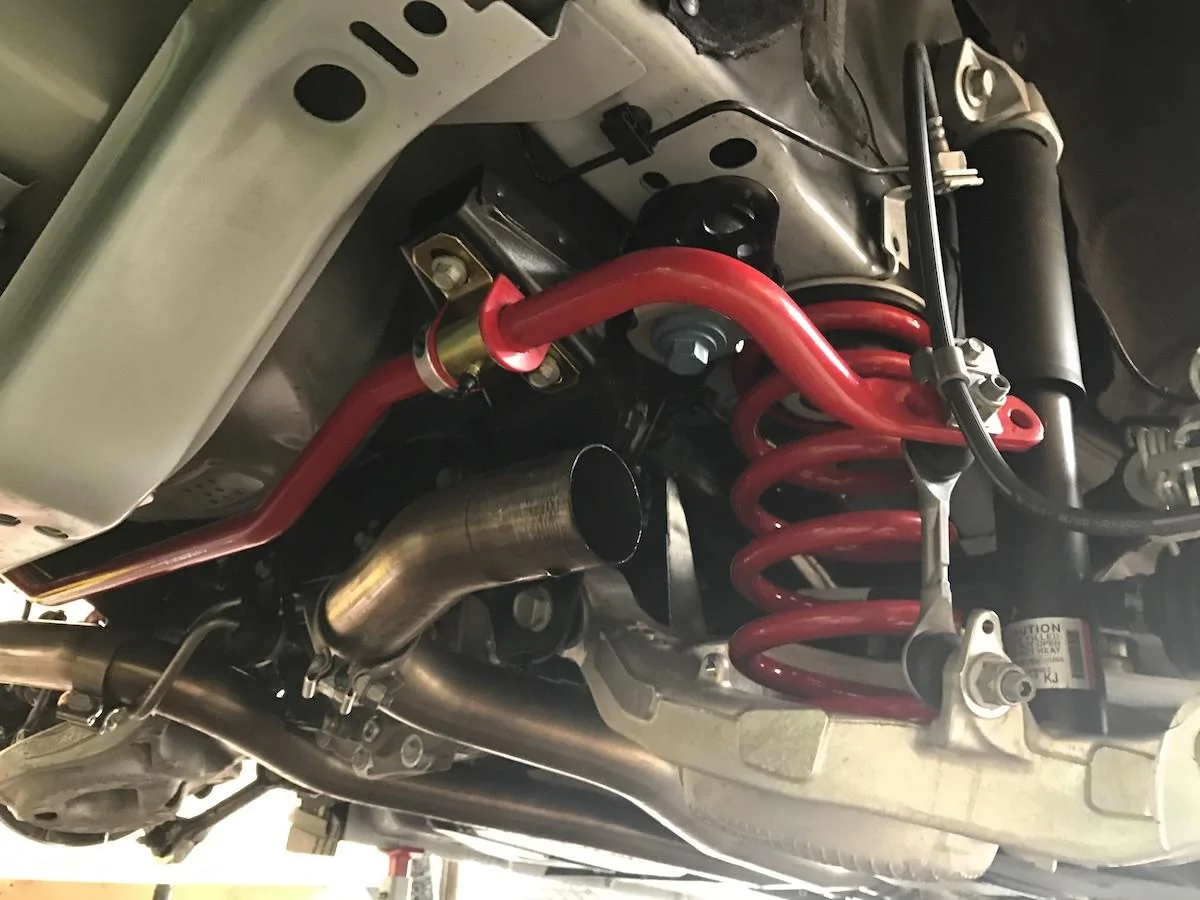

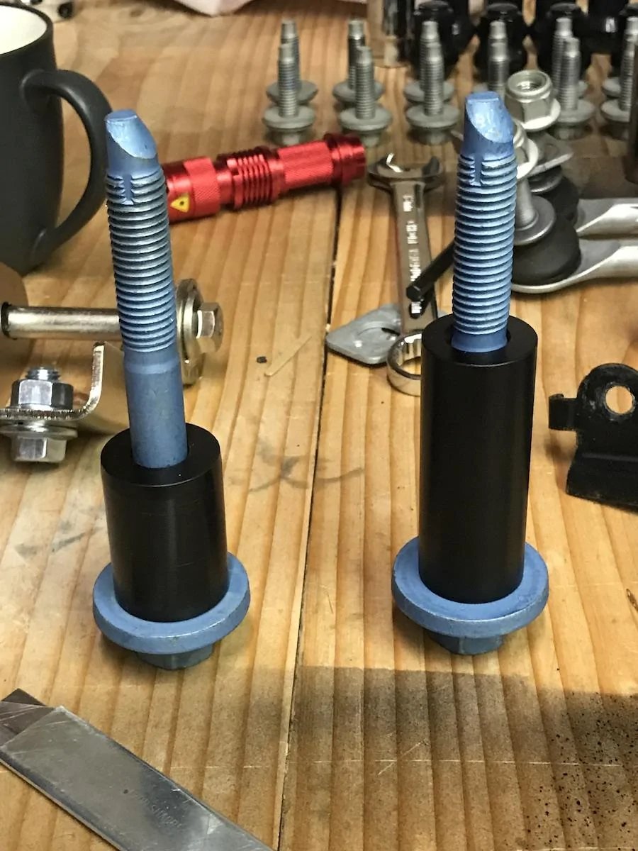

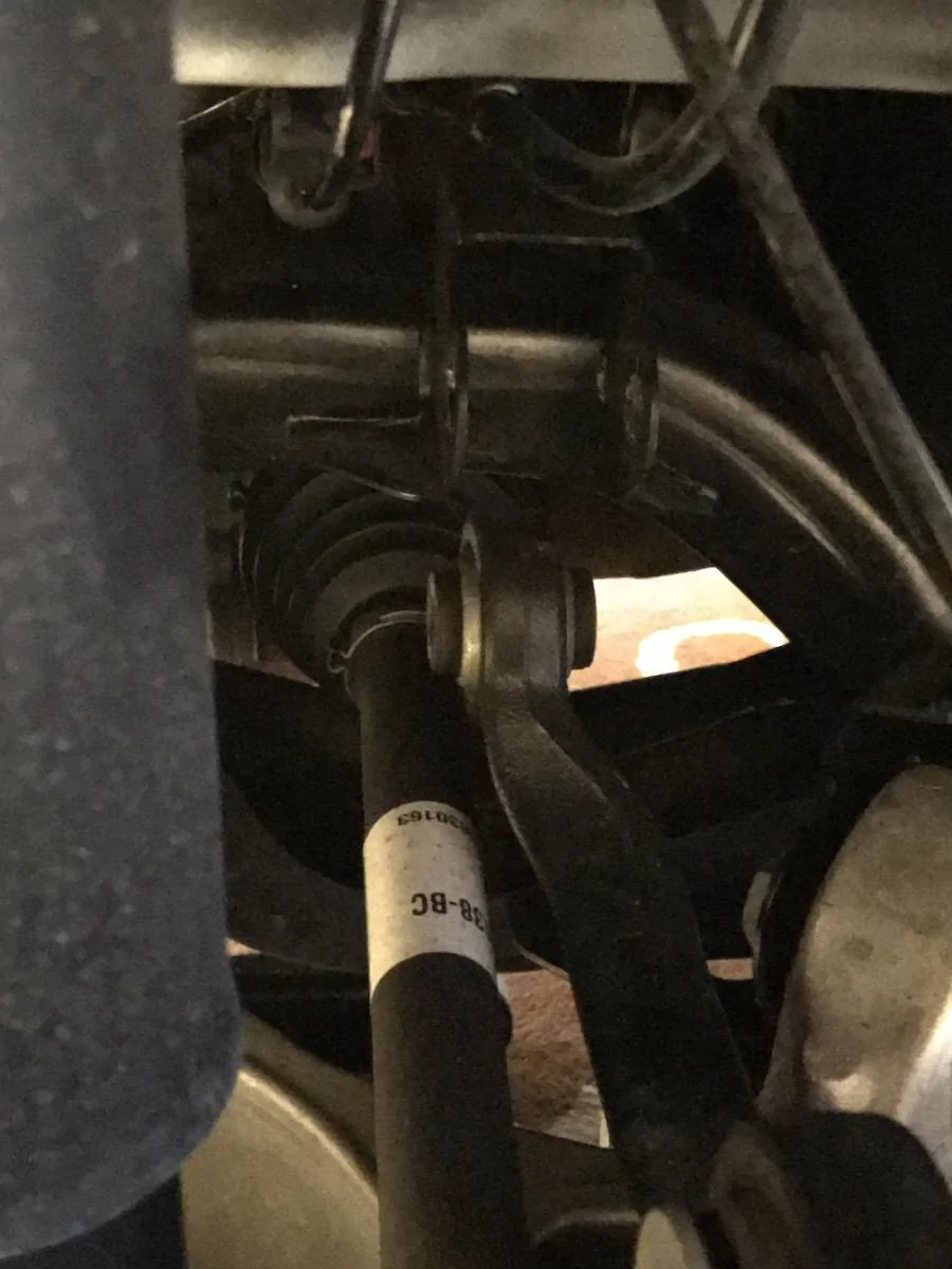

Subframe bolts out with Steeda subframe alignment sleeves in place. So, something I discovered: I should have gotten the sleeves for use without the BMR kit. Since I have a convertible, I didn't use the front support brackets, and now the front sleeves are too short. Hopefully I won't be able to hear these things rattling around in there while driving. Only time will tell!

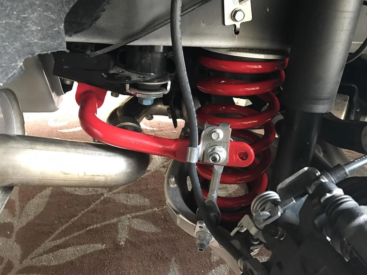

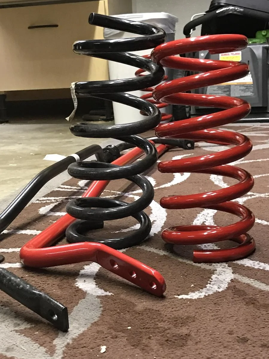

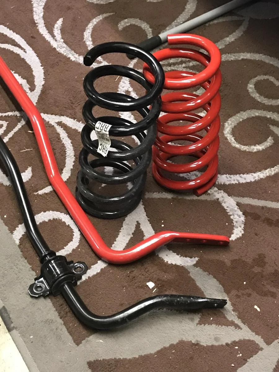

Old vs new springs and sway bars. Not a humongous different by the looks of it. Again, the sway bar advantage will come from moving the mount points closer to the fulcrum. The springs are shorter, but not as drastic as the front.
Spring height difference...
almost everything out
So, for SURE, you want to take everything out and do each complete side at a time. Someone had mentioned maybe leaving the camber kits and the sway bars for last, but do everything. Take everything all the way apart. It gives you so much more room to work with. I couldn't imagine doing the camber adjuster bracket without having the subframe lowered. This made it so much easier!

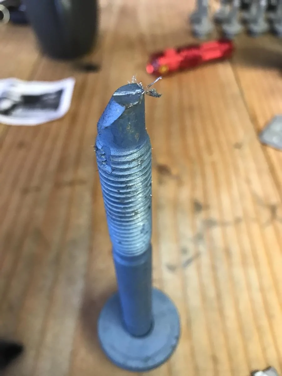

So yeah, the subframe bolts can DEFINITELY cut new threads if you're not careful. They come out with the threads they've already cut still on them!
Straight pipes????? Ended up taking the exhaust off for clearance after trying to get the sway bars off with the mufflers still there. Note to self, just do it at the beginning rather than struggling!
ALL OF THE THINGS ARE RED!
Overall, this was a straight forward install. It took me about 6 hours, but I took my time, took breaks, had my son with me from time to time, and the convertible bracing cost me at least an hour (stupid bolts never want to go back in). Everything went much smoother than the front, but I don't want to be back in this area again any time soon.

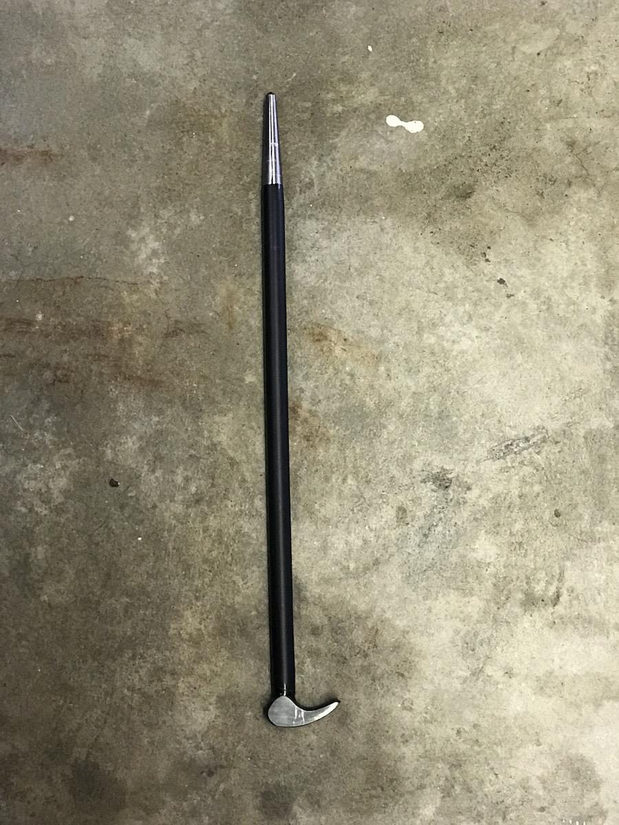

tool of the day was definitely my alignment pry bar. I got a set with some others in it for this job, but this was a lifesaver. Aligning the subframe to put the bolts back in was a snap (well, not a snap, but this definitely helped!)
If you're going to do this job yourself, make sure you have one of these!

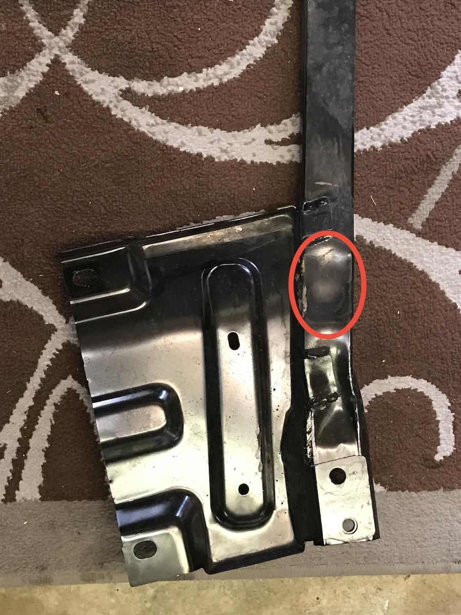

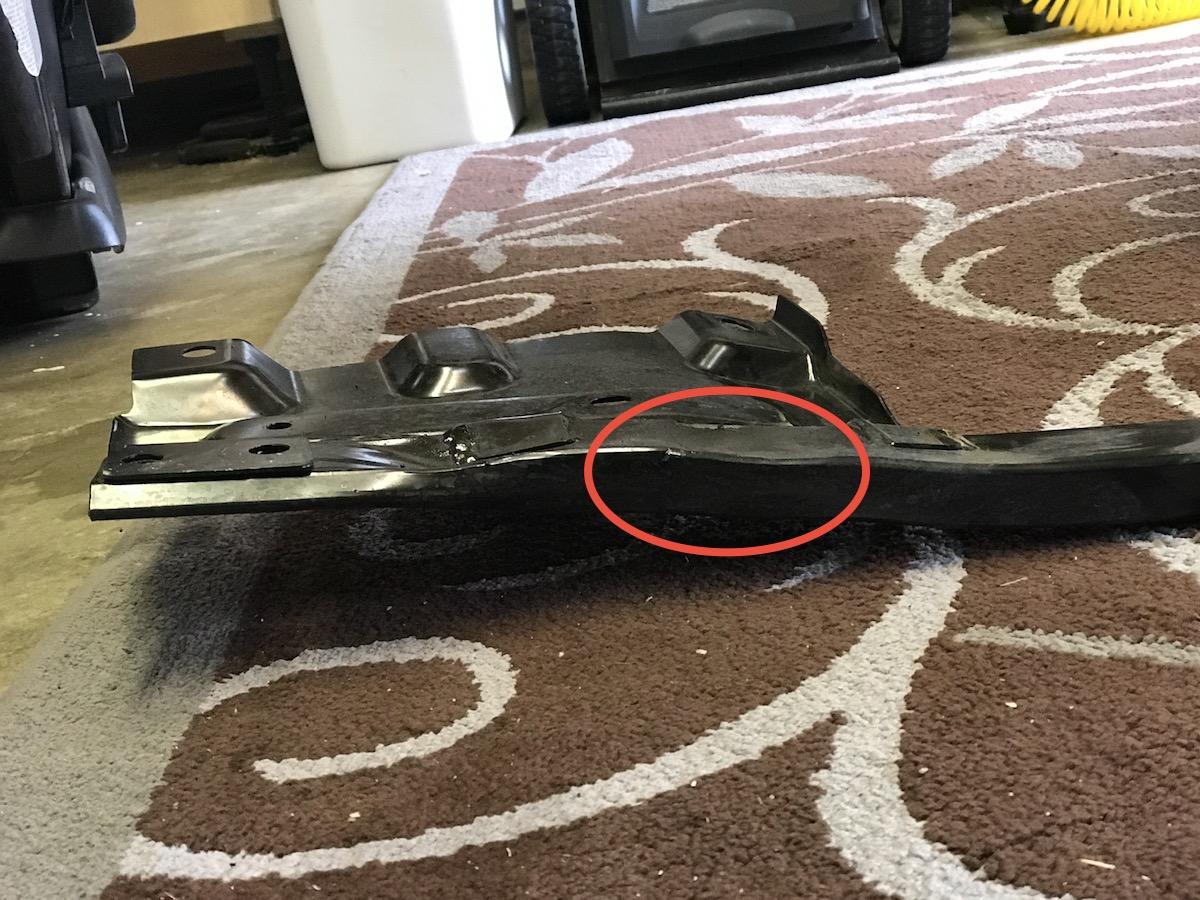

Since I had my convertible's bracing off again, I figured I would snap a couple of photos of how I got it out of the way of my Borla exhaust. I stuck it in a hydraulic press and straightened out here:
You can see how straight I got it here:
it was a small adjustment, but that's all I needed to get the pipes to clear. I also used a couple of washers to space the rear down, but I forgot to take photos before I finished. If anyone is thinking about getting coupe exhaust, this seems to work really well, and it's super easy. The borla pipes DO have an extra bend in them that some don't, but anyway, that's what I did!

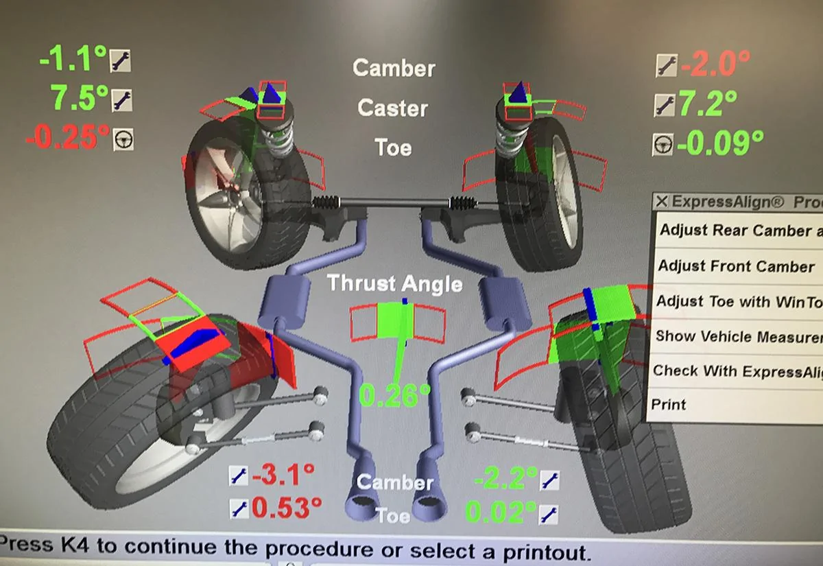

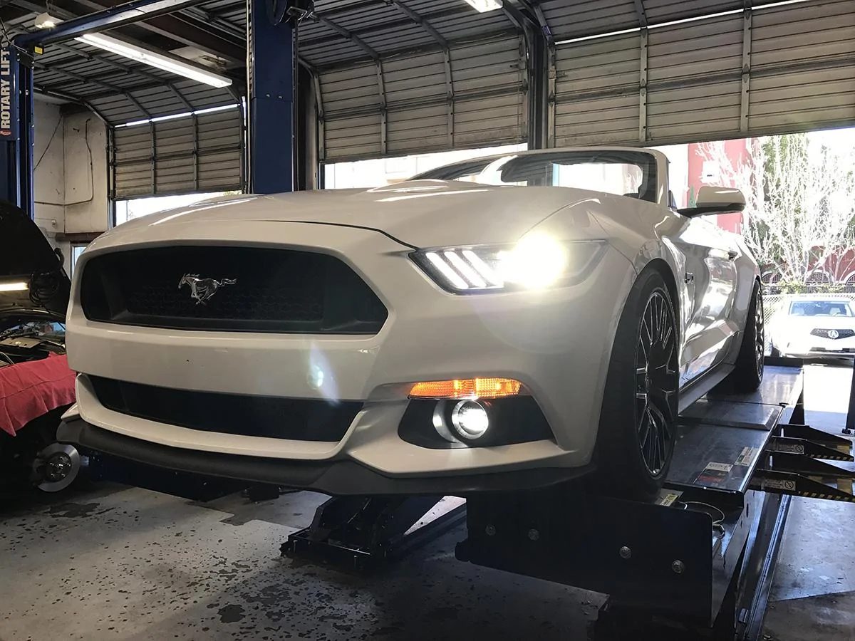

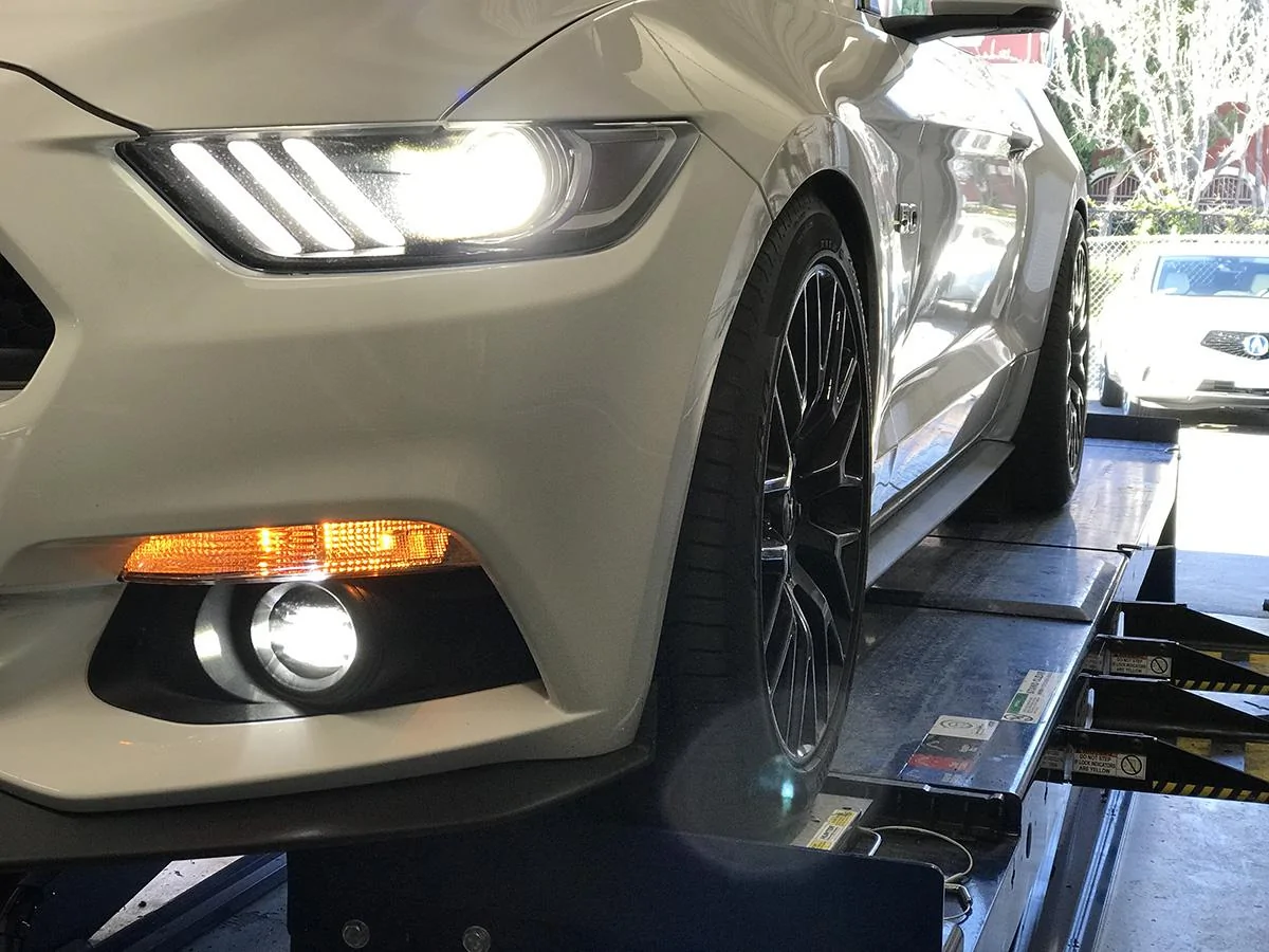

Did the alignment today. Unfortunately, the rear left would not go as far out as I wanted, so I had to leave it at -2.0... to preserve some dynamics until I can get back in and readjust the Steeda camber adjuster, I definitely strayed away from the specs that I was given. Front and rear is set to -2.0 deg of camber, front is toed in 0.05 and rear is toed in 0.1. I totally forgot to print the after sheet, but that's about where it's at. I'll be checking it again in a week or 2 to see if things have changed.
Aligning this thing with camber and toe front and rear was an absolute BEAR. Not fun at all... especially after 2 weekends of work to get it all in.
I just want to drive and enjoy my car for a while!
Here are the before measurements:
