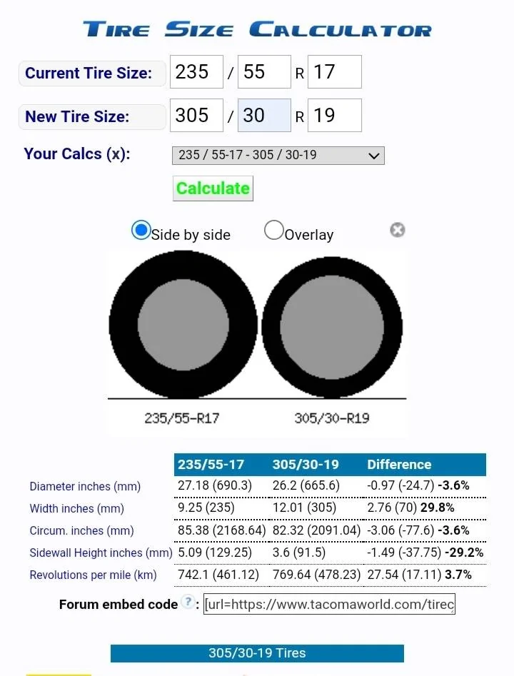

I'm in the process of putting new rims And Tires on my 2016 mustang .it had 235 55 17s and I'm putting 305 30 19 on it .according to the calculator that will be a 3.6 % in circumference do you guys think it will be OK besides speedometer off a tad?

Yes you will be fine. But they also make a 305/35/19 that's closer in size at 27.4" overall diameter.
Or do you prefer the smaller profile look?

Oh ok thanks..I had already purchased the tire before double checking but yes I like the lower profile look
