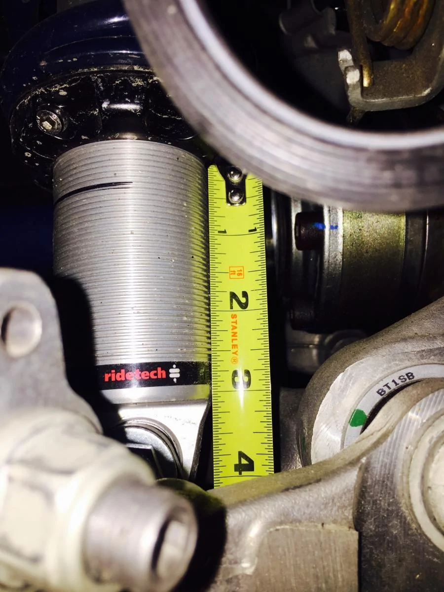

Gsxr, ever get a chance to measure the preload u have on front and rear?
3 1/2 inches from the bottom of the nut to the aluminum below the sticker in the back. This pic shows 3.125"
the front i touched the spring then 3/4" preload i believe.
