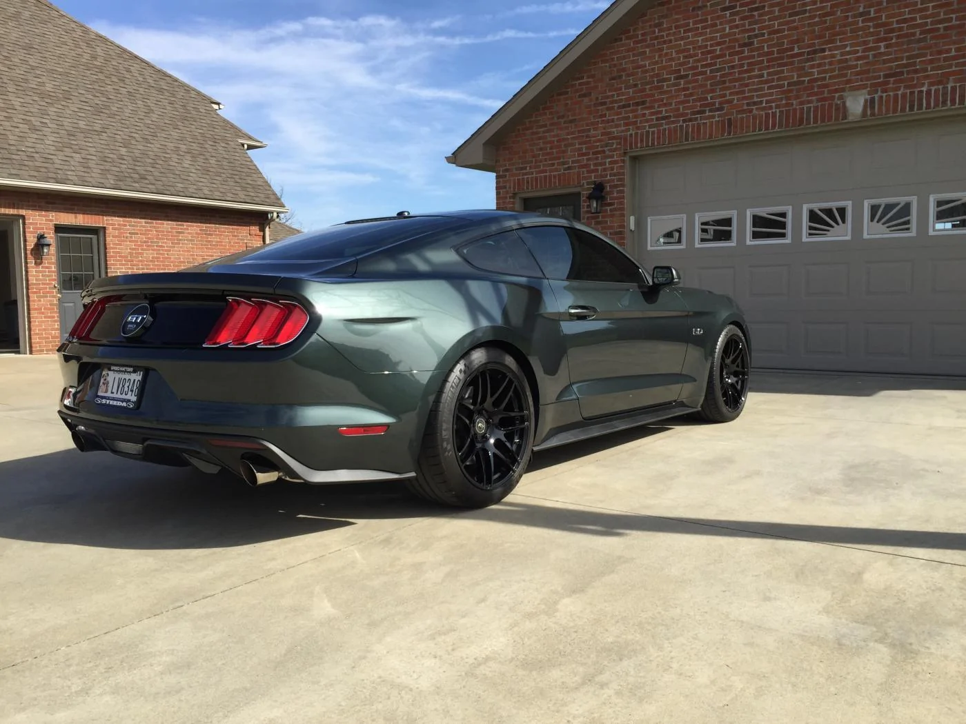

400# front springs and 500# rear springs installed without preload yielded roughly a 1.5" drop. There are 24 clicks of adjustment on the dampers. Ridetech instructs you to turn the knobs fully clockwise (full stiff) and then turn the knobs back 20 clicks, which would be pretty soft. I tend to like a very firm suspension setup, and these spring rates were on the higher end of what they recommend for the street, so I only turned back 5 clicks front and rear. [five clicks away from full stiff] Note: You can reach through the rear wheels to adjust the shocks, so the whole system can be adjusted in a minute or two on the side of the road, with no tools. That's convenient.

Mine sits as low as it will go with springs this stiff. There is no preload, so if I adjusted the collars down, the springs would be loose when the suspension unloads. That's not desirable.
Softer springs would allow the car to go lower, but would be less ideal on the racetrack. But the beauty of running coilovers is that you can order them with whatever spring rate you want, and swap around and try different springs until you find the exact combo which is perfect for you. Many people will be perfectly content with a cookie cutter approach [Eibach?] but if you have more discriminating taste, this setup is likely the one for you.
I would say my setup is ideal for HPDEs (along with other suspension upgrades which are going on the car, of course). If I was more into the stanced look, I would go with much softer springs so I could slam the car, but handling and tire wear would suffer. I'd consider this a "functional" drop.
I saw this, they look pretty sweet, but as little as I drive my car I think the Koni setup will be plenty fine for me.
I've gone the Koni/Eibach route before, and it works nicely- more than enough for the average Mustang enthusiast. But I wanted better than average handling. I don't mean that to sound smug, so please don't take it that way. I literally mean that I wanted the best handling combo which fits my budget. These Ridetech coilovers, along with some other suspension mods I've ordered and a more aggressive wheel/tire combo will certainly be the best handling setup I've taken to the racetrack. And cornering grip is far more important than horsepower in that realm. I'm really looking forward to this!
Thanks [MENTION=8712]Sharad[/MENTION]. So if I'm understanding you correctly, these can be adjusted for less of a drop then. I didn't want lower than 1.5", I was looking more at 1" or so.

Mine is maybe 1.25 front and rear. I could bring it up to stock if necessary.

Yes, that's correct. I'm sorry, I misunderstood your question. A little bit of preload on my existing springs would raise my car up to the height you're looking for.
