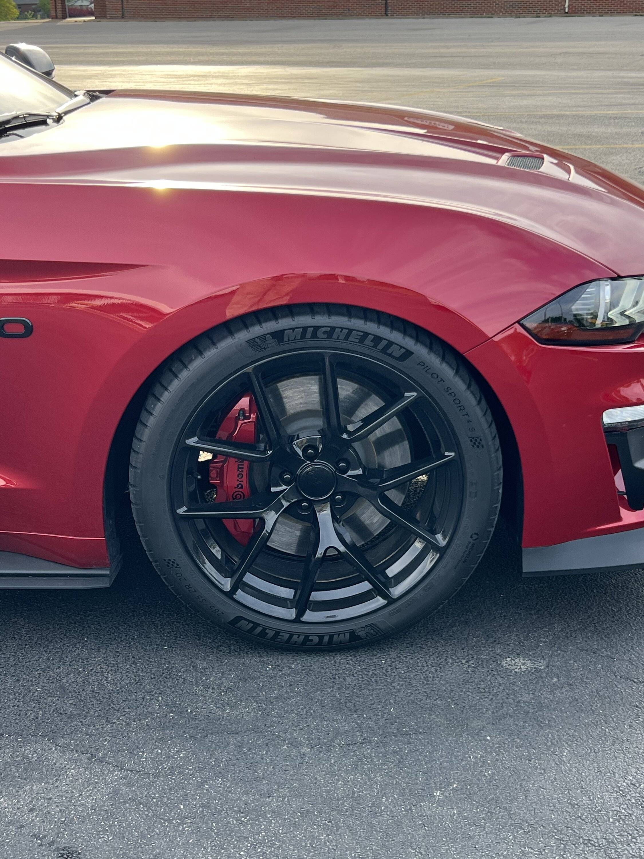

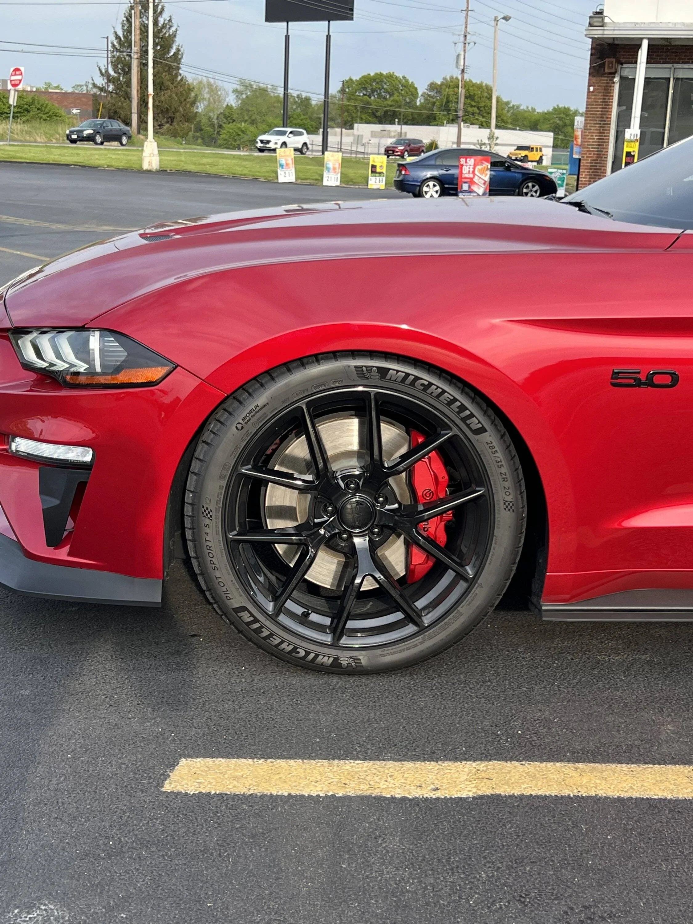

weird one for you guys. my mustang has developed a little height issue on the drivers side. it looks a little lower than the driver side today almost looks like the tire is "tucked in" i have FP magneride lowering springs, FP sway bar, and a BMR k brace up front with all about 10k miles in them. everything has been normal till i noticed it today. doesnt make any clunking sounds or anything dont see any rubbing on the tires. havent been able to get under it to see if anythings weird. magneride seems to work find and i dont have any lights indicating about a magneride fault. kinda at a loss here.

i will have to measure again. i measured from the bottom of the tire to the top if the fender and its about 1/4 inch shorter on the driver side. ill measure from the center of the wheel when i get home. the psi on all tires are the same. i am slo going to measure the camber as well to see if thats whats causing it

just an update for you guys i did use a Clinometer on both front coners and the camber on the driver side has a full 1 degree differential compared to the passenger. im going to start there and figure out if that helps at all
