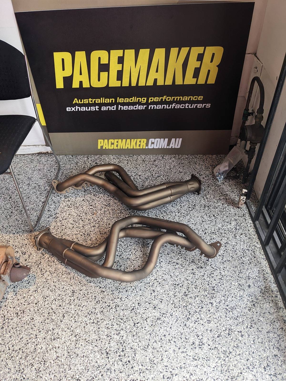

Yes I had the Pacemakers put on last week. Bit soon for me to fully assess. I drove it home (about 80klms) and have had it up on jack stands since. I will be doing a service and adding a few other mods while it is up. I am putting this work off a bit because at the moment all I have is a roadbase floor in my shed and it is mighty uncomfortable not working on concrete.@PKs any advance on the header install Peter?

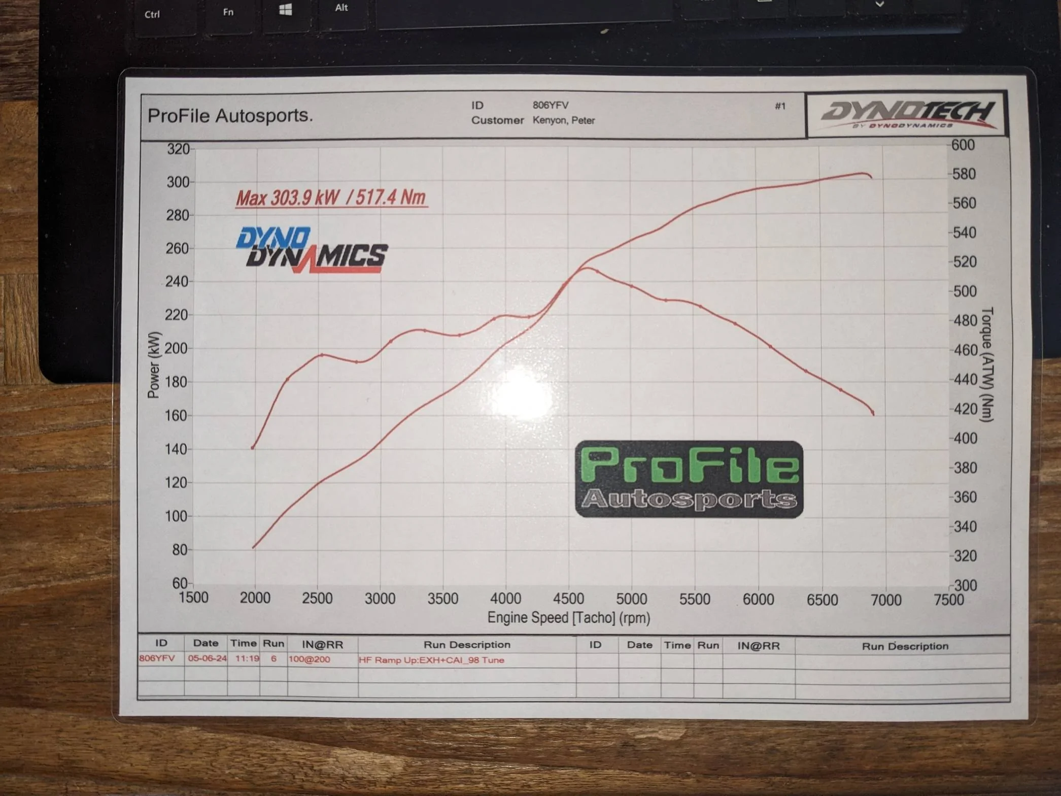

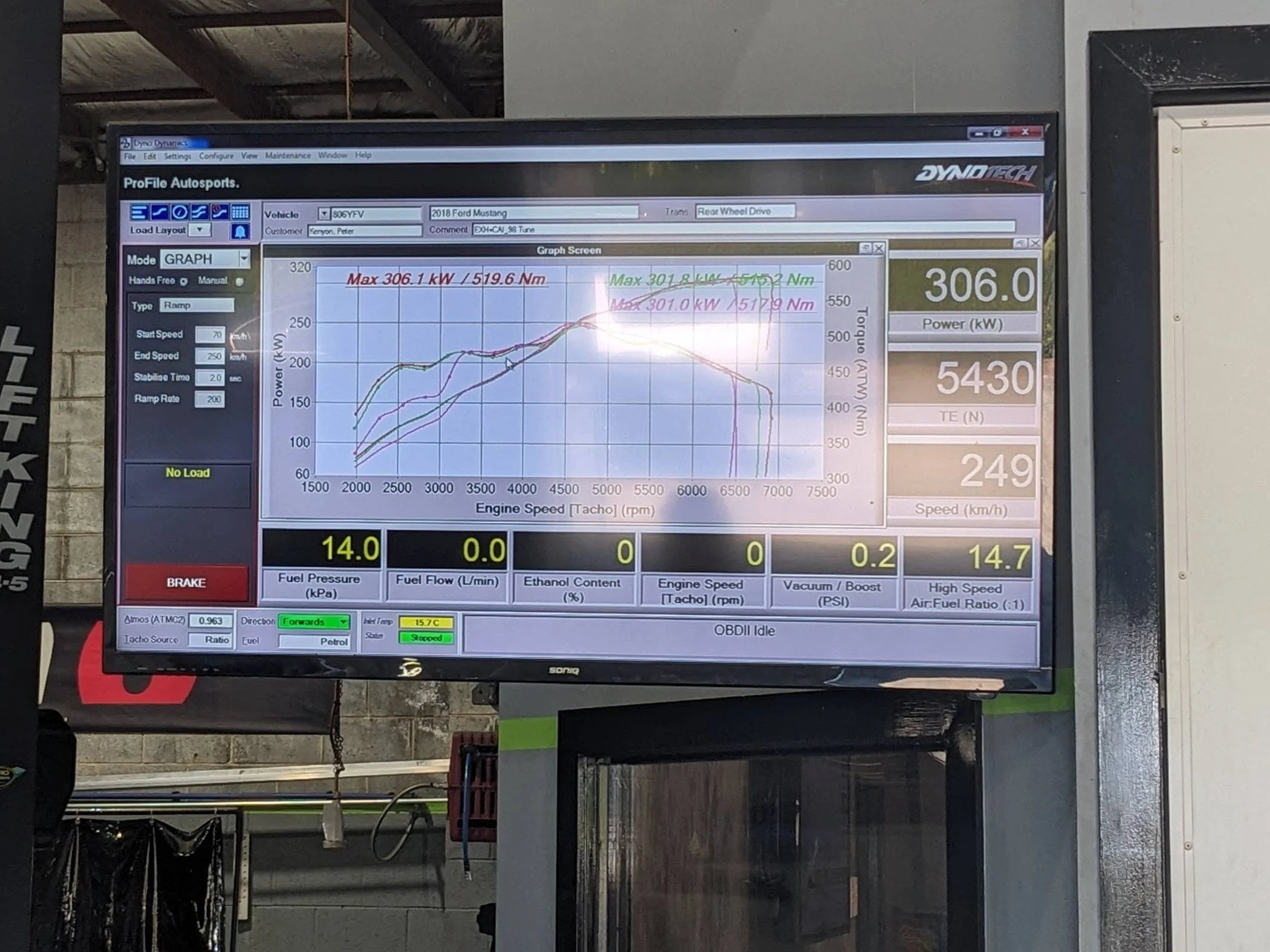

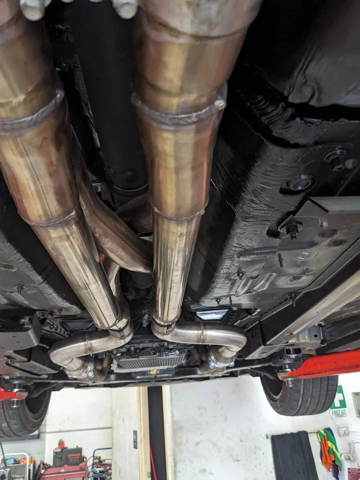

Yep, I will ask for low end torque instead of high speed as well.PKs - I Have Ramjet 1& 3/4 inch Headers to 3 inch Hi-Flow Cats & 3 inch Borla ATAK Exhaust on my 2017 GT - I Had to put a Borla 3 inch Resonator in place of the X Pipe as it was just obnoxiously too loud without - I Recommend getting a custom Dyno Tune so the tuner can tailor the tune for your requirements - I asked for torque as I rarely rev above 6,500rpm - Dyno printout below:
