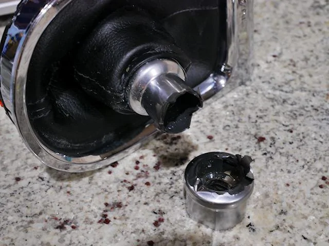

Going into reverse felt sticky for a few days, also sounded more hollow than usual. Saturday I went to shit into reverse and it literally shattered in my hands. Thankfully I was in my driveway. Dealer quoted $290, for the entire assembly/boot/surround, needless to say I ordered the Steeda unit and will be doing it myself.

That part is $75 and literally just snaps off the console. You will break the clip of the original one but the new one will snap right in. Only reason i know this is because someone broke into my car and scratched the shit out of it so i needed to replace it. Your dealer is seriously ripping you off. I would punch them in the mouth if they told me that number.

I found the part online, 7277A. You are correct, that's MSRP, & it can be had for even less. They don't call them stealerships for nothing. Went with the Steeda billet unit to prevent this from happening again as I'm not sure how it even broke in the first place.

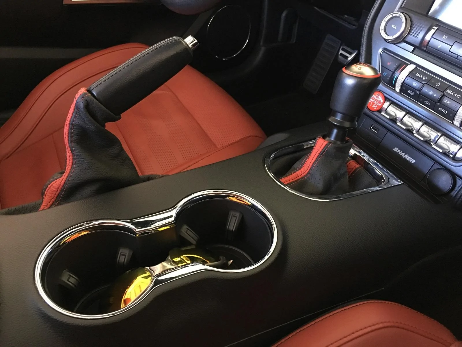

I've got the Delrin (black) Steeda reverse lockout, outstanding part, no more worries about what happened to you - plus it looks +awesome+.
saltydogg
Dec 18, 2017
52
NC
Steve
2018 GT Premium convertible - 401A, 6MT
Where did you get the boots for the shifter and e-brake that have the red stripe?
MaskedRacerX
Driver
Sep 20, 2015
73
5,611
4,689
Vilano Beach, FL
DT
'21_JWS4XE / '21_TM3P
Hey!
Sorry, I didn't check back into this thread and didn't get any notifications.
The e-brake and shift boot are products from Redline:
https://www.redlinegoods.com/
My quick insight:
The install is a bit of a PITA, especially the e-brake, but not hard - it does require gluing.
They're manufactured overseas (Europe), so shipping is a touch slow
The material/quality is outstanding, the match with my red interior is right on, so is the customer service, I had an issue, it got resolved quickly.
The problem: they were both a touch short, well, the e-brake way so, like unusable, the thicker material, that doesn't give much needs a little more slack. I wound up getting a replacement e-brake boot with an additional 1-1/2-2" of length. I kept my shift boot, but I would've preferred a _tiny_ amount of extra material. Just factor that in if you order.
