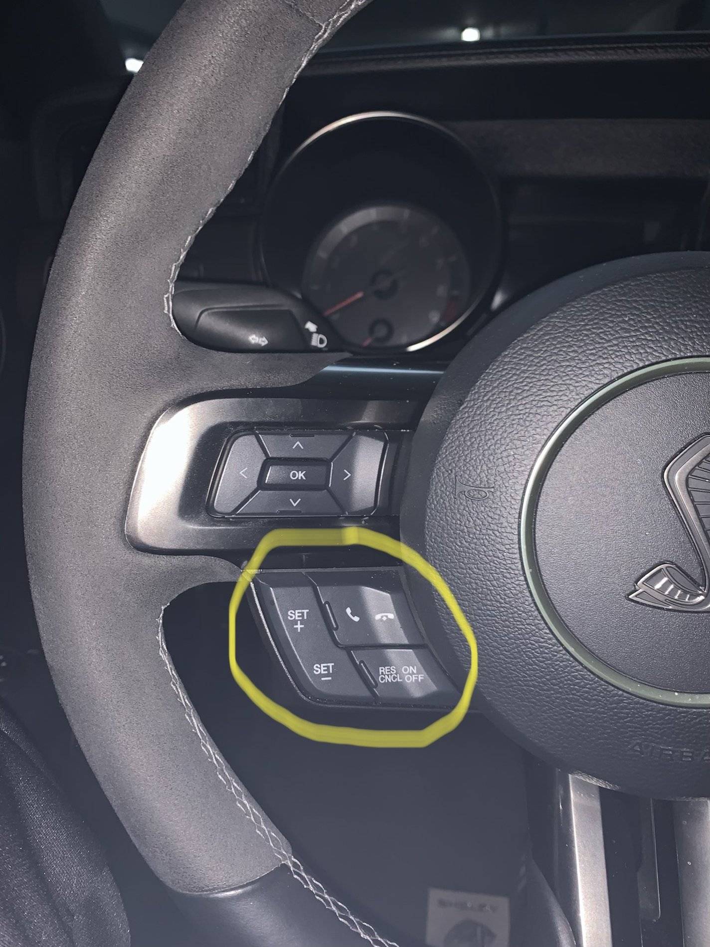

Curious to see if you have a cruise issue. My cruise didn't crap out right away it would work sporadically and disengage on its own. Over time the surging became worse and the cruise quit working entirely. The fix is really easy it's literally a nut and some loctite to keep it from backing out. I bought the TSB to my dealer and they confirmed that was the cause.
You were right, my cruise control won’t even turn on. I didn’t see anything light up in the gauge cluster whenever I would press the button. I also noticed the my phone call/end button not responding either. I wonder what the problem could be aside from the transmission output shaft bolt?
