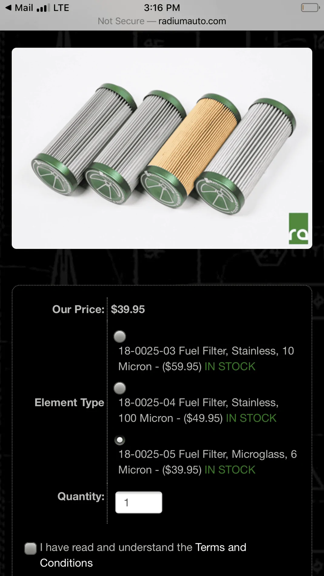

Radium offers a micro mesh steel that allegedly filters to 10 micron, but I've seen several people say that Injector Dynamics won't warranty any issues if you're not running micro glass. I find it hard to believe there's an appreciable difference in fuel quality between 10 microns and 6 microns filtration, but I'm planning on micro glass.
Radium says the published literature on replacement is way over protective, but the microglass filters aren't serviceable (and their micro mesh steel can be backwashed or sonic/vibe bathed).
The Fuelab microglass filters have roughly the same recommended replacement interval and I haven't decided which version I'll go with it. Fuelab offers a high flow integral check valve, and most of the others you need an add on check valve. Not an issue if you run pumps with an internal check but should help maintaining pressure for less grumpy starts.

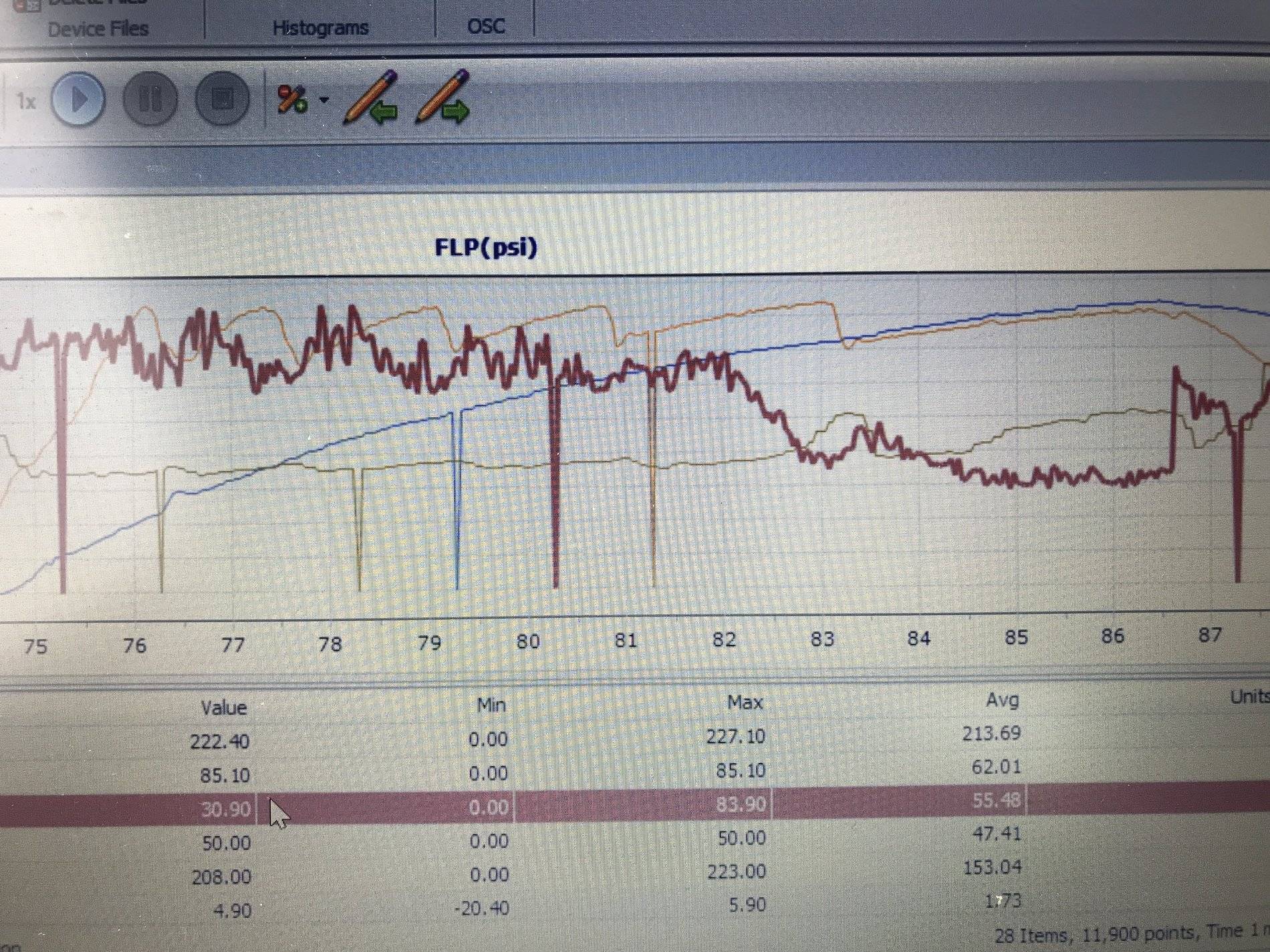

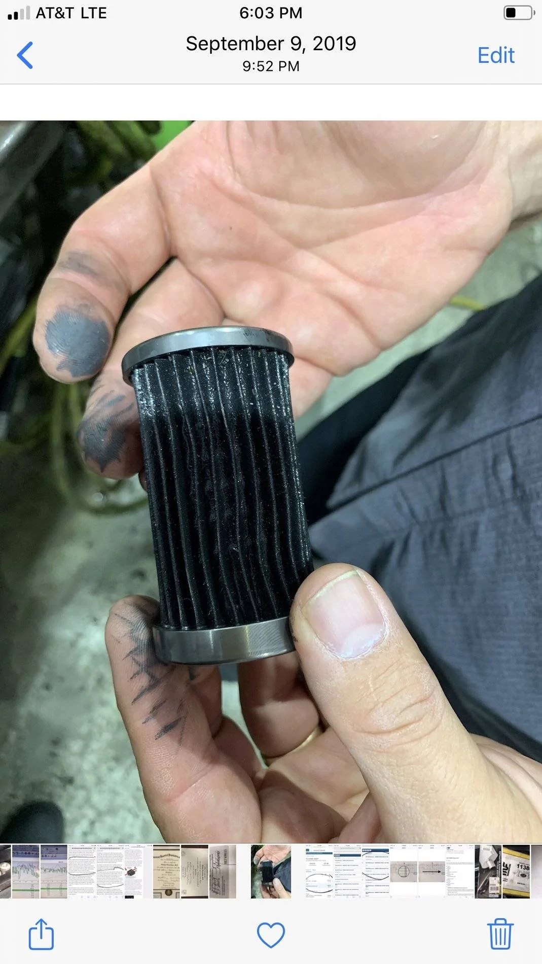

The picture of the filter is from last September when it first happened. Cleaned it back then and had planned to check it again ... but did not .
the log is from a pass 2 weeks ago . Ran a 9.7@147 on first shake down pass and pressure was good .
The log is from the second pass when I launched hard .. I could tell it something was up on the back half .. ran a 9.6@ only 143.. should have been a 9.4/9.3 pass .
I pulled the fuse to each pump and both are on line so I am assuming it’s the filter again but not looked yet .
It’s a stainless steel filter .

I ordered a new but based on what you said may be I should switch to the micro glass ?
I honestly don't know, I'm going off what others have recommended. Some people have said it doesn't matter but others who've had issues with ID have said the first thing they ask is what filter.
Like I said, I doubt there's a measurable difference between 10 micron and 6 micron pass through, but the micro stainless at least allows service.
Radium said their filters are big enough that it shouldn't need replacing the microglass for several thousand miles (he just said a very very long time).
The replacements are like $35. So I think I'll just get the glass and check it with every oil change. Hopefully it doesn't turn out to be an often deal. But 6 micron filtration is definitely gonna pick up more junk..

Man, it's so dirty it looked like paper:)
What's causing so much gunk?
No idea .
I typically only fill at the Meir gas station but I went out of town and filled up at the “family something “ station ...the week before this happened .

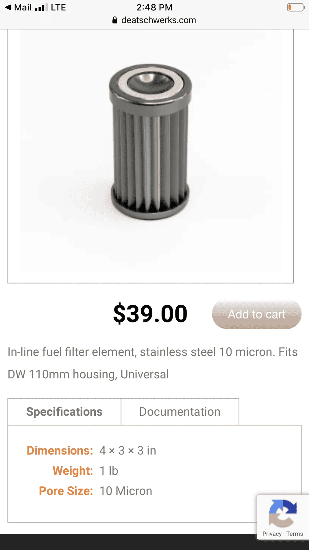

thanks man .
I ordered just the micro glass filter element .
I will see if it fits but it looks similar to the DW steel one I ordered which is a direct replacement.
