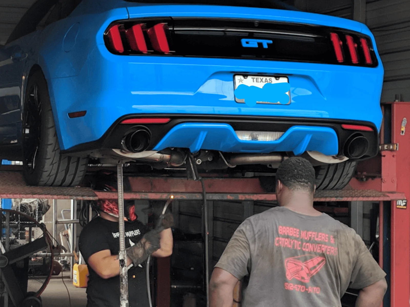

Had my Vibrant Resonators added to the section just behind the mufflers. This setup has eliminated the rasp. I need to break in the resonators a bit still. Very pleased and highly recommend this for people with long tube headers both catted and catless. This sound is so amazing through the Corsa Sport with resonators added.
