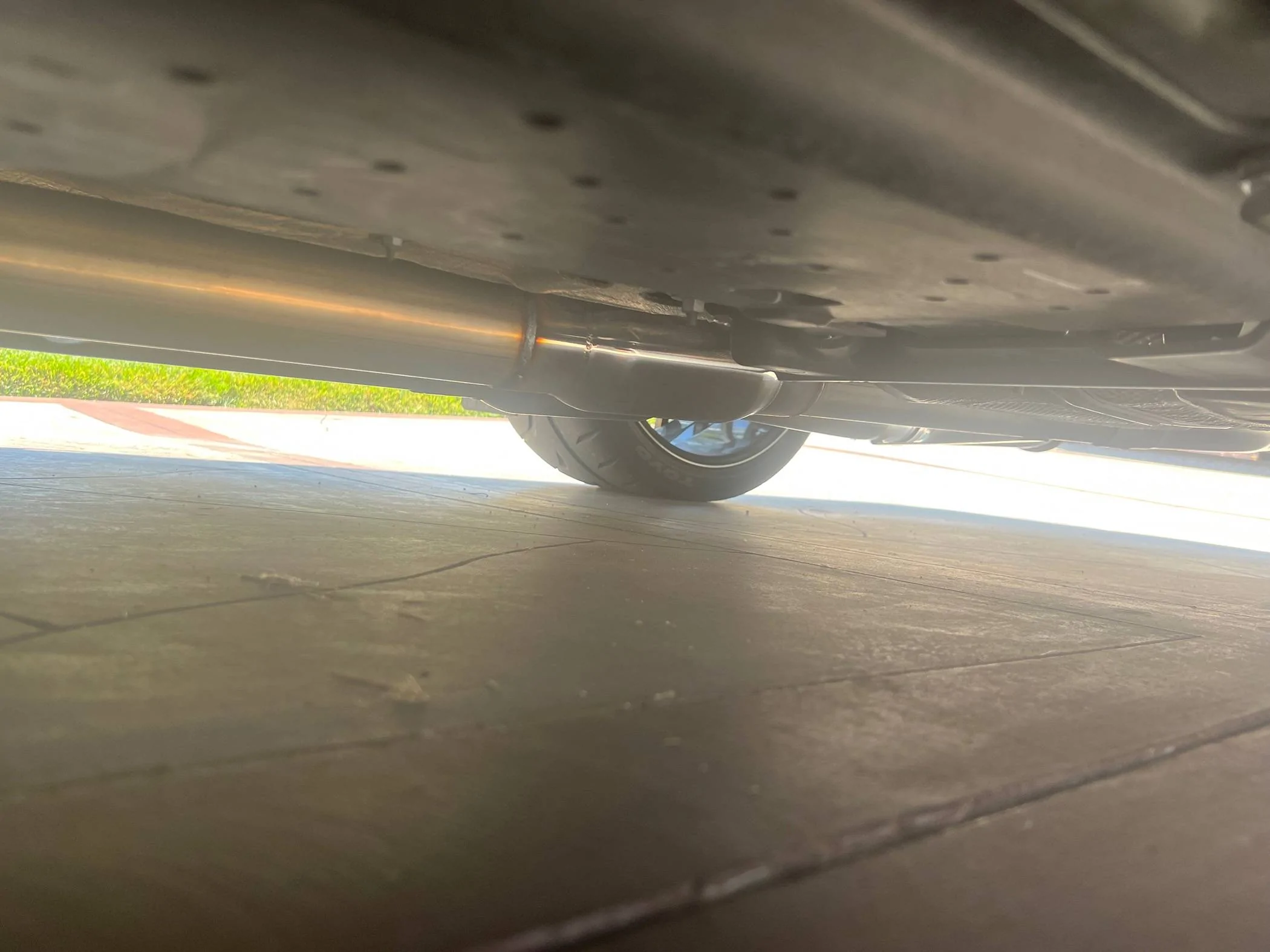

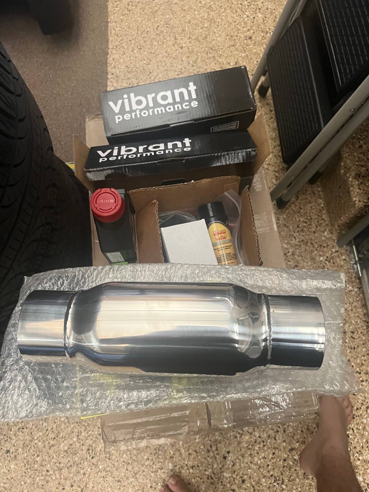

I recently had installed the 18" bottle resonators from Vibrant 👌It definitely refined the sound and growls nice and deep. No rasp but drone remains at highway speed unfortunately. This was added after a cat delete.

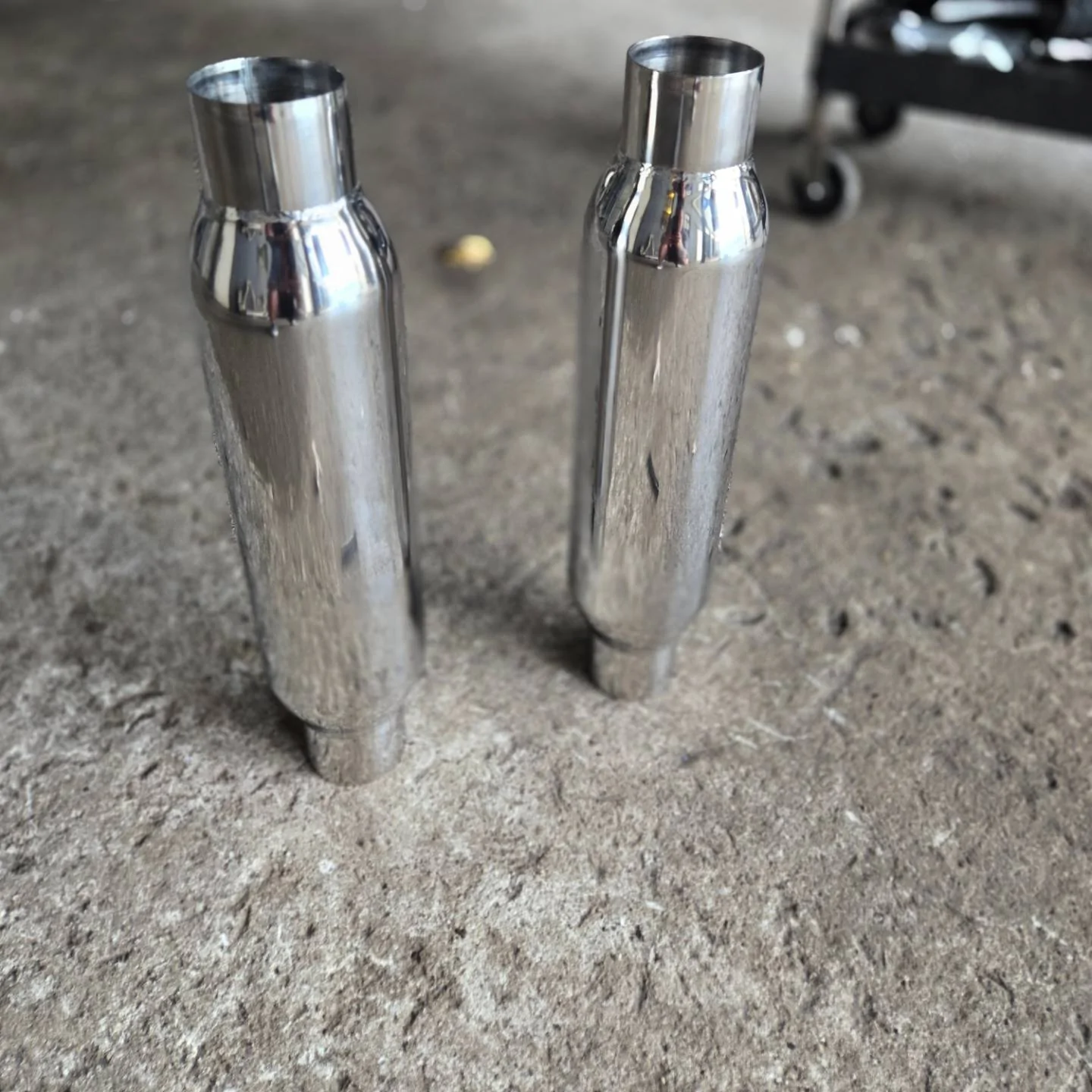

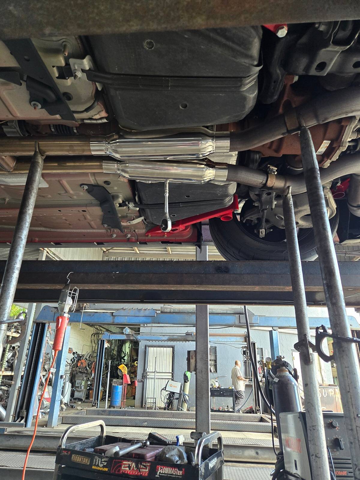

I also added vibrants I had corsa extreme double h pipe active in my 22 it always had an awesome sound then after arh catless headers it gained that same raspy rattling sound your talking about sounded like crap. I added the vibrants on the second h pipe portion and it made a night and a day difference refined the sound and brought back the muscle sound it quited it down slightly it’s still wake the dead loud when getting on it but sounds clean now. I used the 12 version there part number is 1794. they make different sizes so just check where you’ll put them those 1794 are 3 inch o/I .

There is hope for me still to keep my Switchfire and control the LTH sound. Thanks @Nitrofish.

Fits like a glove. They barely free flowing and does not interrupt performance. It really refines it to almost like having the "Suit case stock resonator on" In a sense I'd say but without it being a restrictive point.

*They are free flowing" I meant to say.
