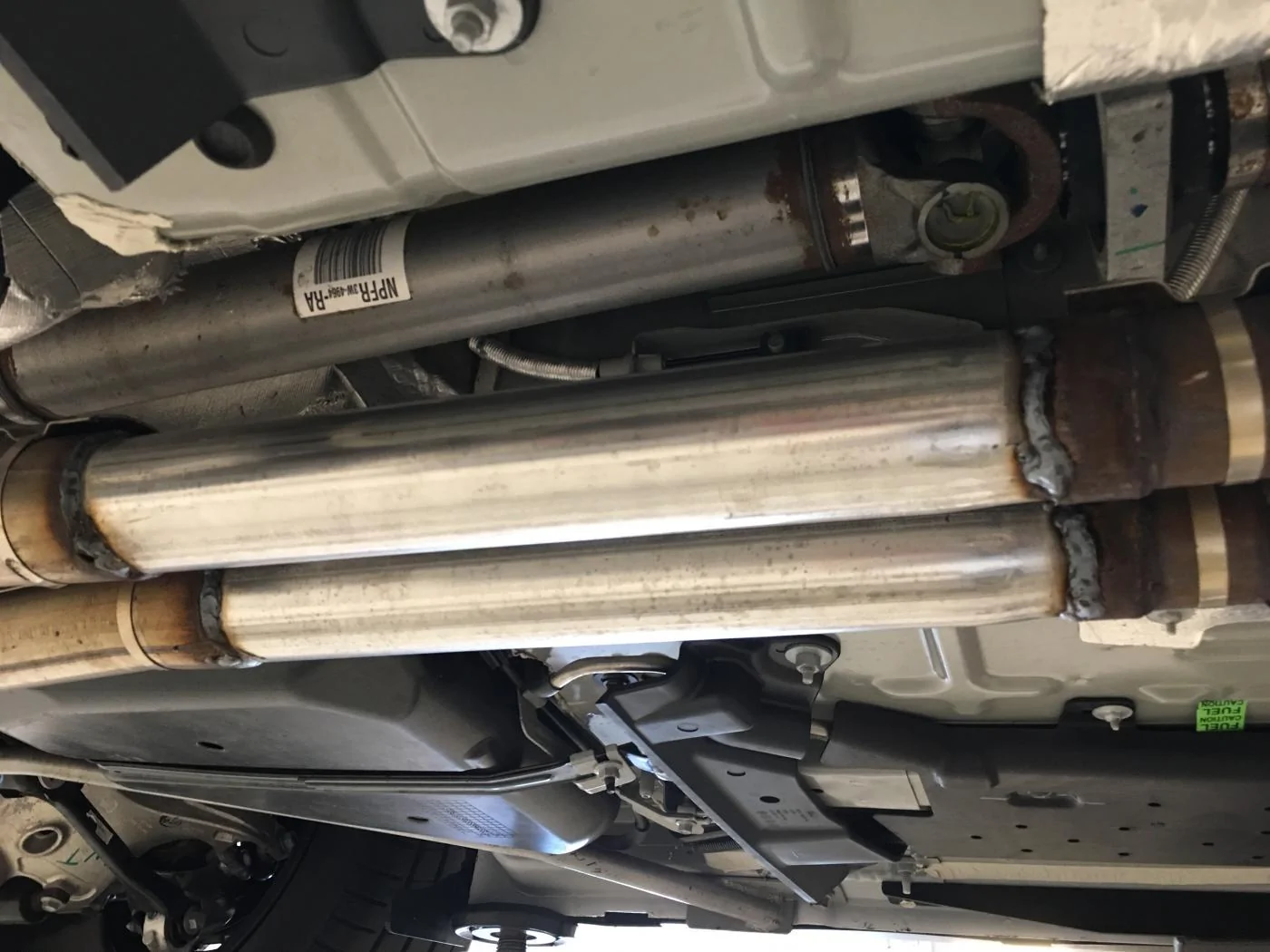

Money well spent. Save weight by R/R resonators with S/S tubing. I used 304 stainless OD 2.75". 2' length per side. Lot of muffler shops (around L.A.)don't carry 300-400 series stainless tubing. I got mine through work & took it to a shop near me to have them install it.
You'll be driving in Sports Mode ALL the time. Once you delete the resonators. :)
How did you mate the 2.75" tubing to the factory X-pipe?
I believe the tech fitted the S/S tubing over the X-pipes & welded them together.
I'll take a picture of his job & post it this weekend. I'm having my P6G "R" spec wheels put on Saturday. When it's on the lift, I'll take some shots.

looks like they may have used 2.5" on my car. I don't care. Sounds good. Mission accomplished.
No offense to you, I understand you just wanted the sound. That being said, I would kill someone if they did that to my car. Those are some birdshit welds and just a mess.
I'm glad you said that because I was thinking it :frusty:
No offense taken. The welds look crappy, but it gets the job done. You won't see me having mirrors under the car at a car show..
Who cares? It sounds awesome!
