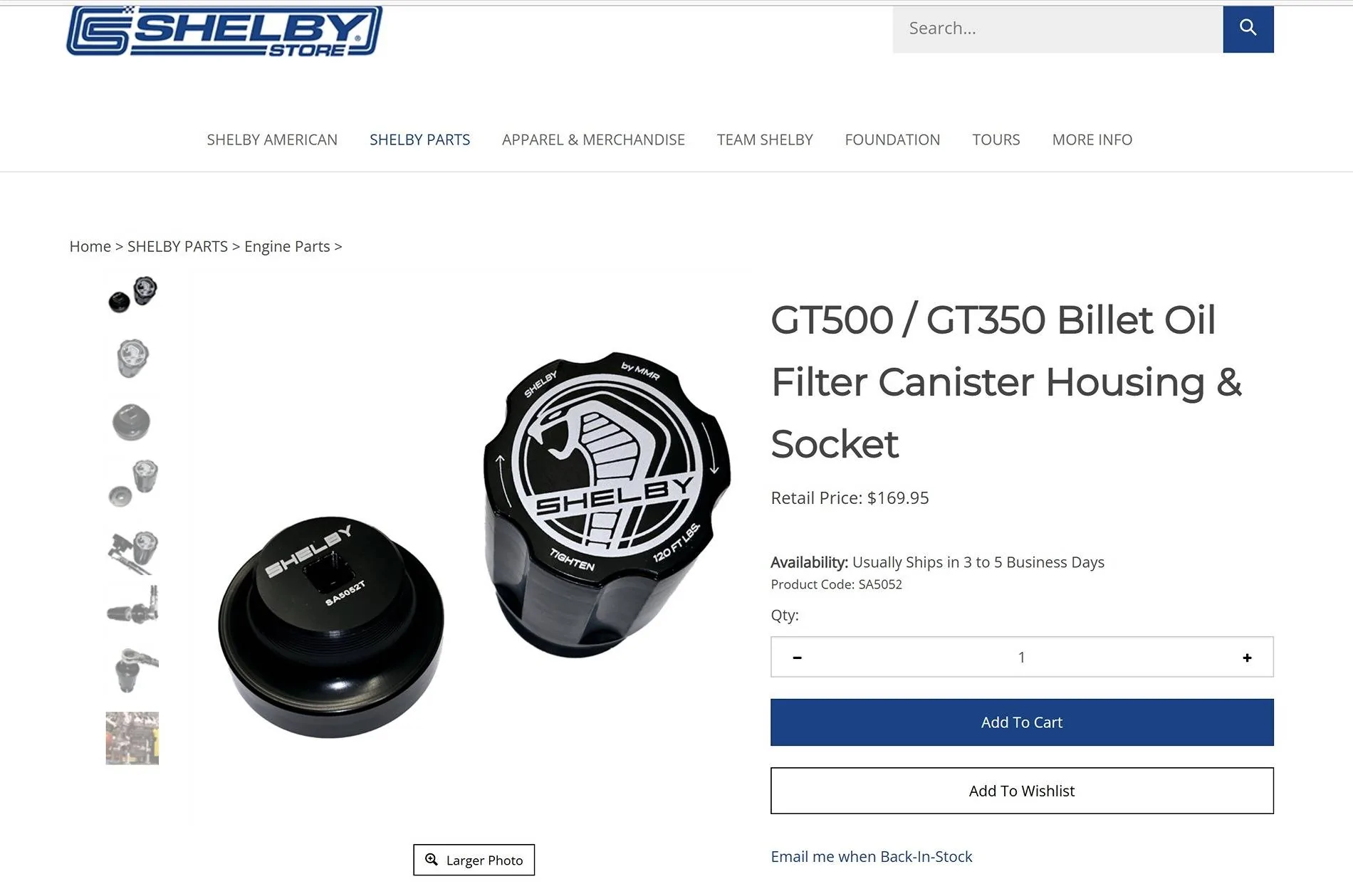

Has anyone put an MMR metal housing on? I checked into it and they indicated that their metal housing requires 120ft lbs of torque for proper installation. Any thoughts on that are welcome.

Saw this at
ShelbyStore.com

I like the looks of it,, can't get my head around th torque spec of 120 ft lbs.
