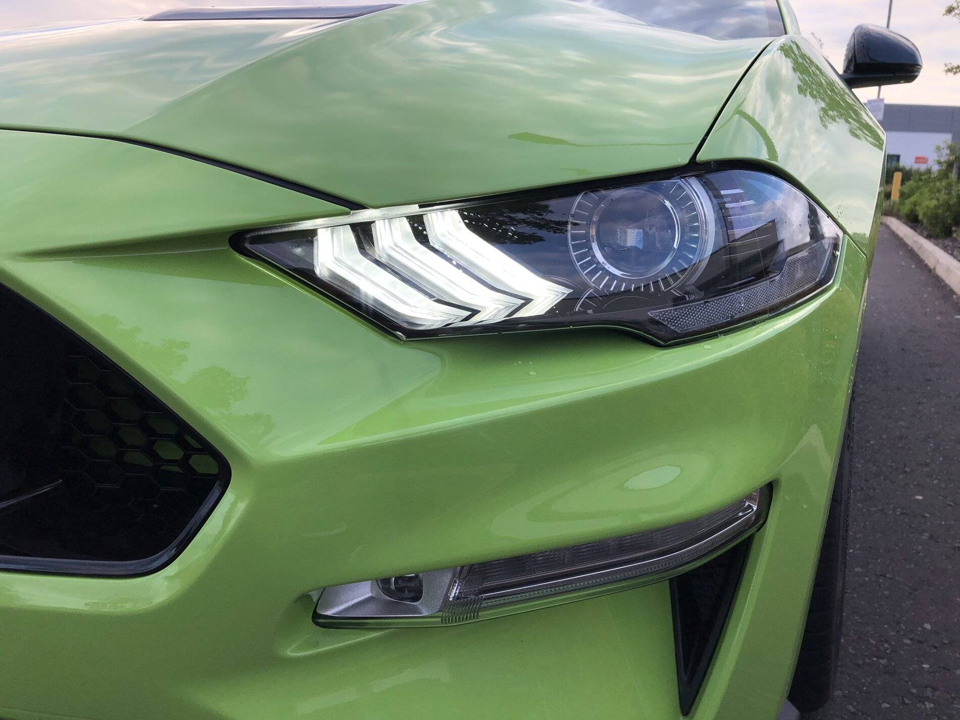

When the engine is running and in daylight :
Tri bars and but no fog DRL

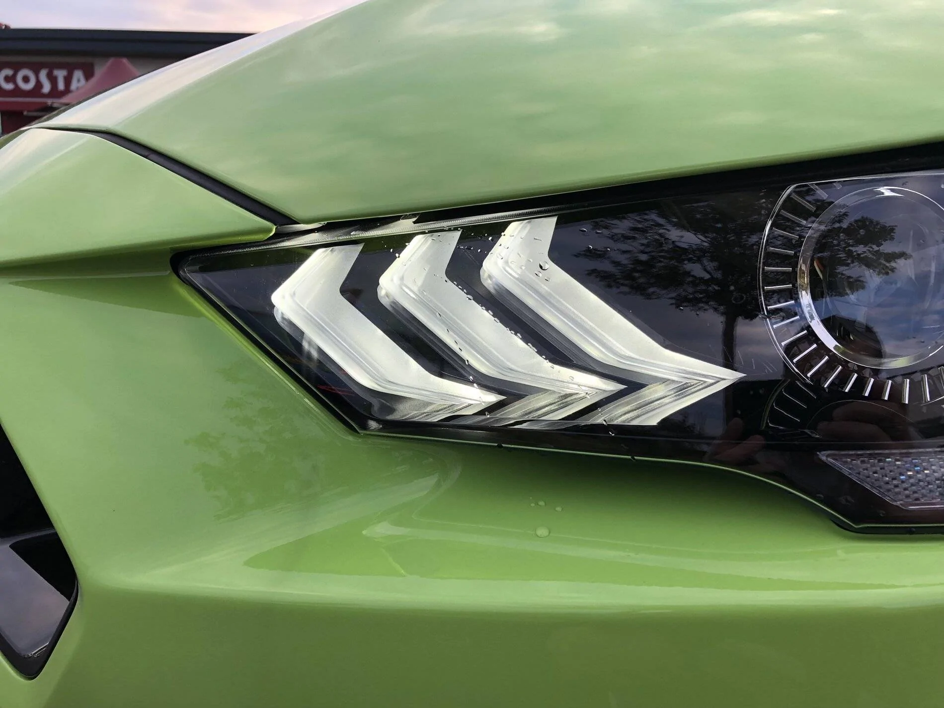

A nicer view of the tri bars :

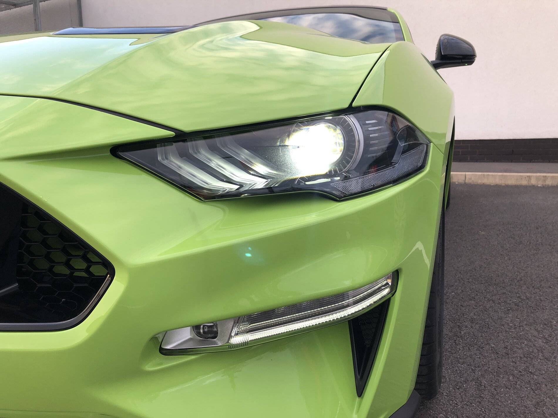

When the engine is running and the headlights come on, the tri bars turn off and the fog DRL’s come on :
The tri bars still look a little illuminated, but that’s only because the catch some light from the main beams.

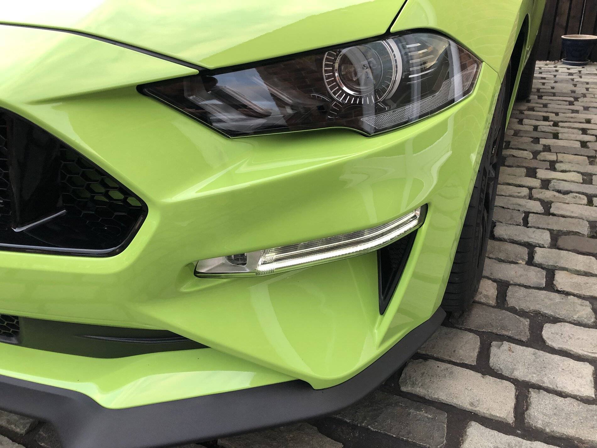

Engine off, locking the car :

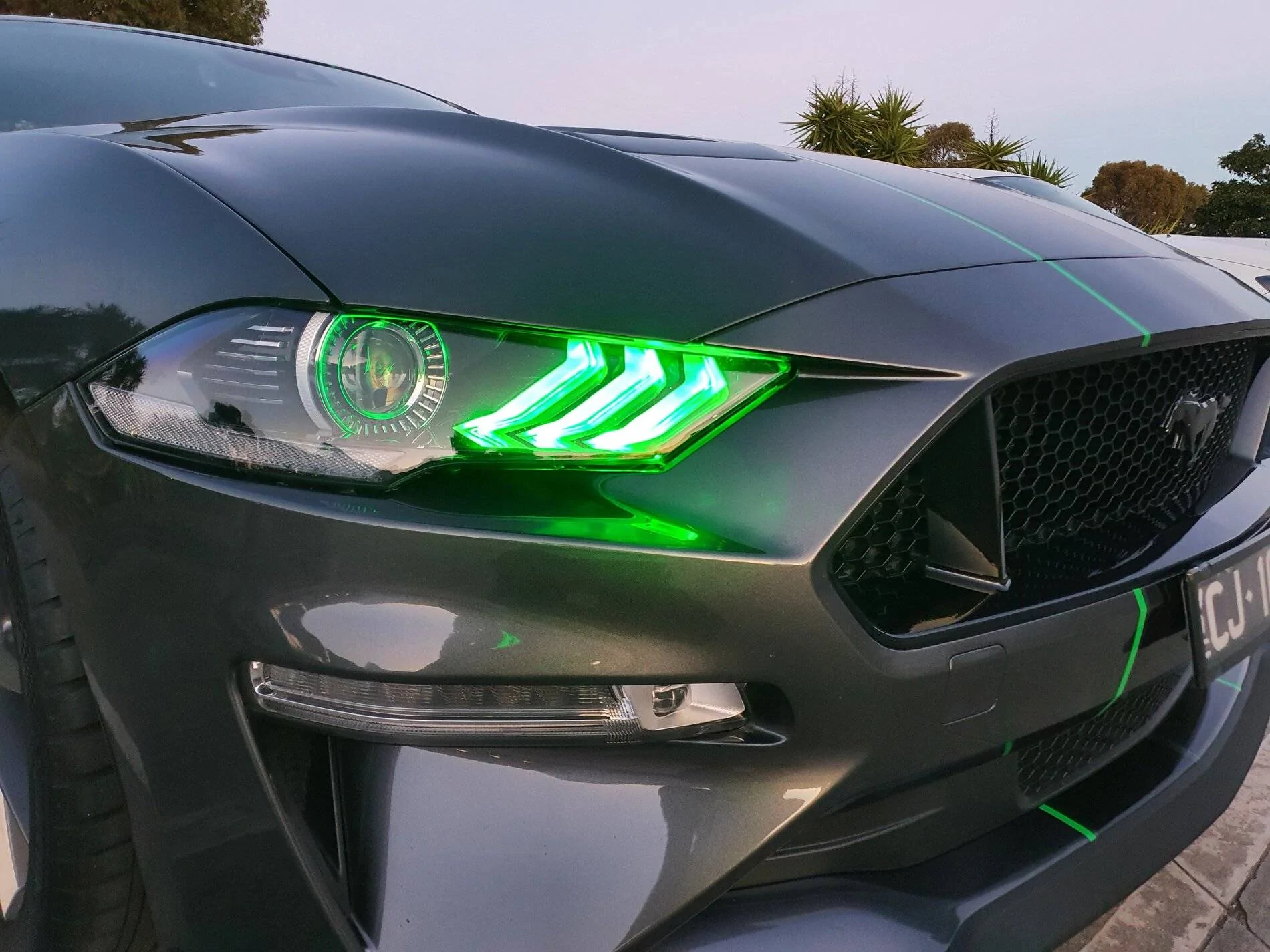

I have the Exotic rear taillight sequencer set up the same as WD , very easy install.
Plus went all out and added this.
And they operate as an Orange sequential Indicator, awesome Mod.. Luv the sequential Indicating , thats what Mustangs are known for.. :-)

Did you have to open up the front headlight for the front tri-bars?

Big Job, Front bar off lights out, open them up, replace Tri-bar and re wire then re-assemble .
I believe there is a few ways of opening headlights oven , or cut open with Hot knife..
The big concern is to make sure lights are sealed properly so no condensation gets in..
