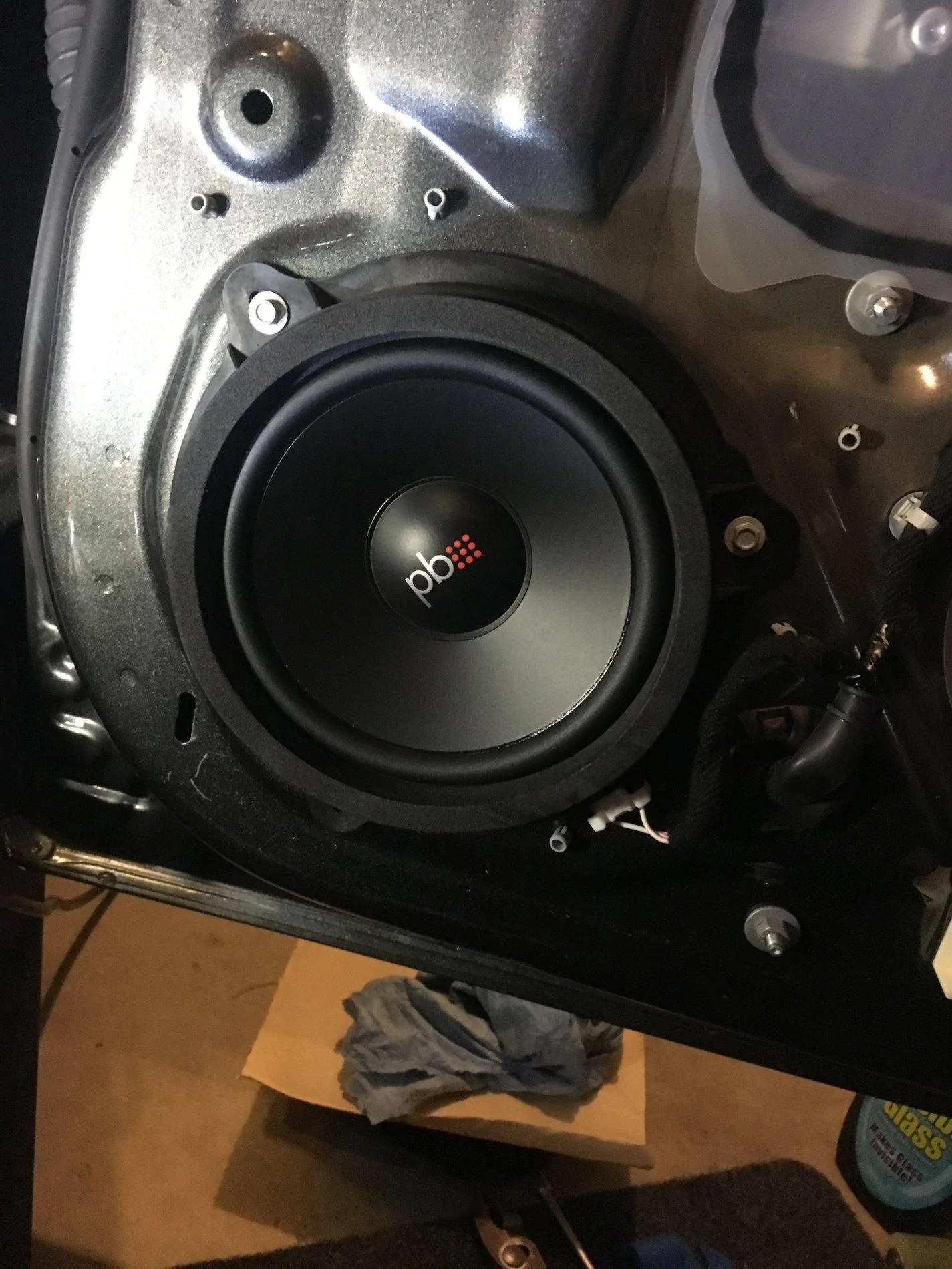

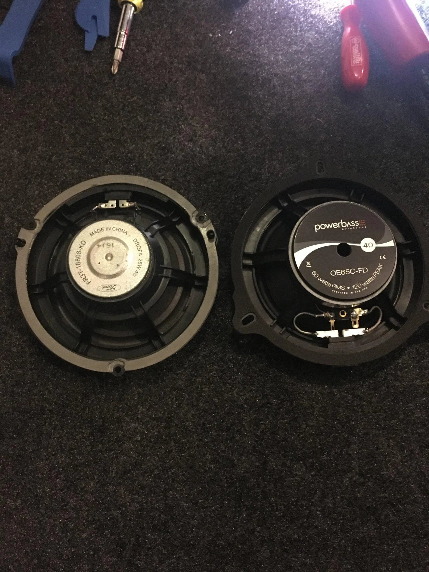

Not sure about the ohms. Direct replacement. You can see from the photos of the old factory speakers. Maybe the confusion is mine was the 6 speaker system. May want to check Powerbass website to see about the other speakers.
I have just spoken to someone at Crutchfield.. and indeed the front low speakers are 4ohm from factory..
So your recommendation is correct.. thanks!!

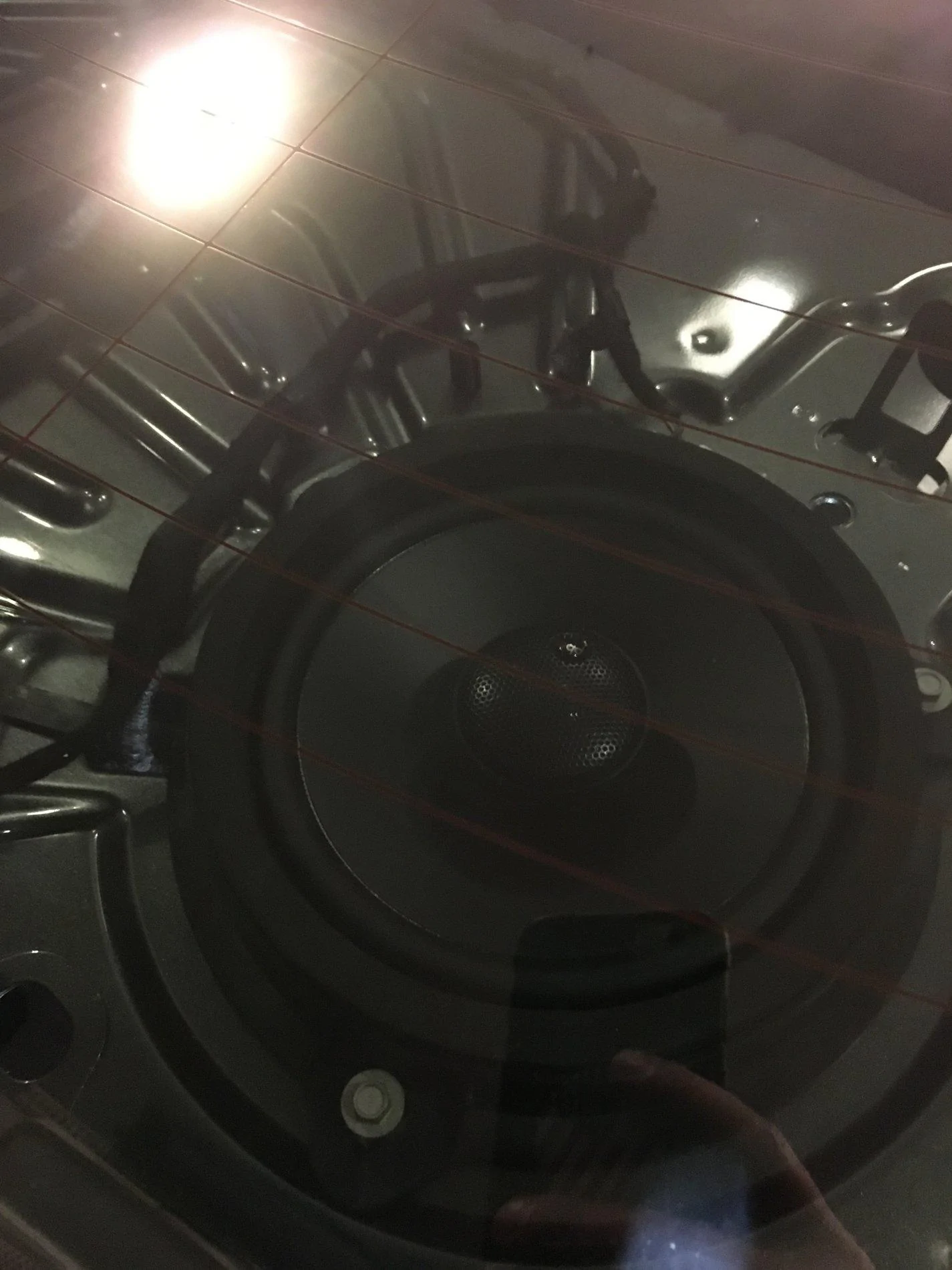

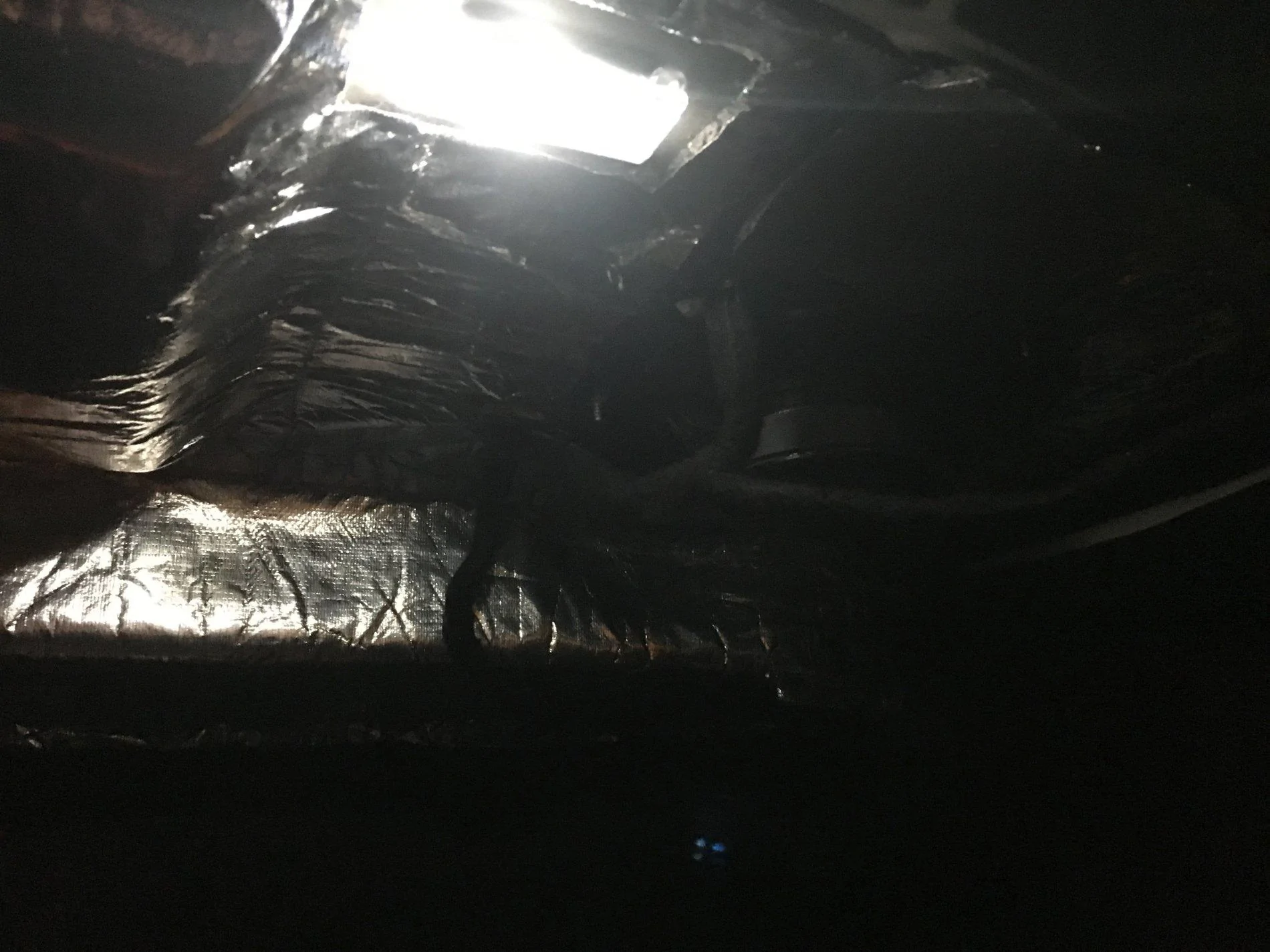

Here is the rear. keep in mind you may want to put in some sound insulation. I did the entire trunk and bottom of the speaker shelf. Made a big different.

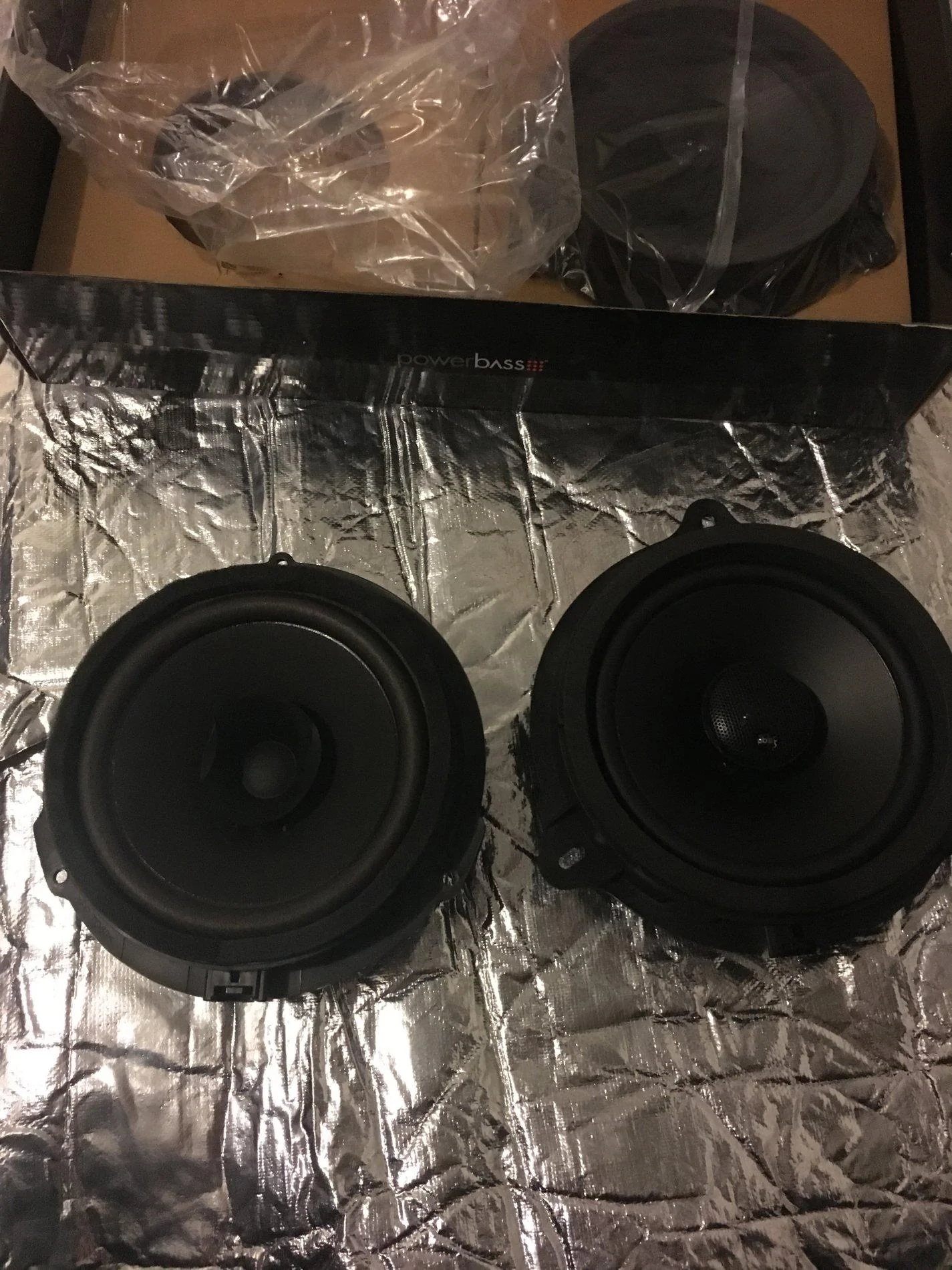

For the 6 speaker system the tweeters went in the pillars. I will have to look again for the photos comparing the factory to the Powerbass. Tried to do a side by side of each. I will look again and post the photos shortly.

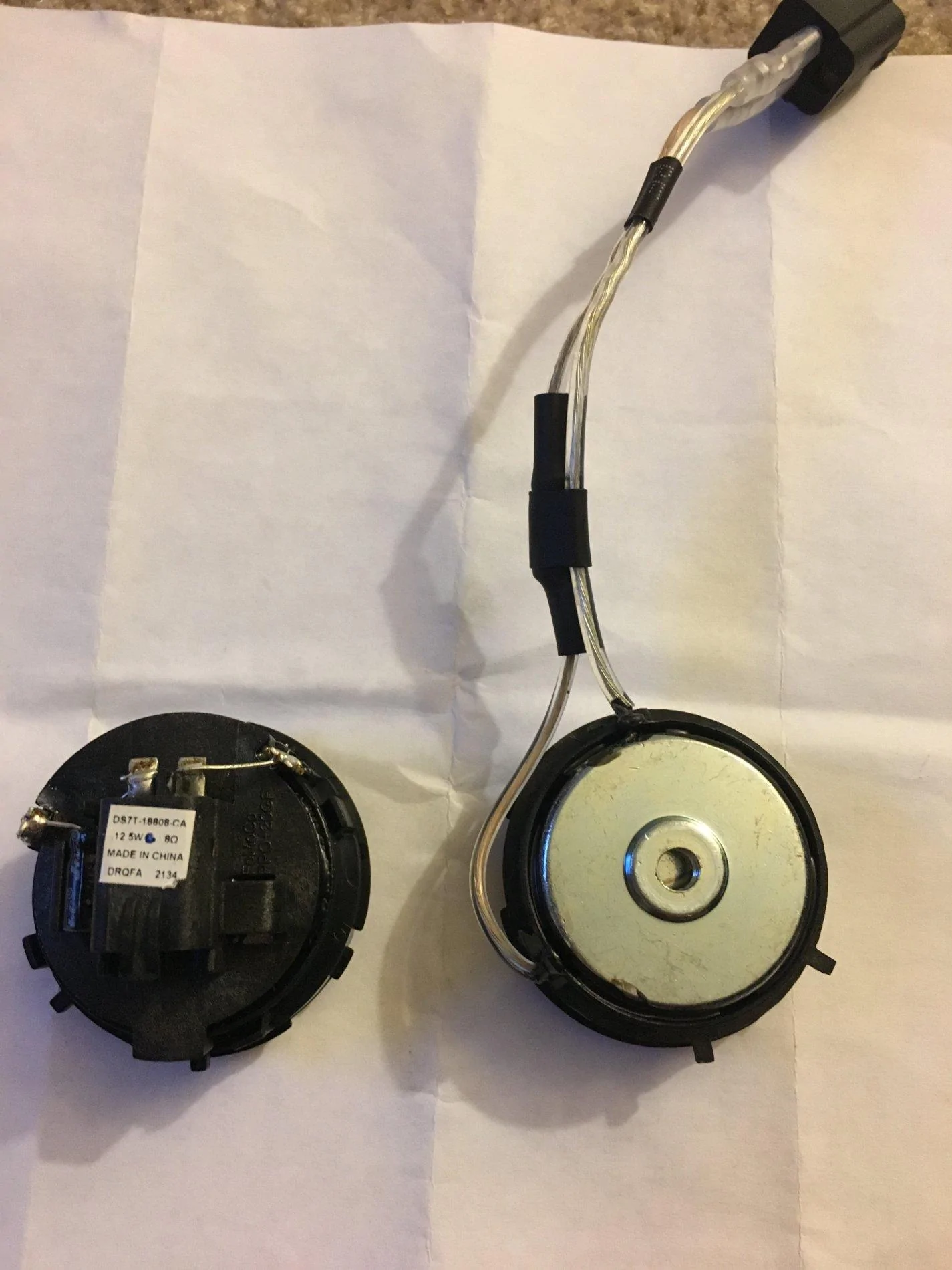

Alright found the photos for the tweeters. The Powerbass speakers were not labeled so I have a photo of the manual. The factory tweeter is labeled 8 ohms. The powerbass replacement states 4 ohms.

The tweeter sound allot better. In the photo you can see the capacitor that mounted inline from Powerbass. The factory did not have one. So all the sound when directly to the speaker.
