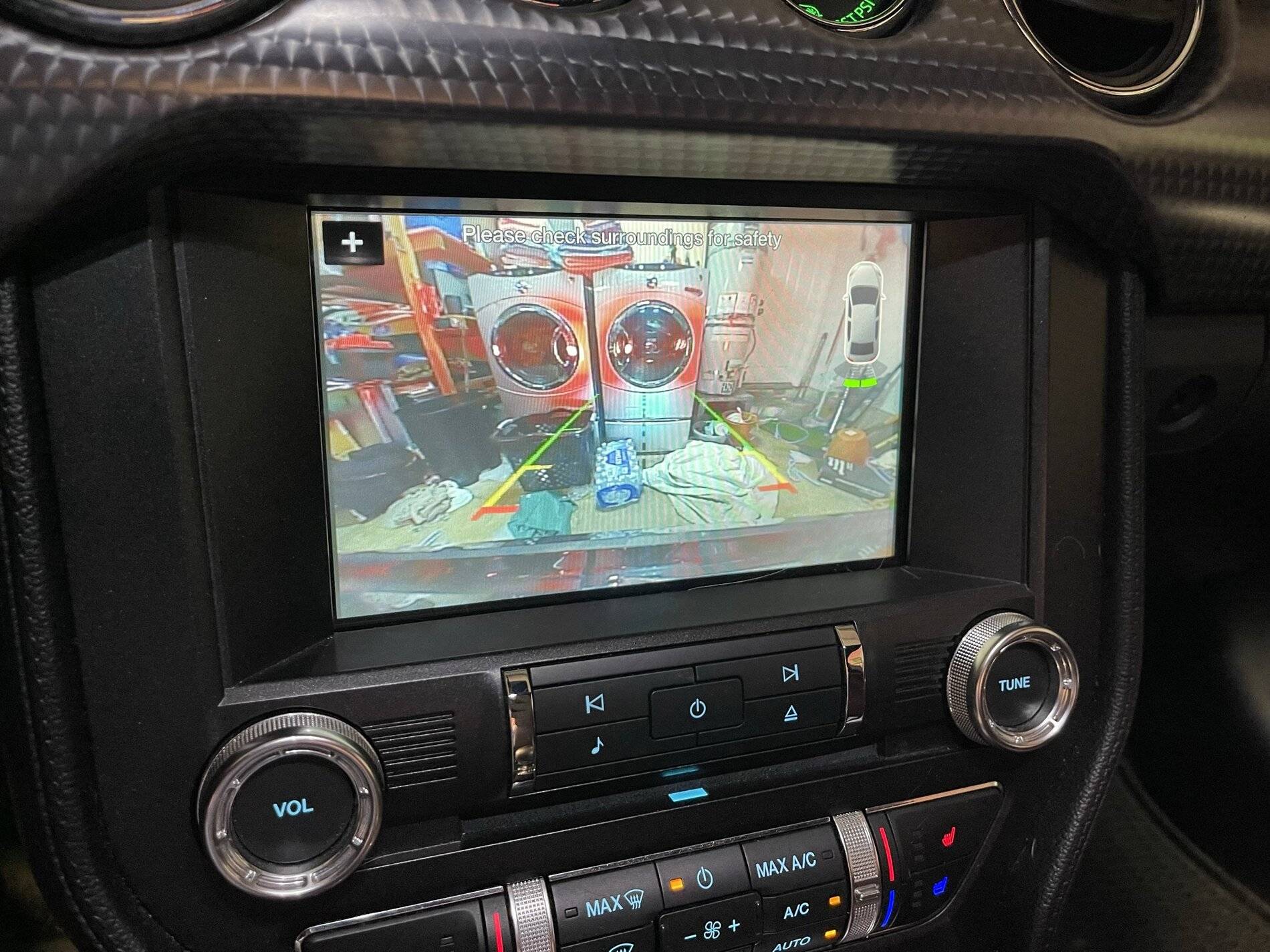

About a year ago, my 2016 EB started glitching the backup camera video feed (think trying to watch Cinemax after dark as a kid in 1989). The issue came and went, and earlier this year became more constant. I finally purchased a replacement camera, and installed it with little fuss.
The problem is now, the camera works beautifully, but I no longer see the parking guide lines, and there's no option to "zoom" the image. See photo attached.

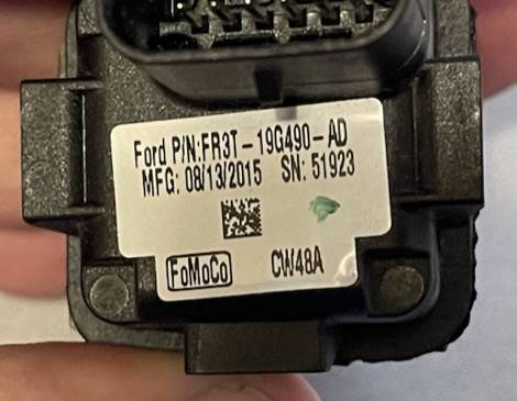

The camera I removed has a part number of FR3T-19G490-AD, and the replacement I bought (which I was told is a direct replacement) is FR3Z-19G490-A. Am I missing something here? My Vehicle Settings still show the option for the Advanced Parking Aids, and it's not a zoom issue (there's no buttons to even zoom in/out anymore).

You probably need to take it to a dealer to have the new camera configured with a scan tool.

Anything I can do on my own with ForScan or something else, or the dealer cost? Car is out of warranty, obviously?
