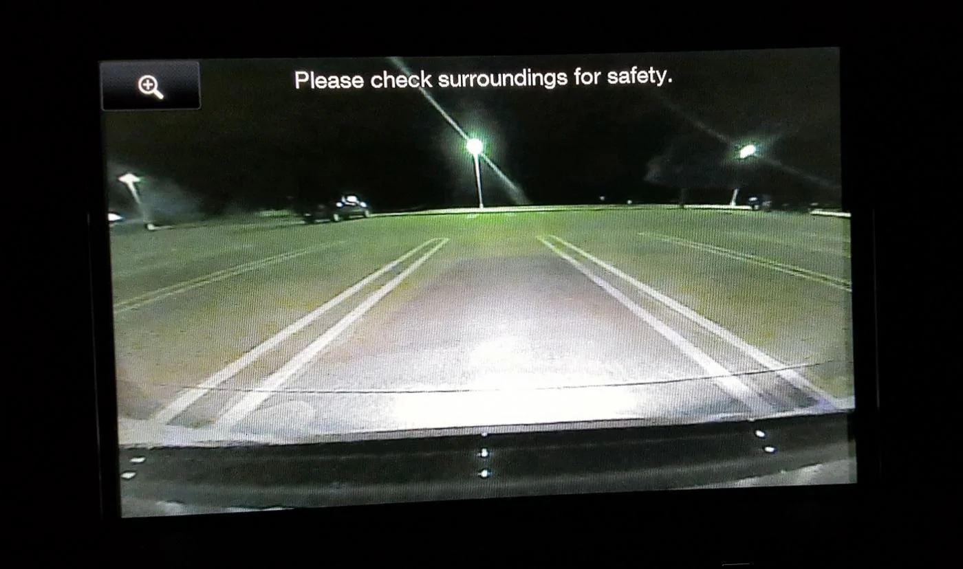

I have a 2015 Mustang GT Premium and there are no longer any backup lines at all. I have tried resetting Sync and that didn't change anything.

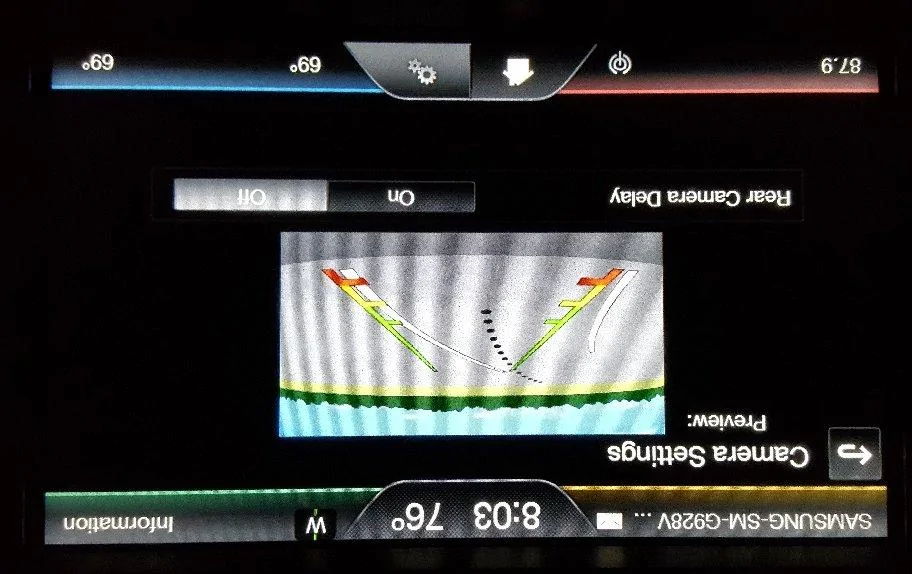

On my 2016 there is settings for turning off the lines,but I have sync 3 may not be the same.

Where would this setting be? The only settings i can change are these.

That's where my settings are I have camera delay and visual aids,Sorry man.hope someone with a 2015 chimes in.Good luck

Over the last several months when I would put the car in reverse, my backup camera, on random occasions, would either:
  • Display the image in black and white
  • Seem to have trouble displaying any image (and would show erratic static)
  • Or would be unable to connect at all, and display an image like "Camera inoperable. Please contact a Ford dealer"
I took it to a dealer, they were able to reproduce the issue, and replaced the camera (after Ford had shipped it to them). After I took the car back, I shortly realized that the guidance lines were no longer appearing on the screen, and the Zoom function wouldn't work. I took it back to the dealer, but they couldn't figure out what the issue was.
A couple of days later, they called me and said that a module that the camera connects to needs to be reprogrammed.
Has anyone else experienced these issues with their backup camera? Any idea what may cause it?
Found it. I had the camera replace about a week ago and just noticed the lines are not there and zoom does not work. Guess i have to take it back and tell them how to fix it.
