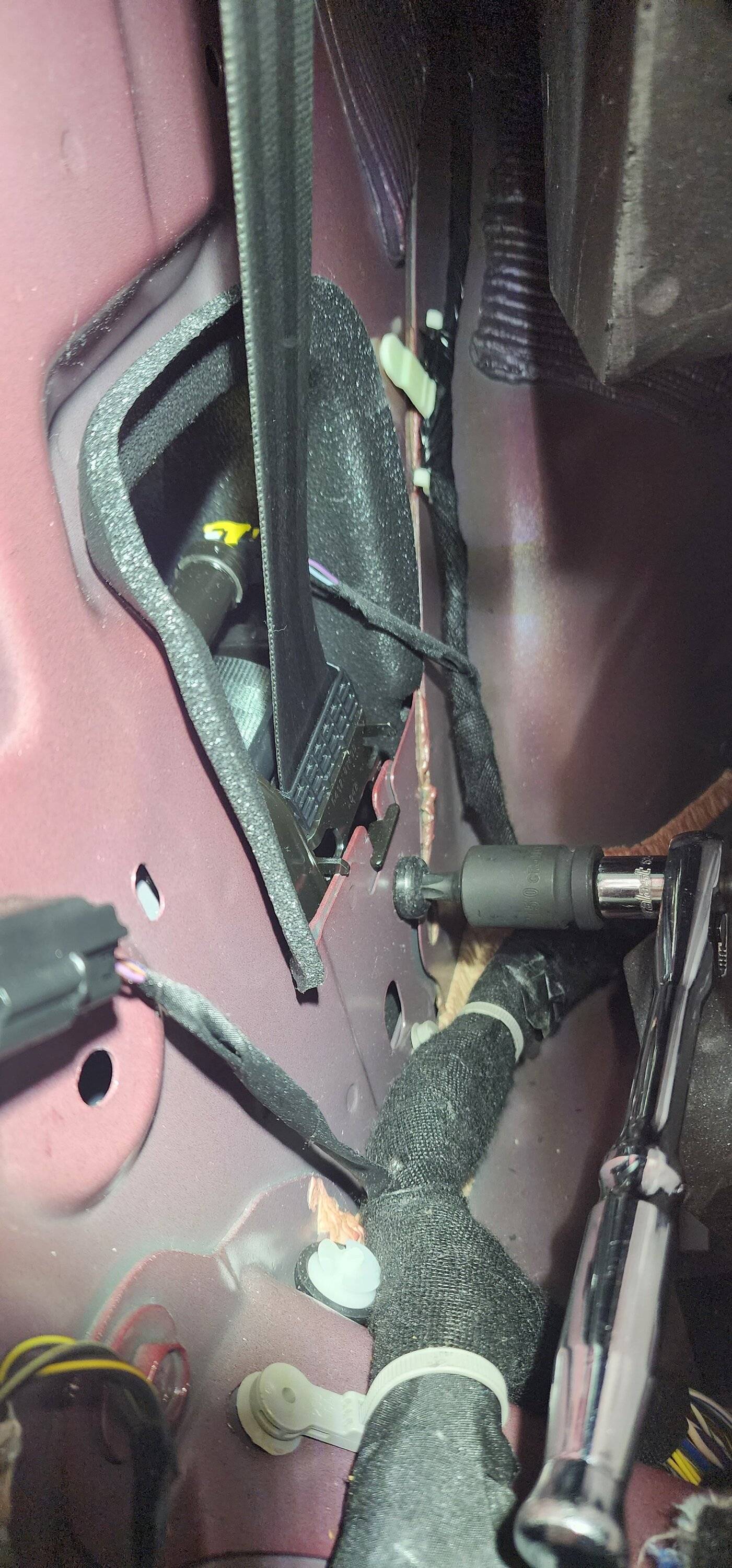

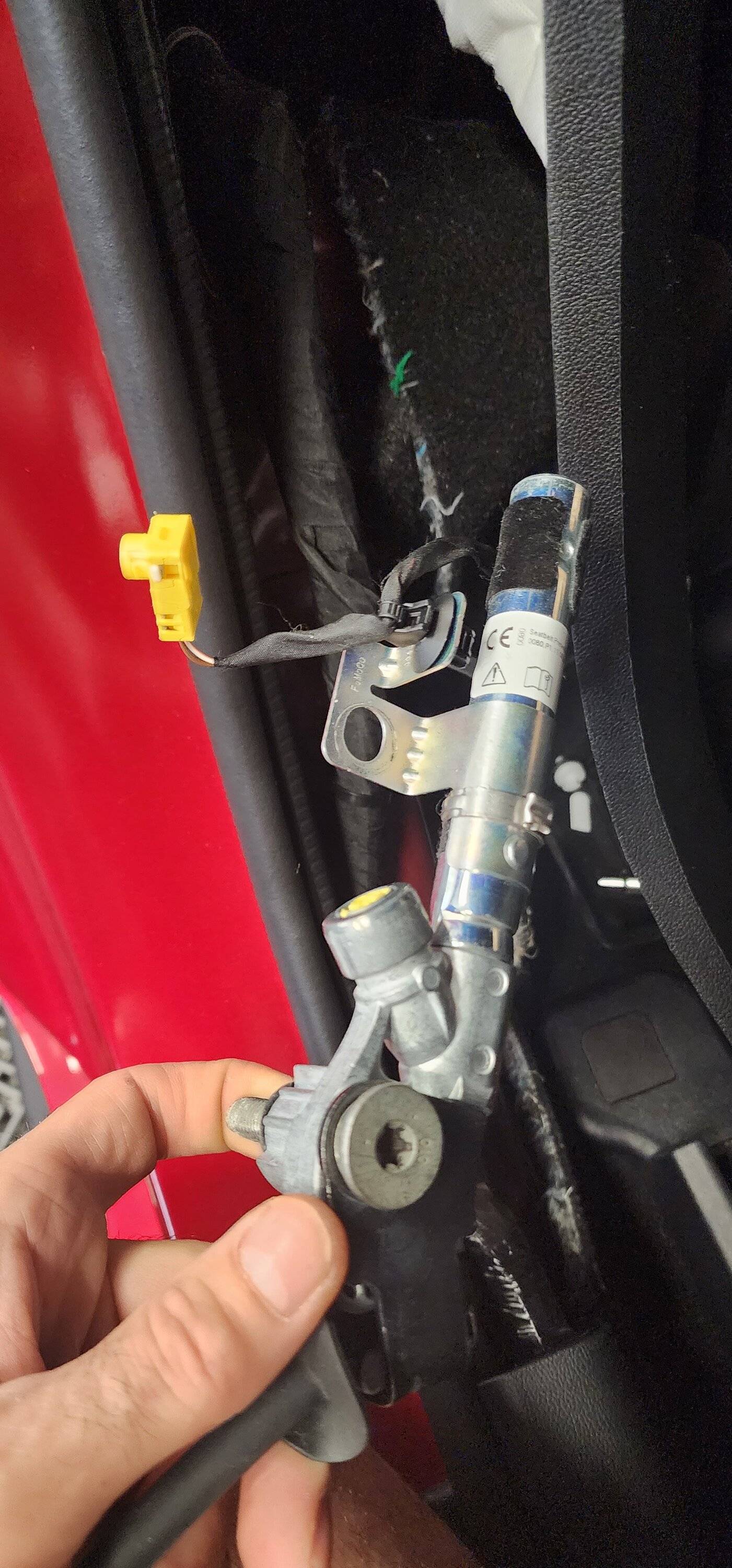

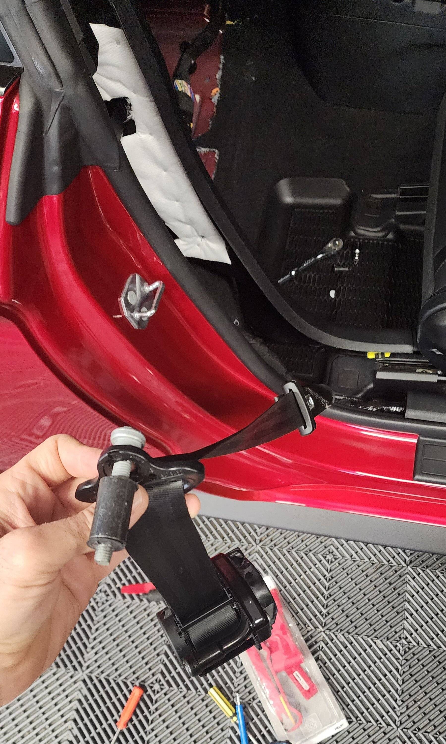

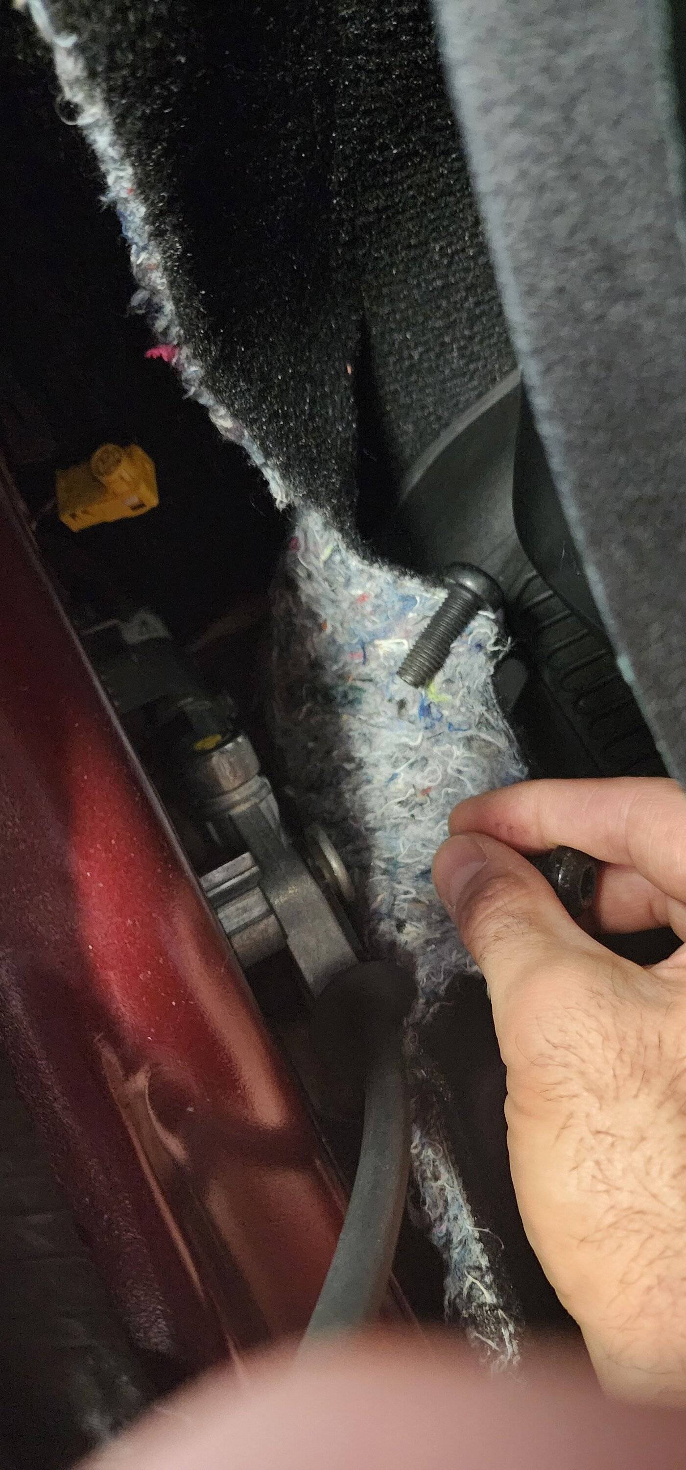

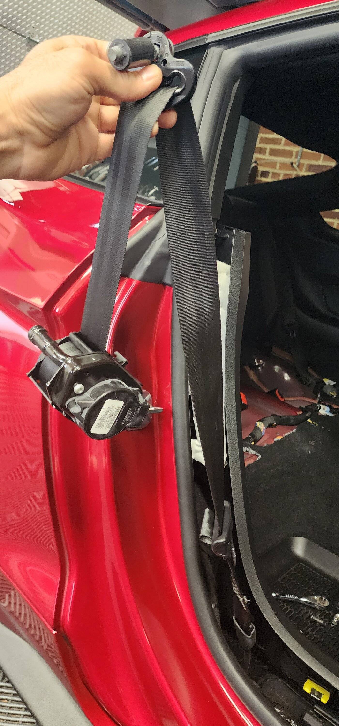

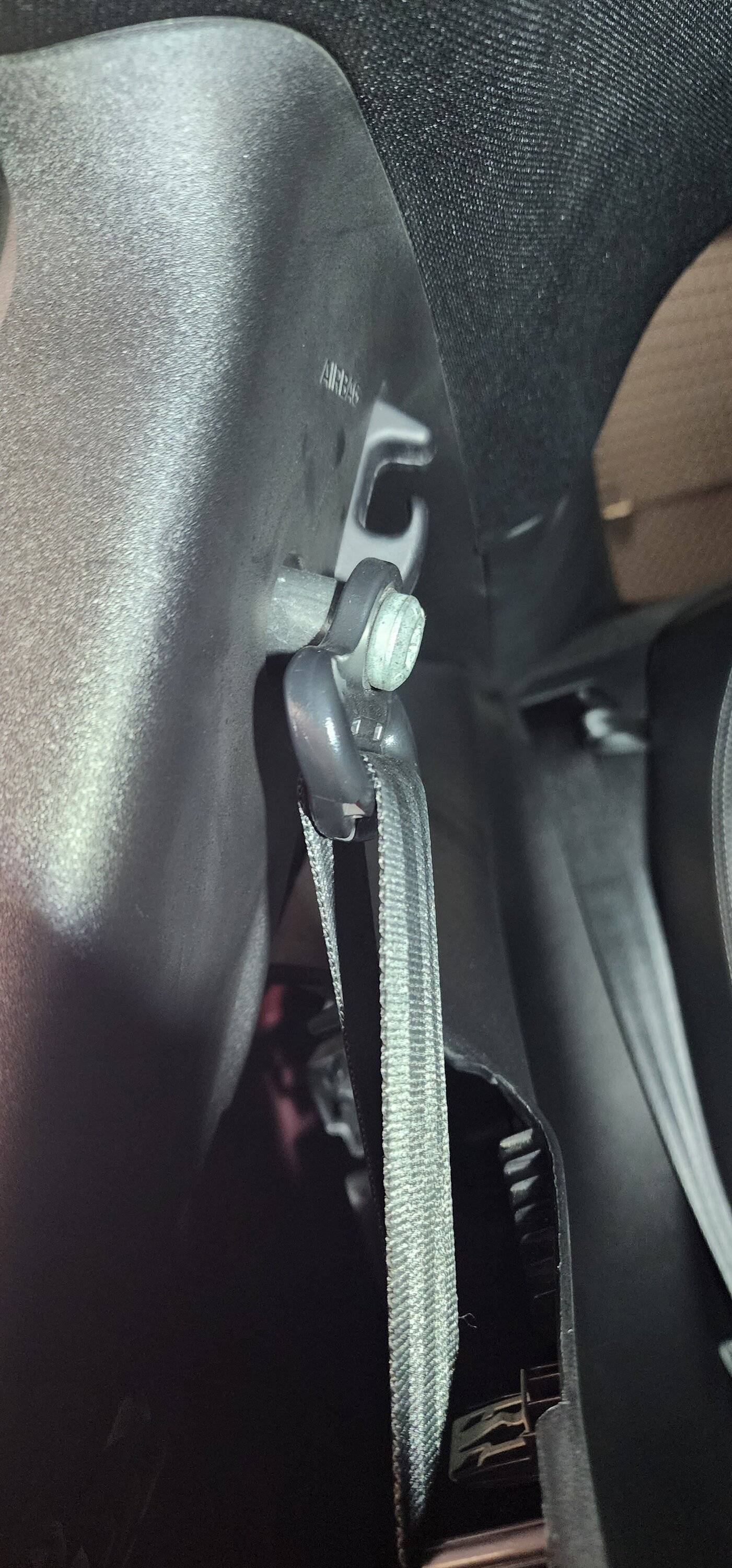

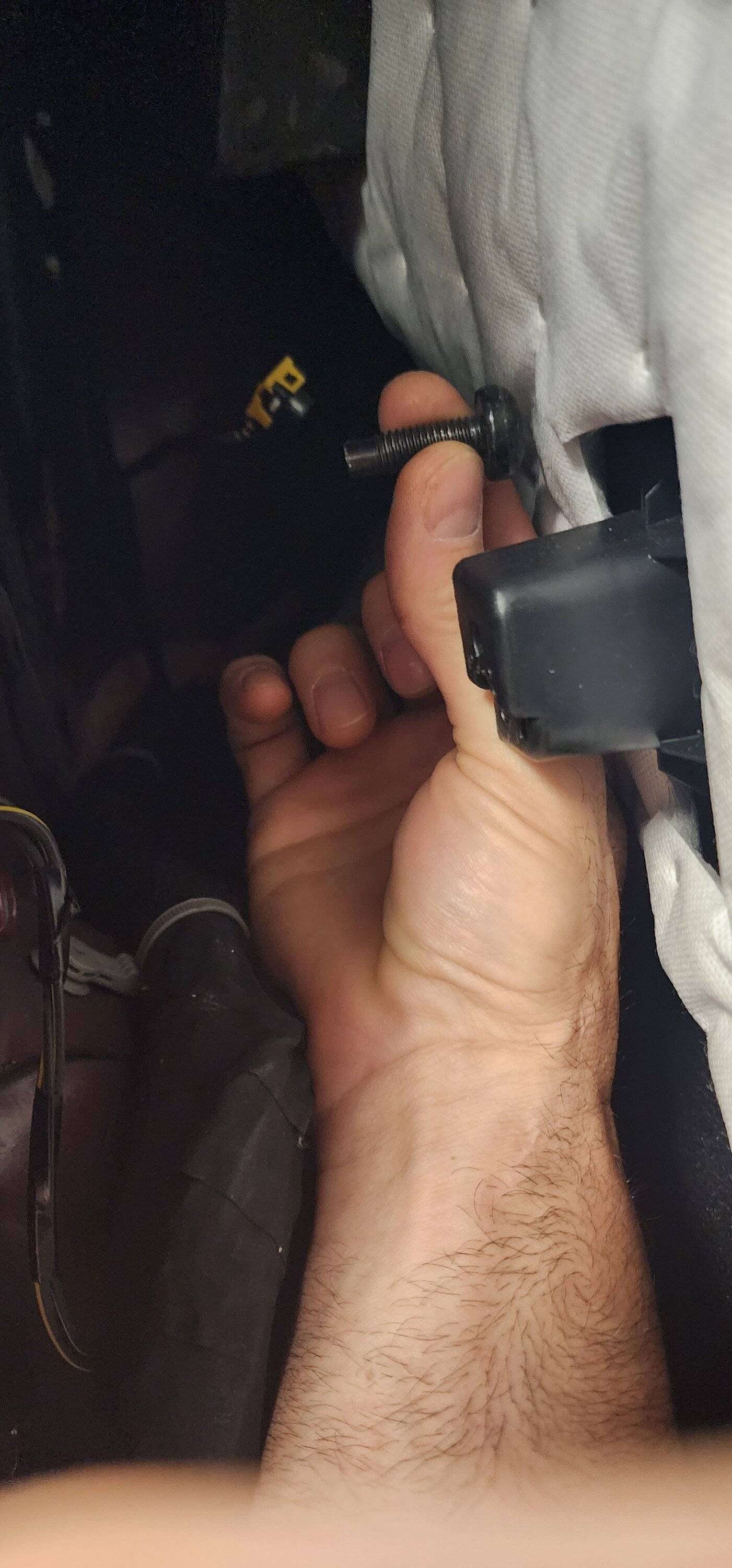

Yes, disconnect the battery. Pay attention to the 2 black bolts you remove. They look the same but are different. Take photos as you remove them so you know which is which. Also, the harness plugs connectors have a little tab you need to pop up to release. Don't force it. This short video shows you. We have #5.
It's a pretty easy project. Here are my progress photos I used to aid in reinstall..
