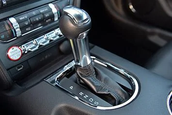

Anyone know how to safely remove the silver portion near the automatic shifter with the "sync" label? There is an annoying rattle that I need to fix, but can't figure out how to pop it off without damaging it. Don't want to randomly shove a screwdriver in there and attempt to pry it off.

Just pull up on it from the front. It's held in by the same clips as the dash trim.

Check this clip out:
[ame]
Skip to 1:05

Nice. Thanks for the help. What kind of tape is recommended to stop the vibration?
