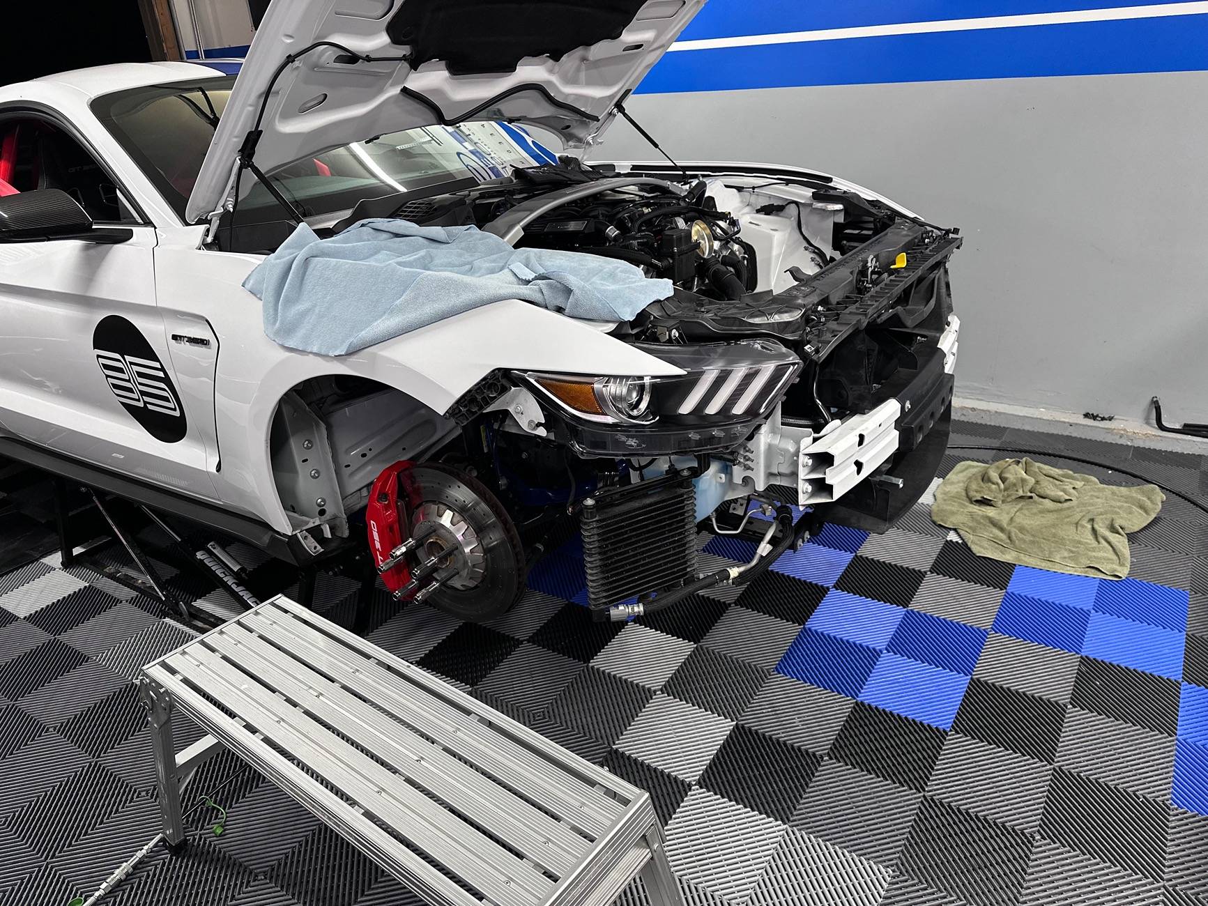

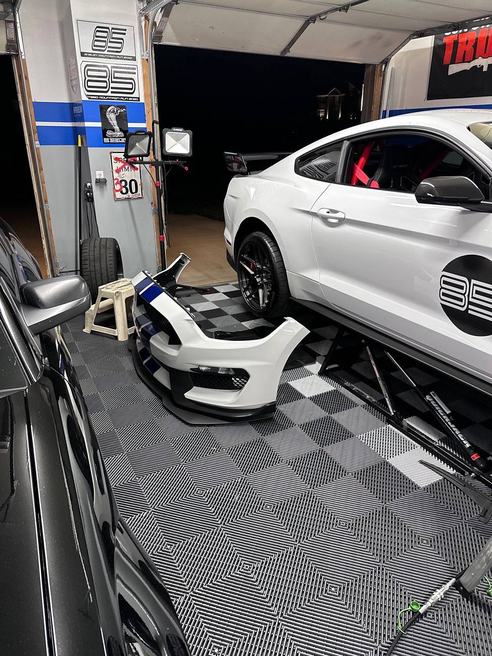

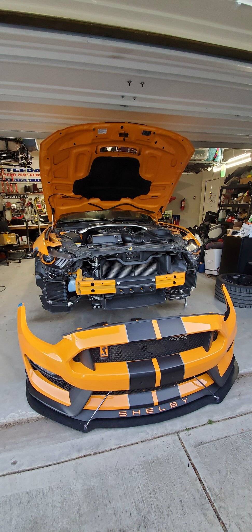

I will add this for the value tho — Aside from our current science project of separating the belly pan from a R splitter (or either one for that matter), if the options are separating the splitter or removing the entire pan/front assembly as one unit (as in my pic), the entire front assembly is far easier. I hate separating the R splitter.
mavisky
Nov 17, 2018
2,401
3,303
Cumming, GA
Kyle
2018 GT350
It may be slightly more bolts and push pins, but if your splitter is in place correctly then I think it's easier to remove the entire bumper. It's my default method.
