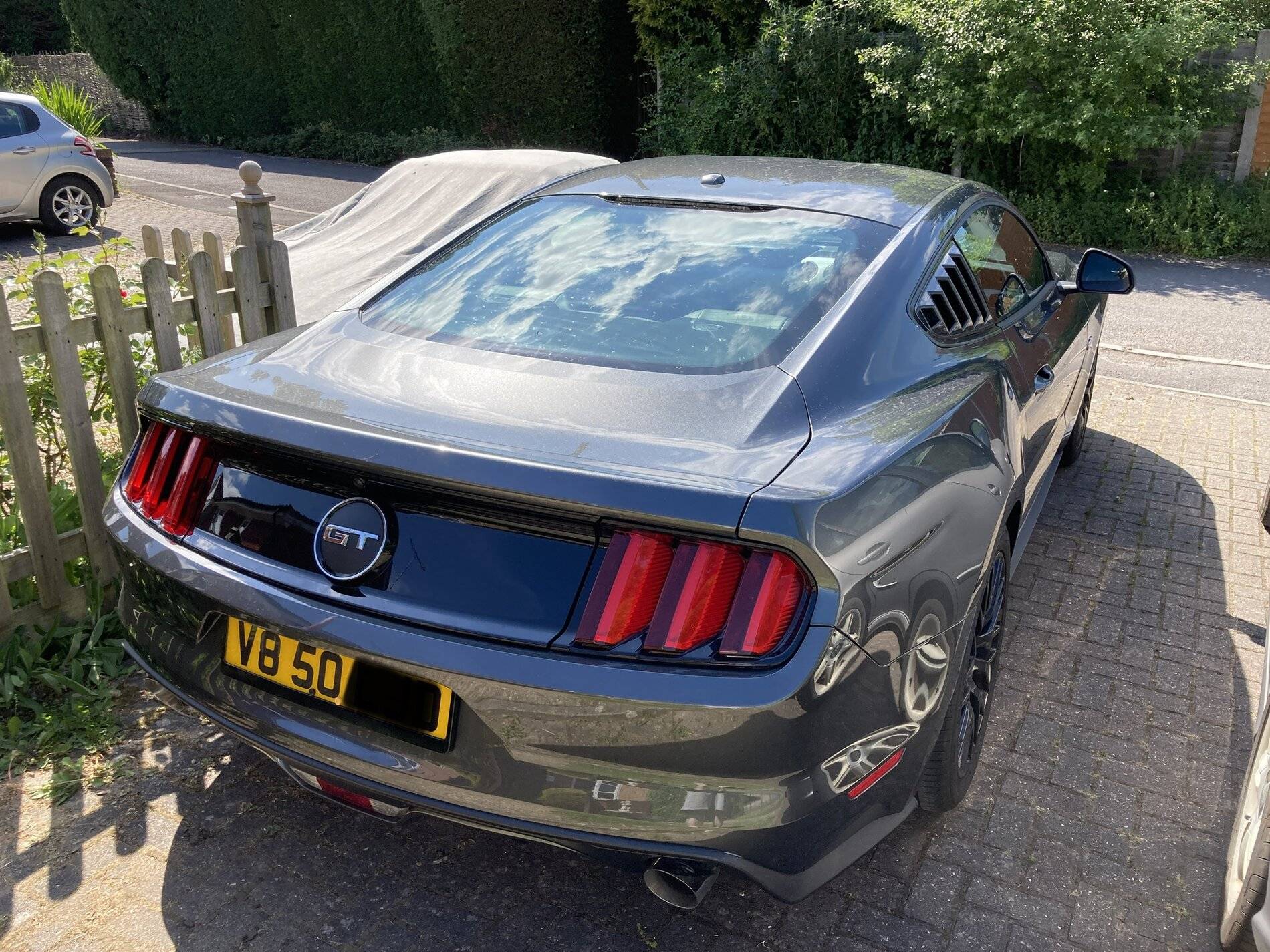

I wanted to do something different and miss how retro my previous S197 looked so decided to try to replicate a few more classic features on my S550.
I wanted to change to traditional red tail lights but found that this isn’t easy. Yes you can swap to US lights but the wiring, LED boards, connectors and drivers are all different. It’s not plug and play. Even if you buy expensive adapters you will still have no orange indicators meaning MOT fail and no payout if somebody rear ends you having not realised what US style flashing reds mean. You can pay about £800 for new LED boards to include amber LEDs to fit to US tail lights or even £1200 to have them fitted… but that’s insane!
You can stick on red tinted film but I don’t really like that option and find that it darkens the light from the LEDs too much again possibly getting you in hot water come a collision.
I wasn’t that bothered about the sequential turn signals I just wanted the traditional red lenses but with the U.K. functionality.

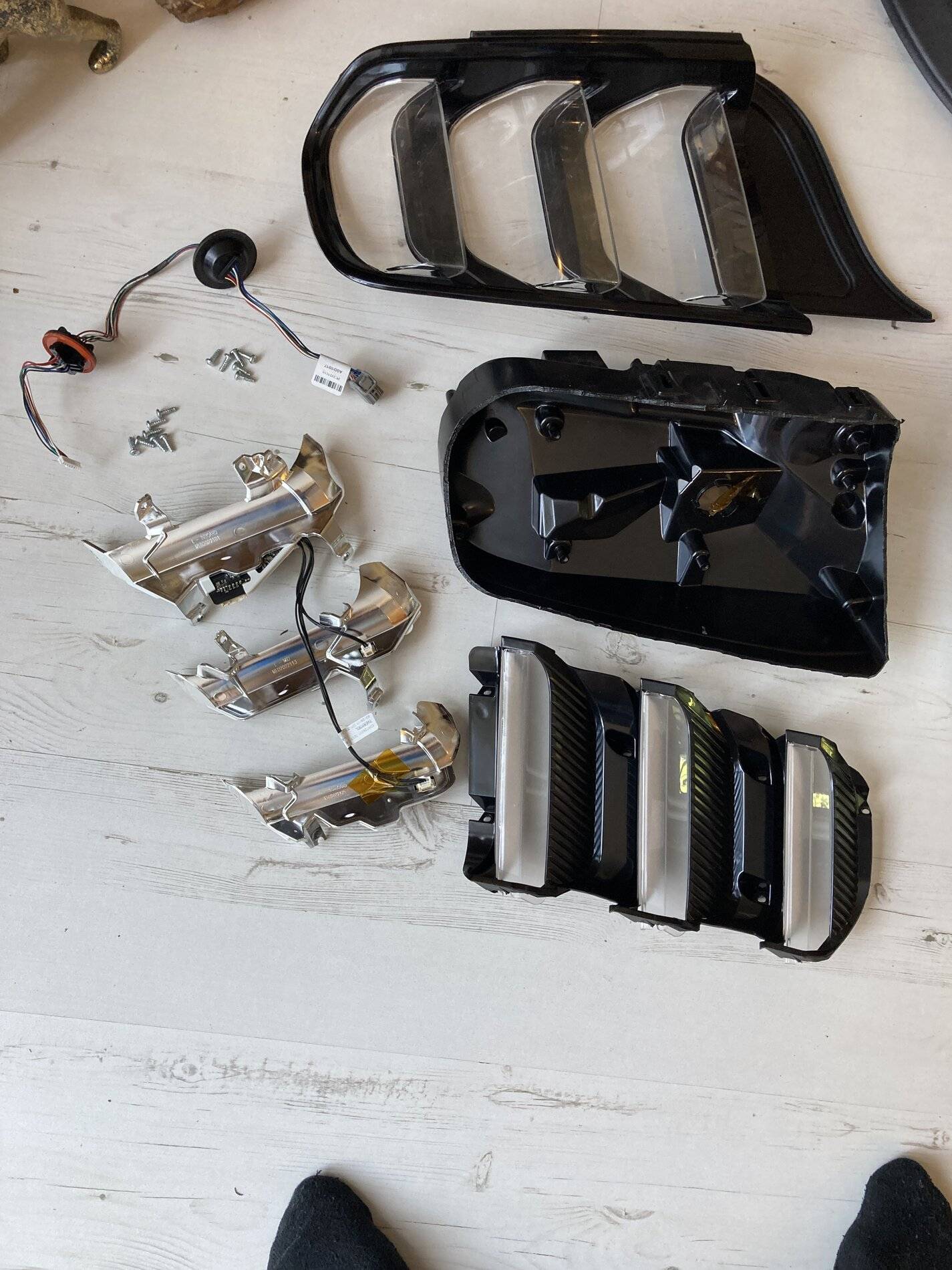

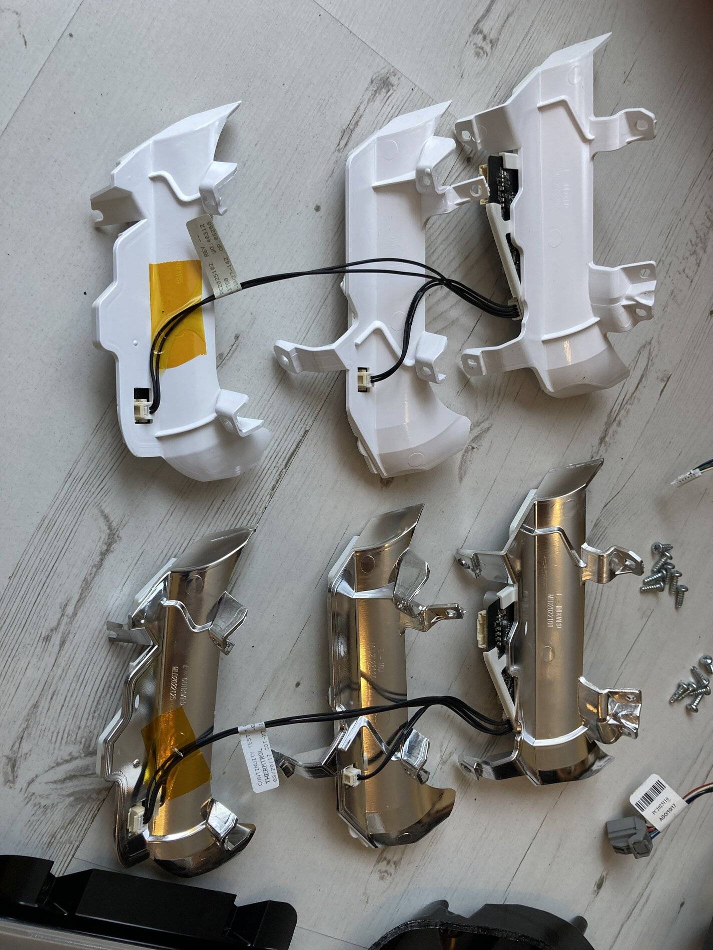

So I got a pair of used US tail lights for £300 and very carefully cut them open with a hot knife blade. I did the same to my Uk tail lights. Then I swapped the LED boards and wiring over. So I now have US tail lights with U.K. electronics. The lights were bonded back together and are nice and water tight.

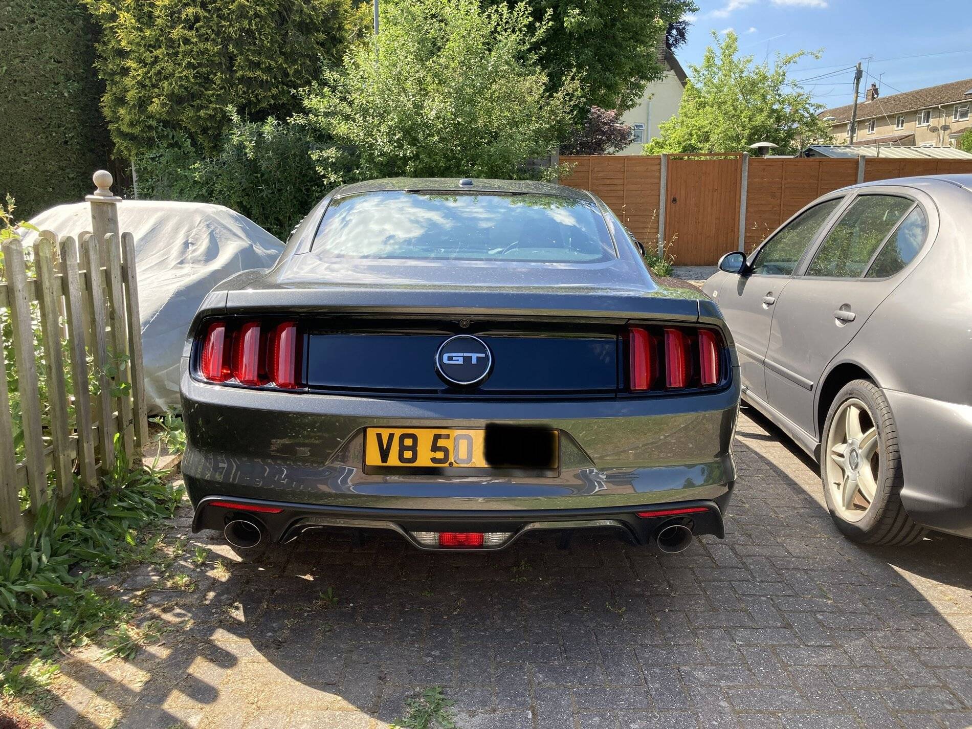

Fitted to the car you cannot see the cuts or new seal at all, even with the boot open. The U.K. LEDs shine through the red reflectors perfectly.
It’s not an easy process and you do have to be very careful but I love the result and am very glad I did it.
Here are the videos before and after. Please note the flickering is just due to camera frame rate, the lights don’t flicker in reality.
Before
After

why did you not just get your uk ones tinted? i think manders on here was doing tint kits for a while.
A few reasons:
The American lights have silver reflectors inside which increases the amount of light passing through the red plastic. By transferring these over with the LED boards I have got factory levels of brightness.
The videos above are taken in direct mid day sun yesterday so as bright as it gets which doesn’t do them justice.
If you tint the U.K. ones they have black reflectors so the lights will be dimer.
The several attempts at either painting or applying vinyl to U.K. lights I have seen have either looked a bit untidy or have dimmed the lights.
I wanted proper solid red plastic that is permanent and had the right reflectors in it.
Lastly tinting your lights just reminds me of black corsas with their rear lights covered in so much tint spray you can’t even see their brakes or indicators in daylight.

Also...have you thought about flogging your usa internals/euro outers back to someone in the USA? I bet they'd be an easy sell.
Thank you 🙂.

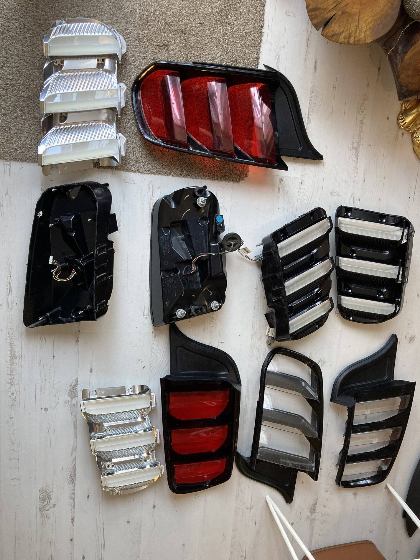

Yeah I have completed the opposite setup. So I have a set of U.K. clear lights with US internal sand plug/wiring etc which will fit straight on a US car and work like OE us lights but with clear lenses. Hopefully I can recoup what I spent.
The US lights I purchased from Germany via EBay. They were pretty good. One had a scratch but a cloth and a bit of tooth paste polished it right out.
