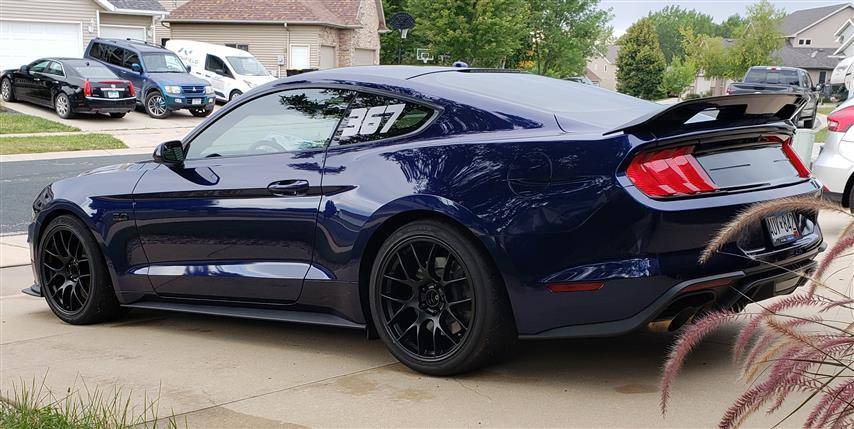

The extended studs were an easy change ... gives you rotation option. Apex is supposedly having a BF sale starting today ... here's mine in EC-7 satin black. Expect the price to still be $350ea or more.
