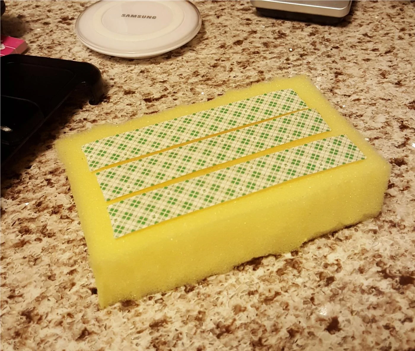

To create the foam pad I went to HDepot and found a sponge & double sided tape for under 10 dollars
Cut it down to measure 3x6x1.5 & apply double sided tape

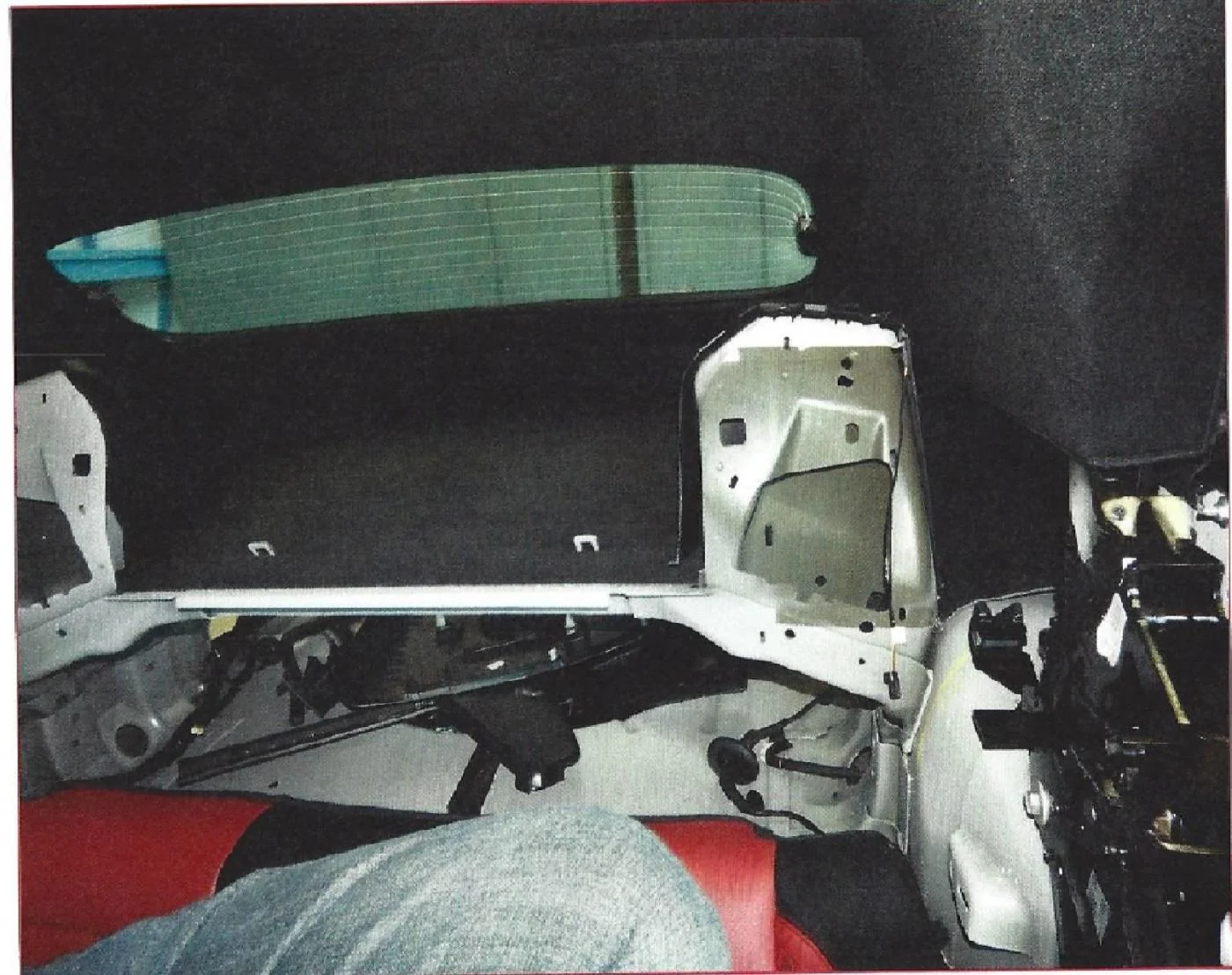

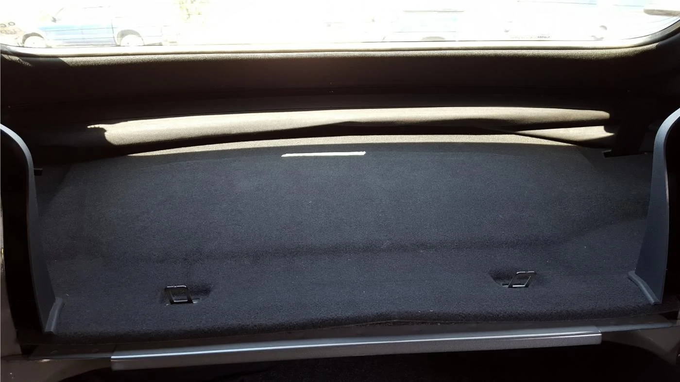

Start with removing the back seat bottom and back so you can access underneath the convertible top deck.Your rear seat cushion (where your butt goes) simply pops out of the car. There are two clips you have to press down to get it out. The clips are located just under the front edge of the cushion, one on each side. Push them and then pop the cushion out. Remove the two bolts one on each side of the seat back and then lift up on each side to unhook the seat back. At this point you now have access to place the foam under the deck.

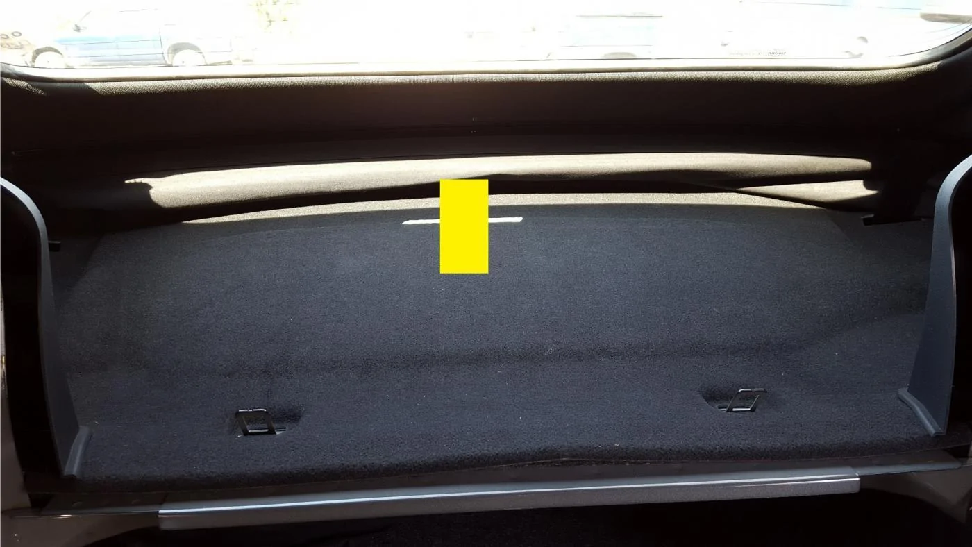

Location of the foam block is key, start by raising the top until the bottom of the back window touches the deck. Take a piece of masking tape and mark that point, now place the top back up.
Remove the double sided tape on the foam block and carefully reach between the deck and the covering. Place the foam long ways with the car so the foam is center to the tape mark as well as center to the car.

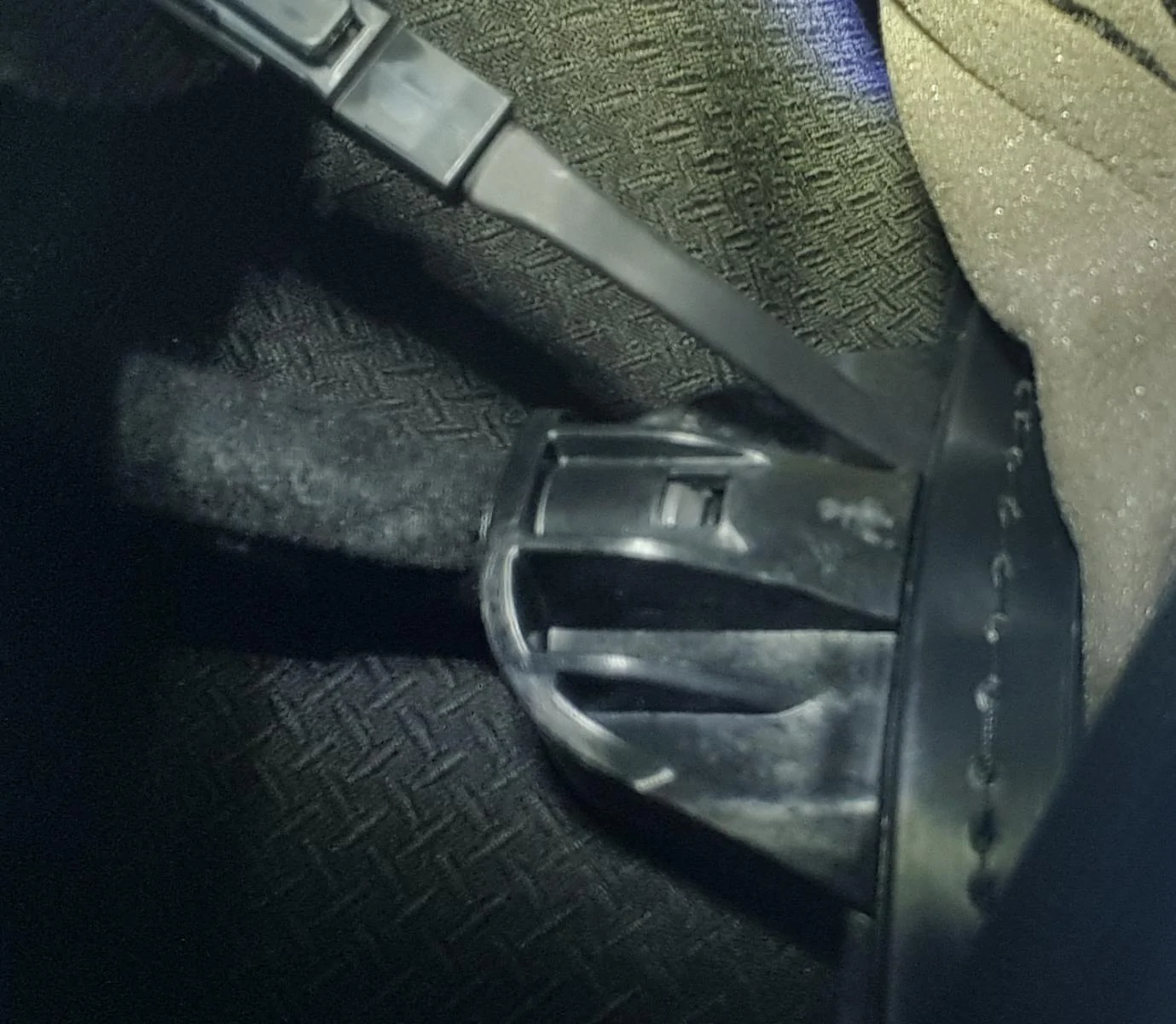

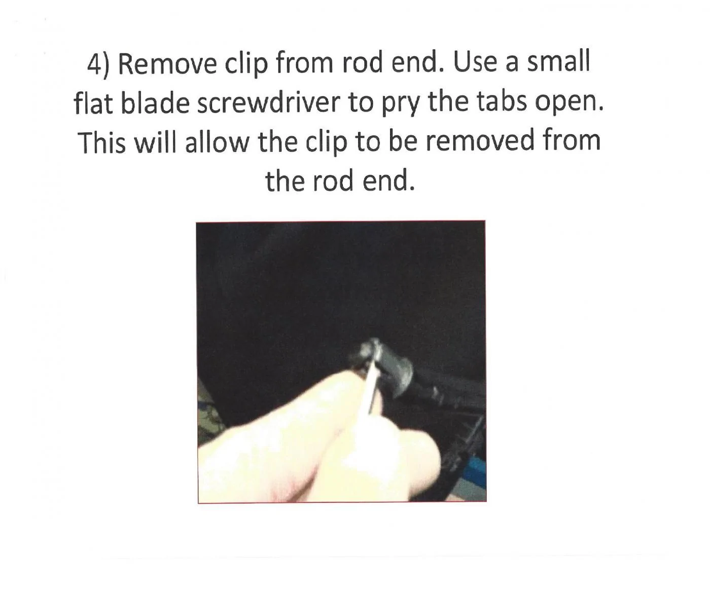

I needed to change both clips on the support brackets because the locking tabs on one side were broken off, the part # for each clip is FR3Z-76422B34-A

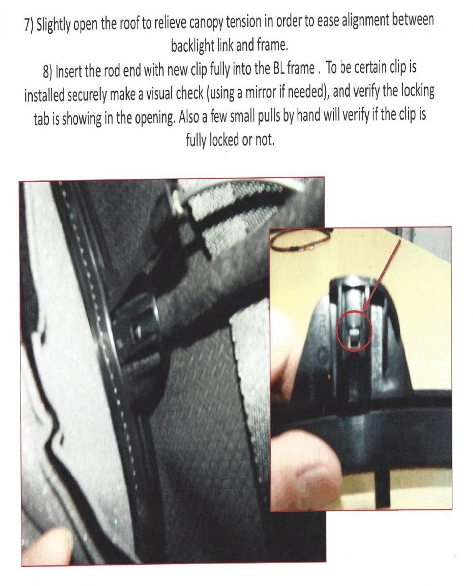

Cycle the top a few times to confirm the brackets stay in and then re-assemble the back seat.

So the foam goes under the carpet like liner of the area where the top folds into. It sits flat horizontally under cover oriented longs way (w/ length of car), right?
So what is the purpose of the foam? Does the window bounce up and down (unsupported) when down/stored in rear top area? Does this cause wear on the rod end clips to cause them to wear out?
Is the orientation of the clip attachment slots next to the glass (and opposite)?

I believe sometimes the glass simply does not know which way to fold or lay, the foam block is there to assist in directing the glass to fold/lay a certain way relieving the stress on the support bars.

The place marked by the tape (top of the raised window outline in carpet) is where the bottom of the window initially contacts the carpet, then it slides backwards a few inches. From the placement of your foam, it is assumed that the back (bottom) edge of the glass needs to be raised/ supported to keep the rod ends from being stressed and hence popping out. I had a larger piece of soft foam on hand so I made it wider than yours. It had a bevel on one side so I just duplicated it on the front side. I mistakenly did not take your instruction, have my larger piece of foam starting at and forward of the location of your masking tape. I was assuming more of the window needed support, but I see it may just be the back edge from your work.

I went for my appointment to a small local dealer to get my rod end clips replaced. [ I had already installed a 6" x 9" x 1.5" piece of soft foam under the lining three weeks ago. Amazingly, both rods remained in, even though the psgr side clip had only one of the two tabs left (I had placed the 3/4" straps 'outside' of the rods thinking it would keep them held in). A testament to the foam as I had the straps outside the rods for weeks prior and the passenger side still popped out.]

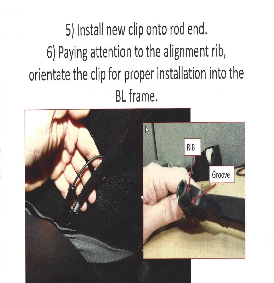

At the dealer, I already had the seat back and bottom removed. The tech came out to where I was with the clips. As I described exactly how he needed to orient the clips (12 & 6 o'clock relative to the window bracket), before inserting, he said he had never worked on a convertible top and since I knew how it was done, would I like to do it. I said yes, please. ;)

Did they show you the kit by chance? I'd ask to speak to the tech who worked on the car. Did he place the foam in the proper location? Was he sure to orient the rod end clips so they audibly clicked into the window bracket? (at 12 & 6 o;clock where 12 o'clock is closest to the glass).
The tech that came out to my car with the clips in hand, hearing me describe exactly how to install the clips, asked if I wanted to install them since I had done it many times. I said heck yes. He said he had never worked on a vert top. They usually send anything top related out to a vert shop.
