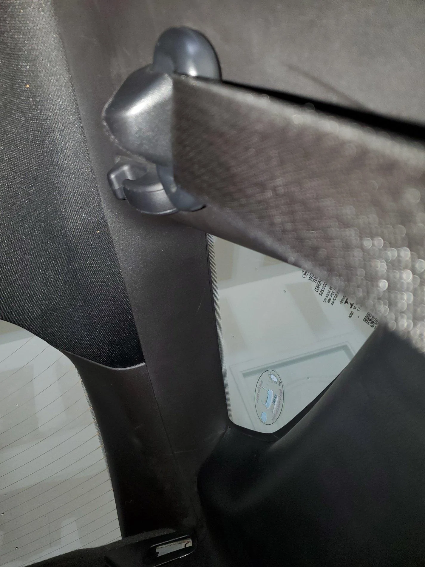

Has anyone had any issues with the rear window leaking water? I was caught in some heavy rainfall earlier and both sides appear to leak (passenger side more than the driver's).

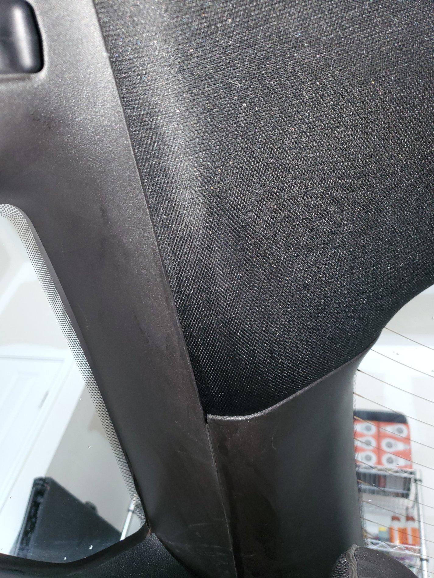

I looked at the trunk but I didn't see anything in there. It's on the roof near where the seat belt connects, where the plastic and the cloth meet. Not sure if you can tell where it's wet or not in the photos.

Looking at your pics - it could be the 3rd brake light assembly.
Another member also had water leaks and was able to determine it was coming through the 3rd brake light area.
See his DIY thread:
https://www.mustang6g.com/forums/threads/issue-with-third-brake-light-water-leak.97131/
I would mention it to your Service Writer to check that area as well (just in case and so you’re not making another trip back if the roof antenna was not the source).
