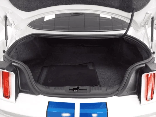

The funny story is that my 19'GT350 start making squawky noise too going slow over uneven roads. I refused to accept the fact that one year car have problem with any of suspension parts. So, I start with simplest I can think of where this sound can be coming from. My first guess was rear seats. But it wasn't. Than I inspect trunk area. The black rubber seal which goes around the trunk and trunk door rubbing against each other is what made that noise. I put some silicon lube around the rubber seal and the noise disappeared. Let me know if it works for you.

Hey lenFeb - well that seems like it's worth a shot! Did you pull the rubber seal up and put it underneath or did you just put it on the outside of the seal where it contacts the trunklid?
Just put it on the outside where it contacts trunk lid.
