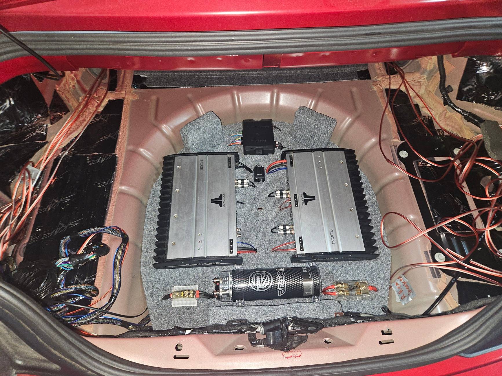

This is where im at right now..

Have any 2-3" holes in the bottom of that mounting panel under amps and spacers between amps and panel, for convection flow? It's easy and fast, and hugely beneficial, especially if get some holes elsewhere on the mounting panel for lots of air flow. Also cuts weight a fraction:)
