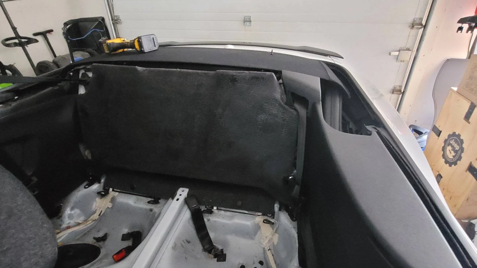

I could find one for a vert and thought let me see what I can do... then said wtf am I doing this for? Haha.

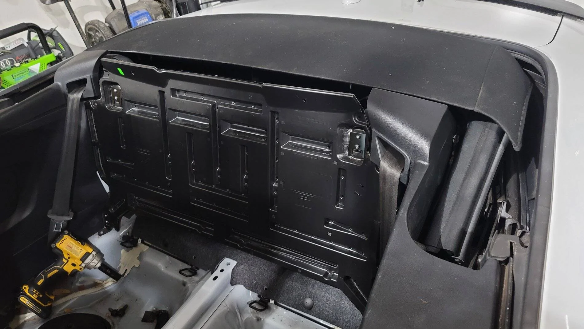

I removed the seats and then took the back seat apart to reuse the frame. I wanted the gap under it so I can put me an 8" sub in.

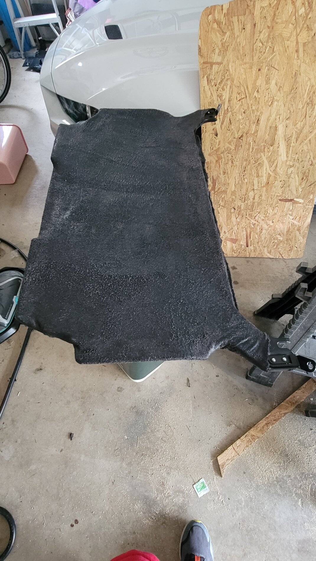

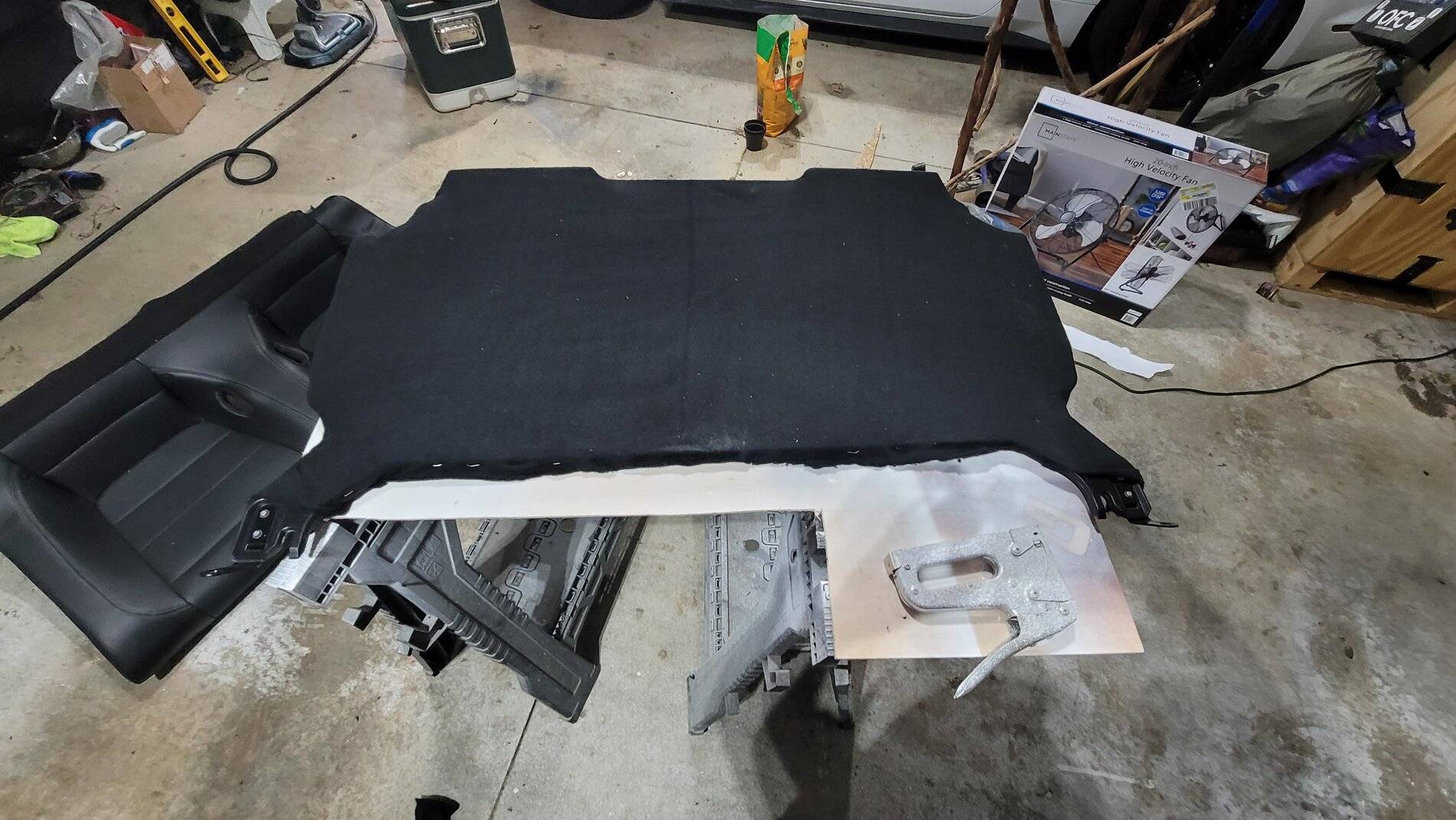

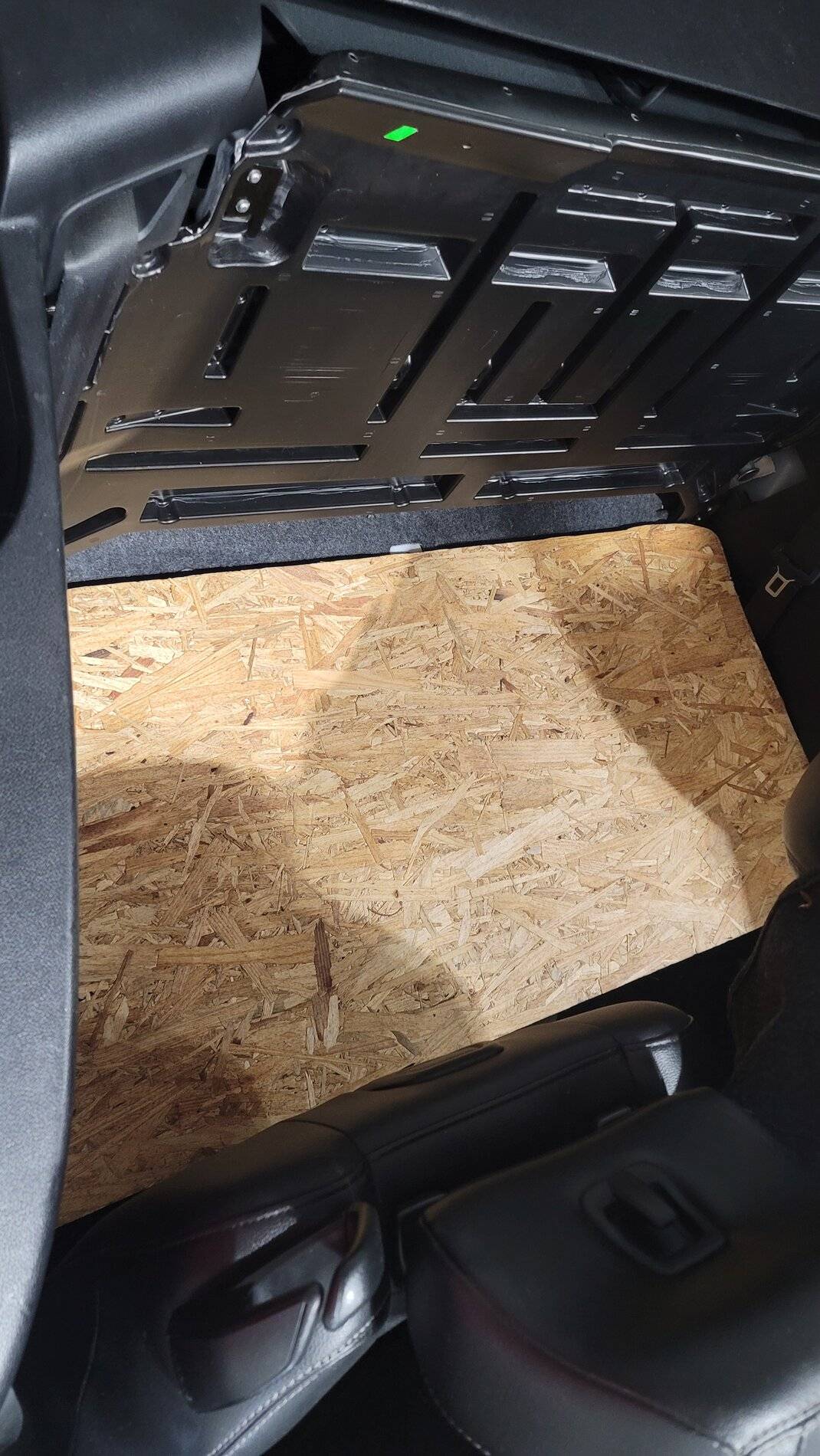

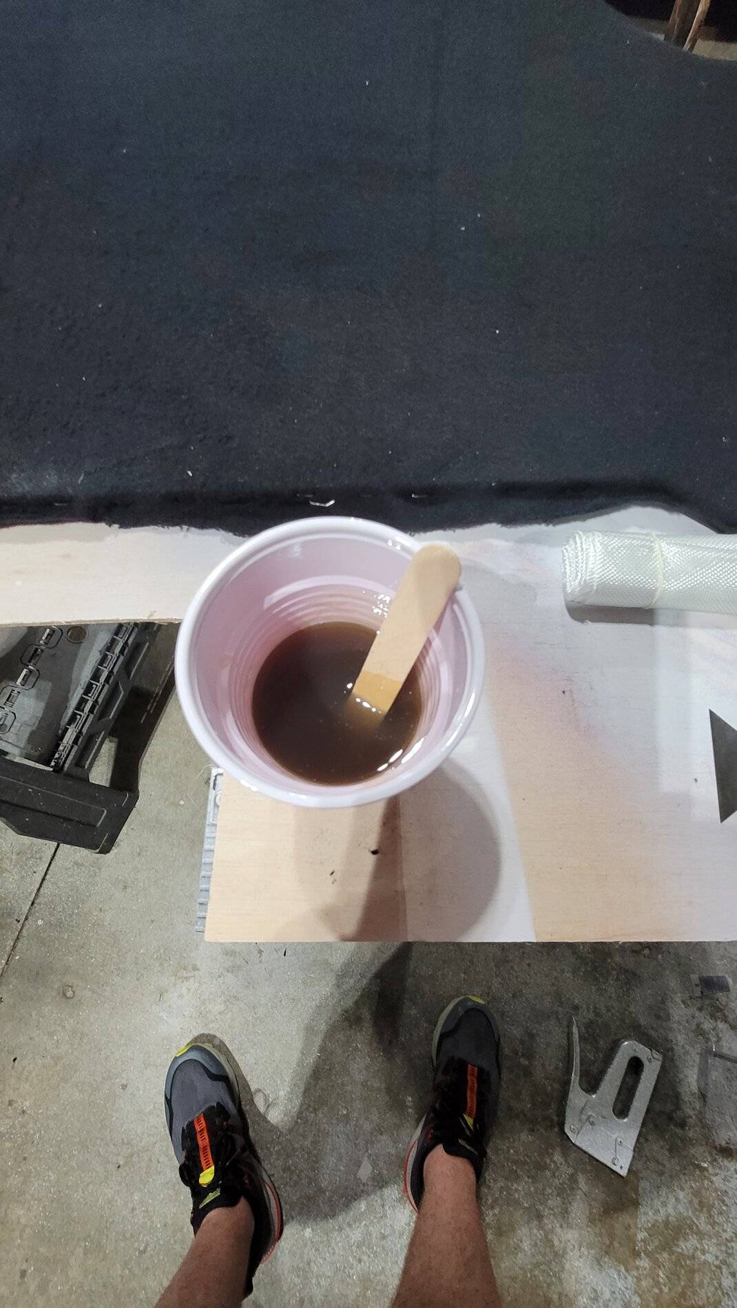

Once I had it torn apart, I used black fleece and stretched it across the front portion of the seat back and used resin to harden the fleece. And that is where I am at for now. I did trace the bottom seat on a board and cut to make sure it fits. I'll update as I move along. Might be a while... it is so humid!!
