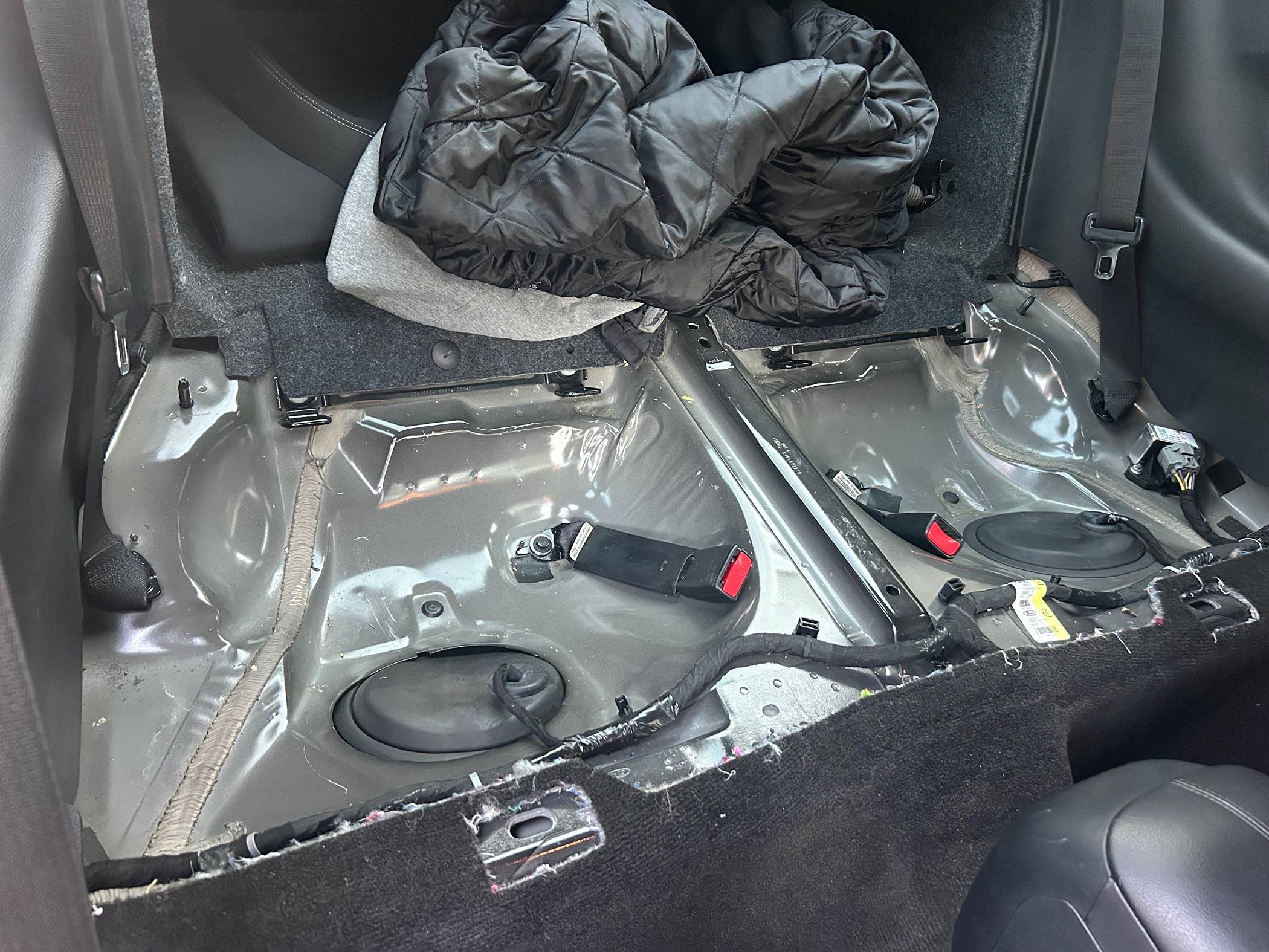

Hello everyone, I’m new to the forum. I just bought a 2016 Mustang GT. I absolutely love the car, my only issue is it came with the rear seat delete. My four year-old daughter likes to go everywhere with me, so I’m going to need that backseat. The car came with the seats, but they misplaced the bolts. It has the bracket that goes between the seats, I’m assuming that’s the only one. I’ve searched everywhere I can think of just buy the bolts, but I can’t find them. Does anyone know the info on them so I can match it up at my local hardware store? Any help would be greatly appreciated, thank you!

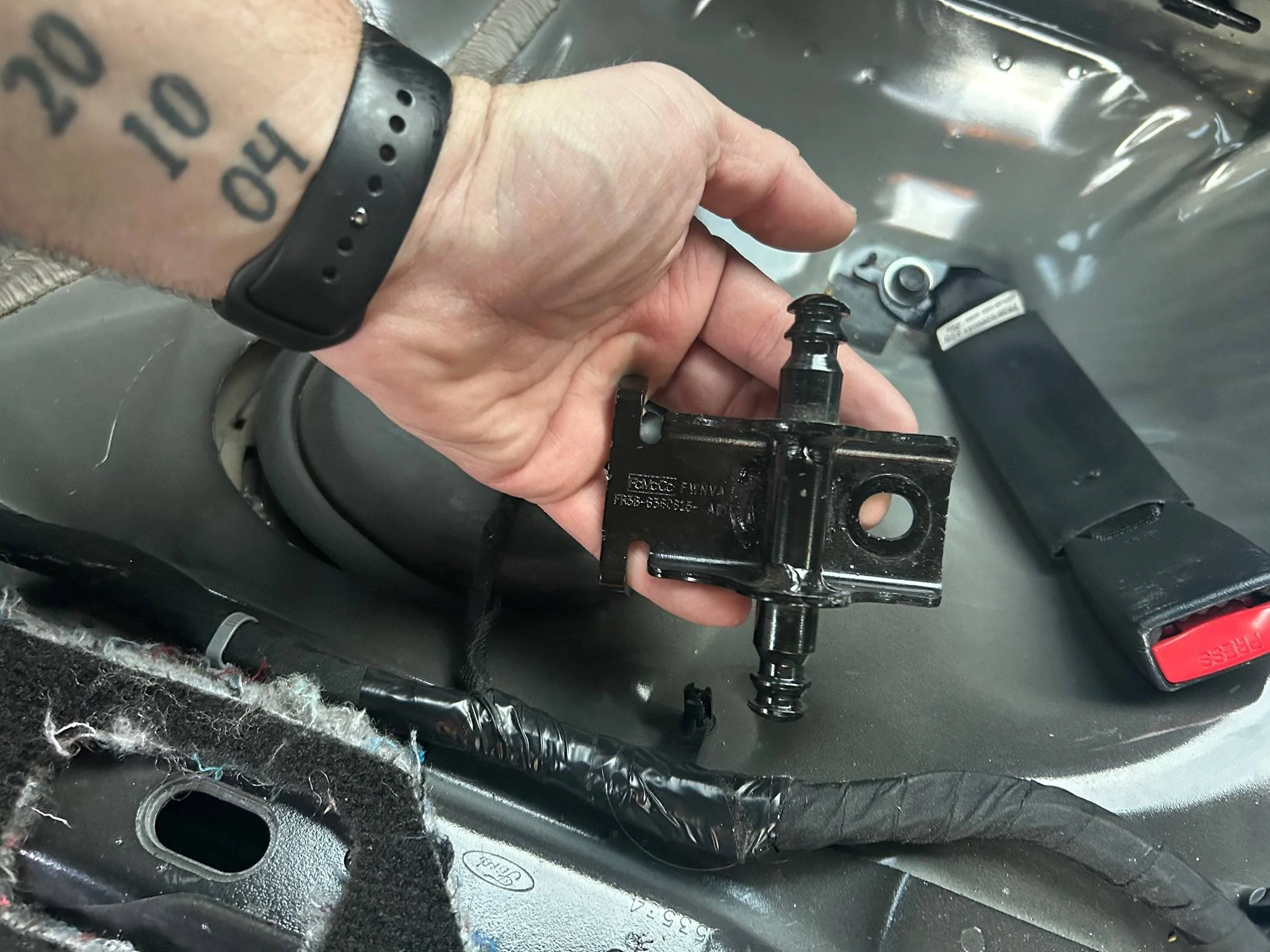

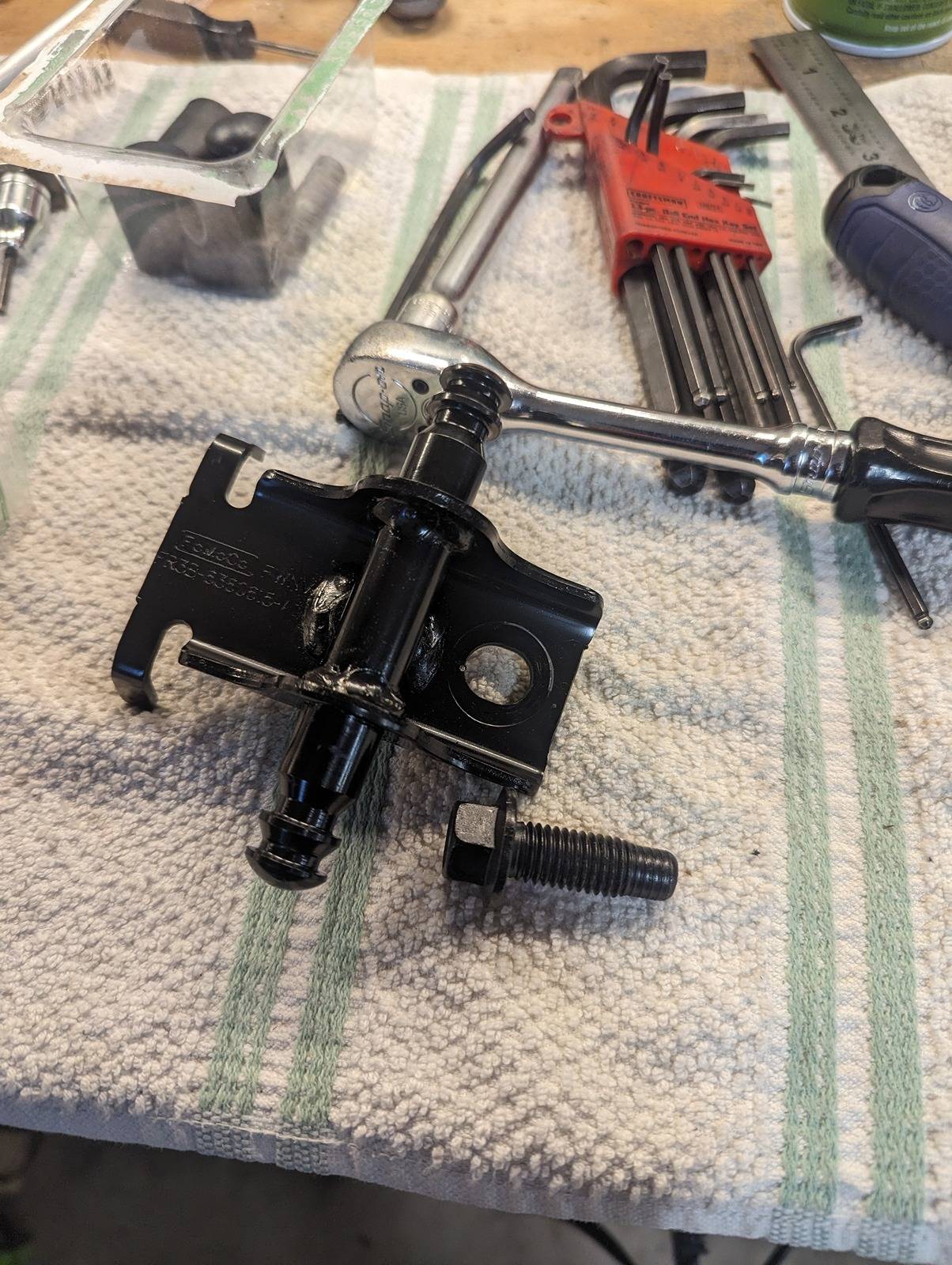

Is this the bracket?
This is off my 2021 M1, so might be different. This is an M12x1.75, 10.9 strength. Looks to be about 35mm long. That's a flanged bolt, so if using a standard head 10.9 bolt, be sure to use a 10.9 flat washer.

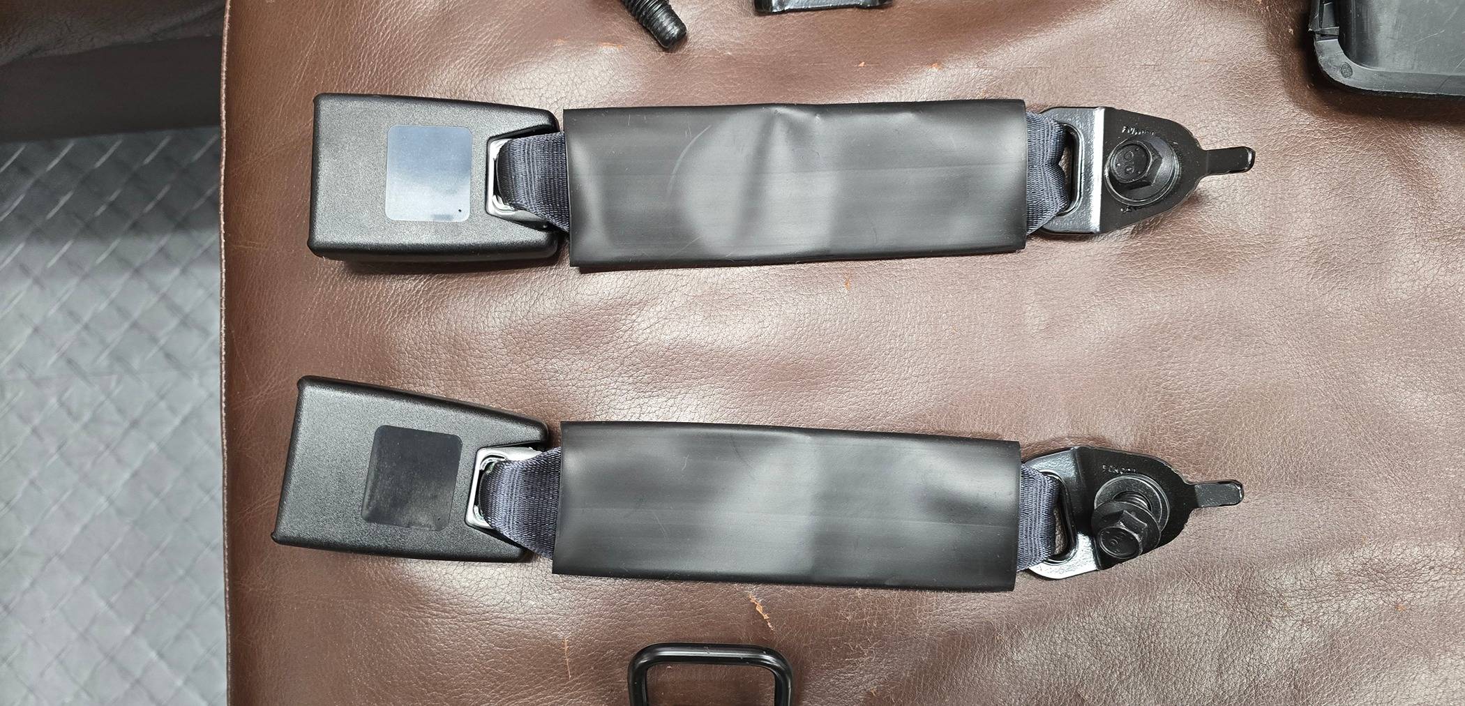

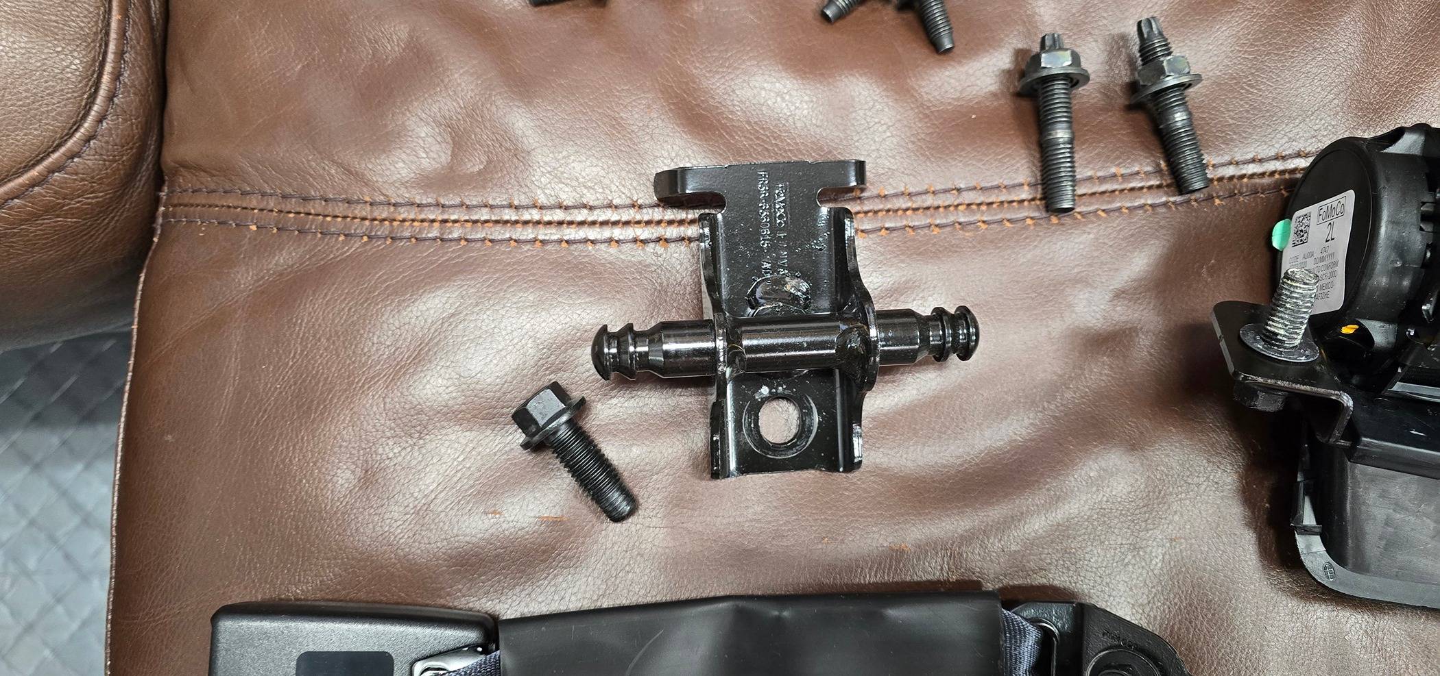

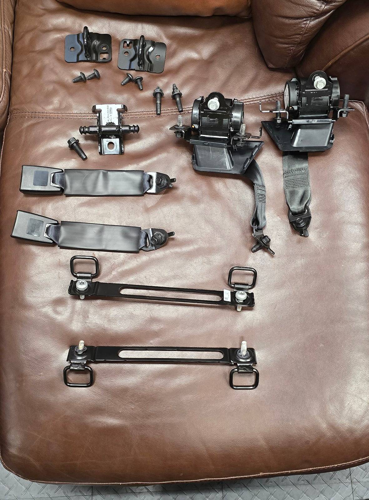

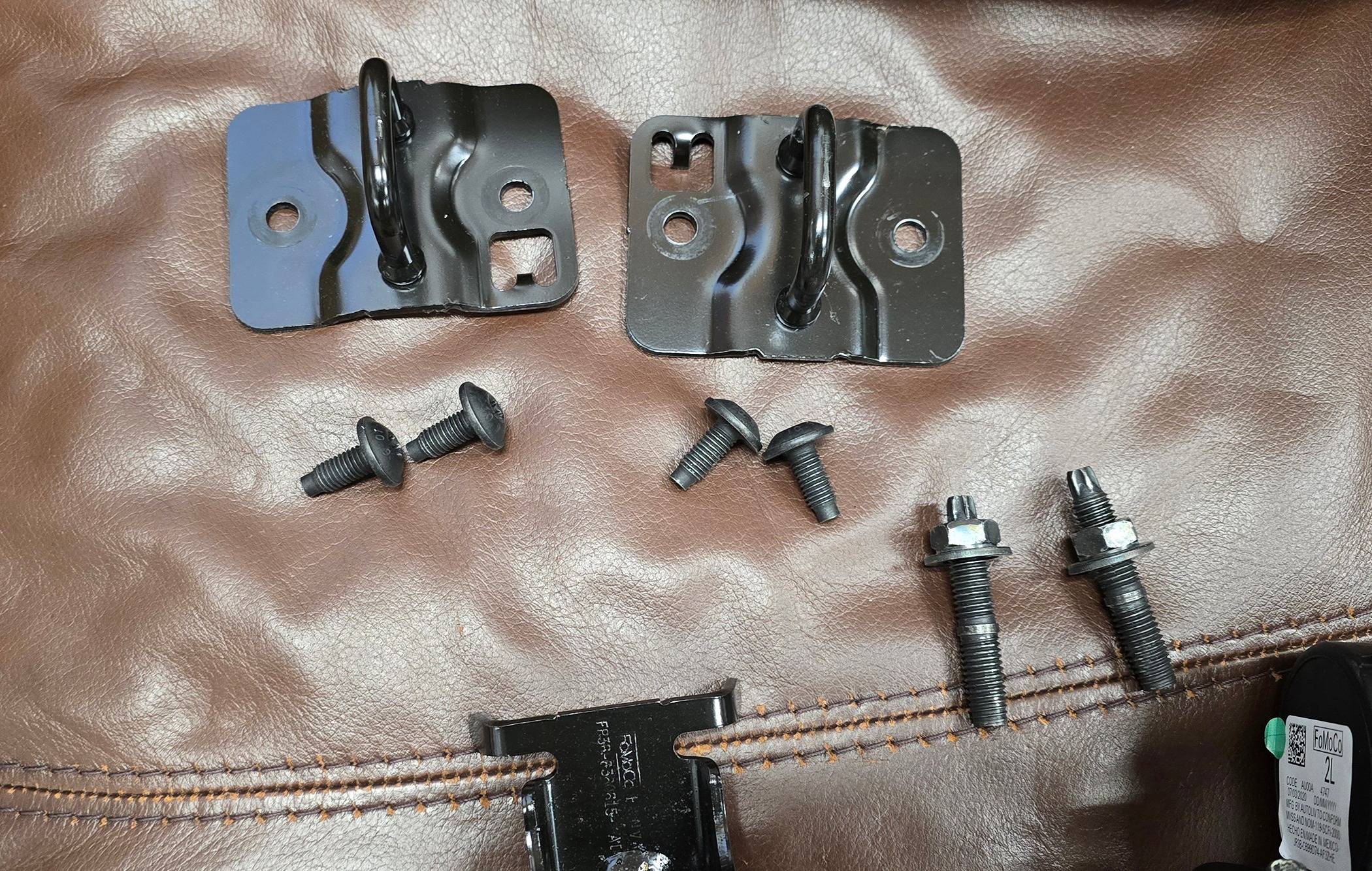

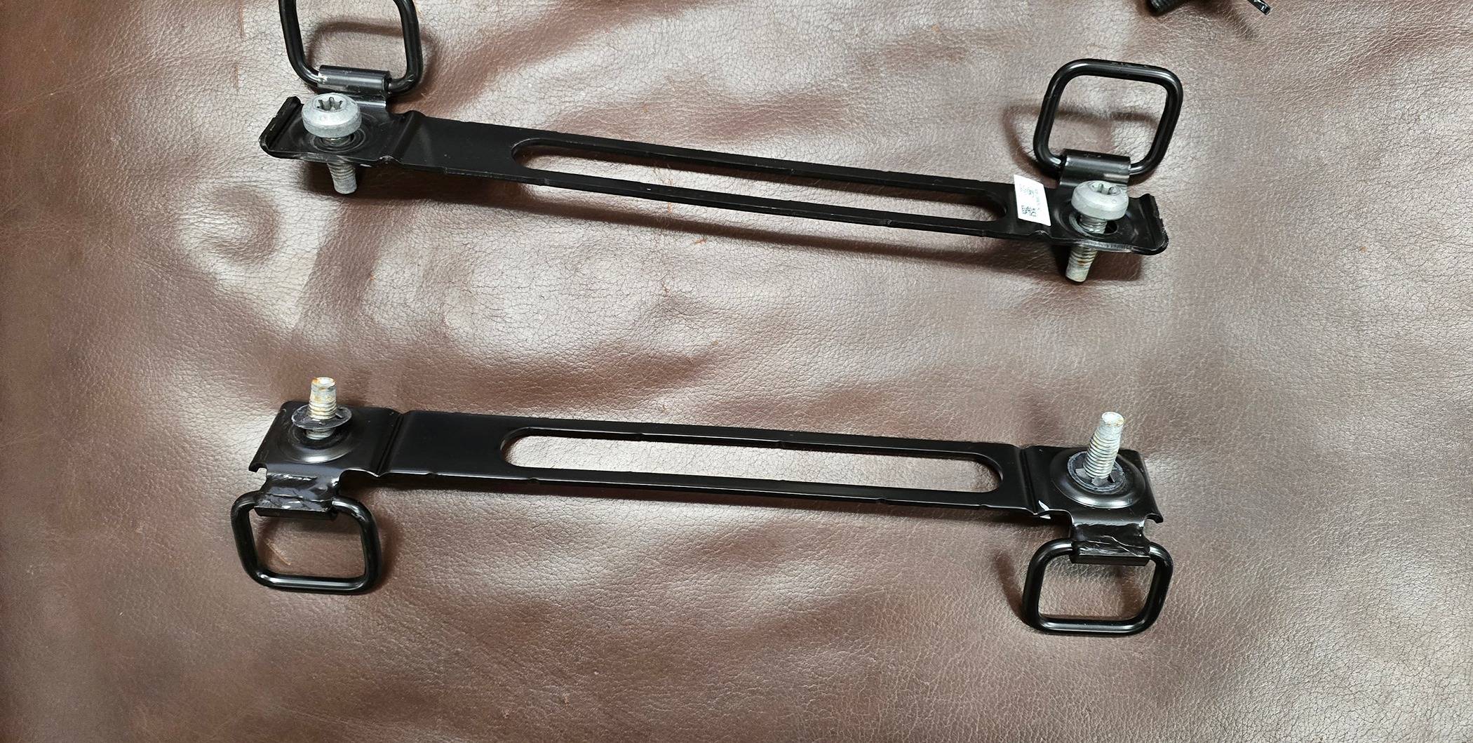

The bolts you're looking for are called "body bolts". Hardened. I'll post some picks of the ones you need in a bit. They're in a box in my shop. I pulled out the rear seats and installed a RSD kit. There are going to be bolts for the bracket that you mentioned. That's the kids car seat restraint bar. There are also seat belt bolts and folding seat bolts. Give me a bit.

That's every bolt and part you need to replace your seats and belts.
