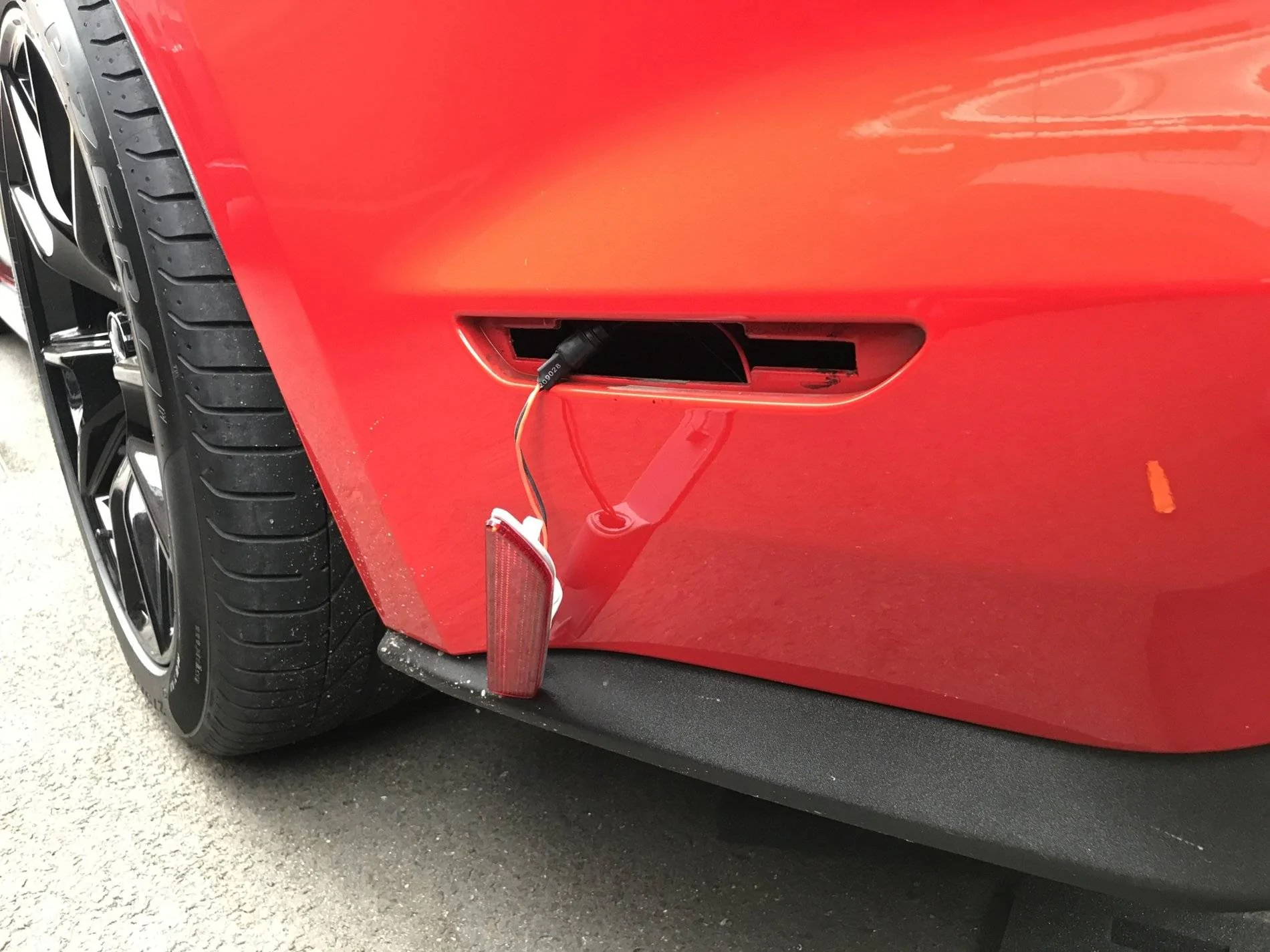

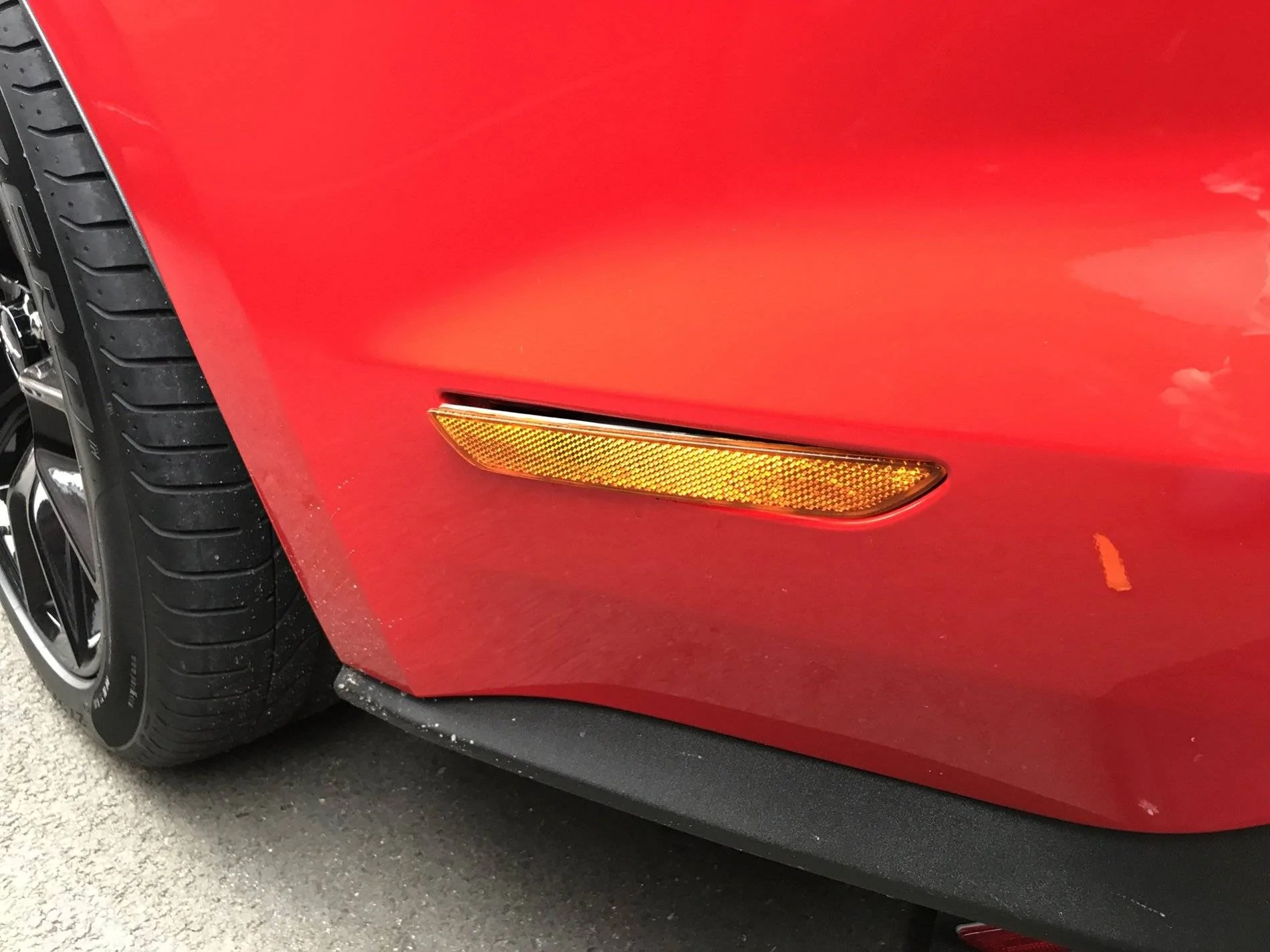

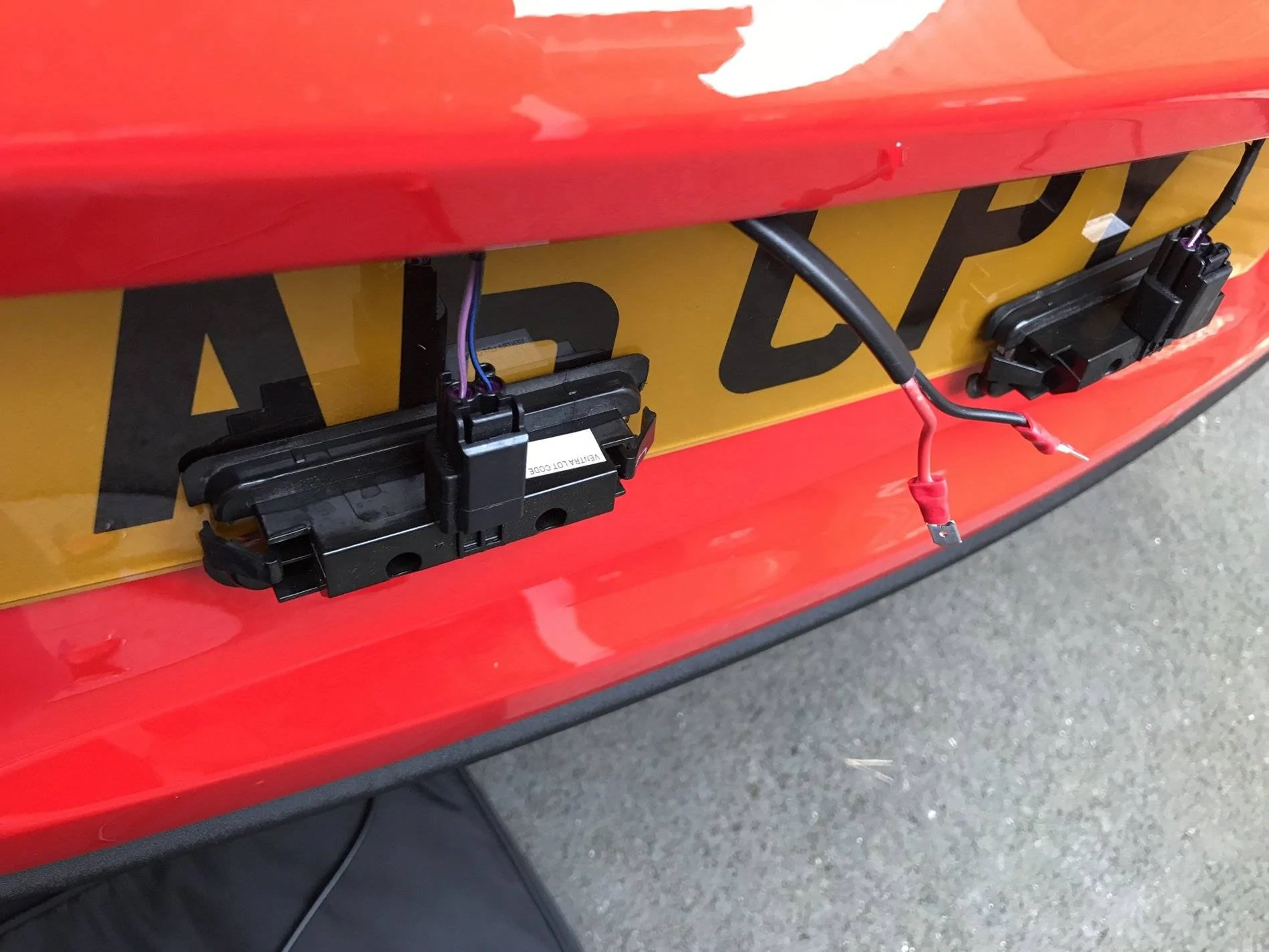

It is really quite simple you tap into the number plate wiring, fish cables down to rear marker lights and connect to lights.
I did a basic write up on my previous car so I’ll use those images again for ease

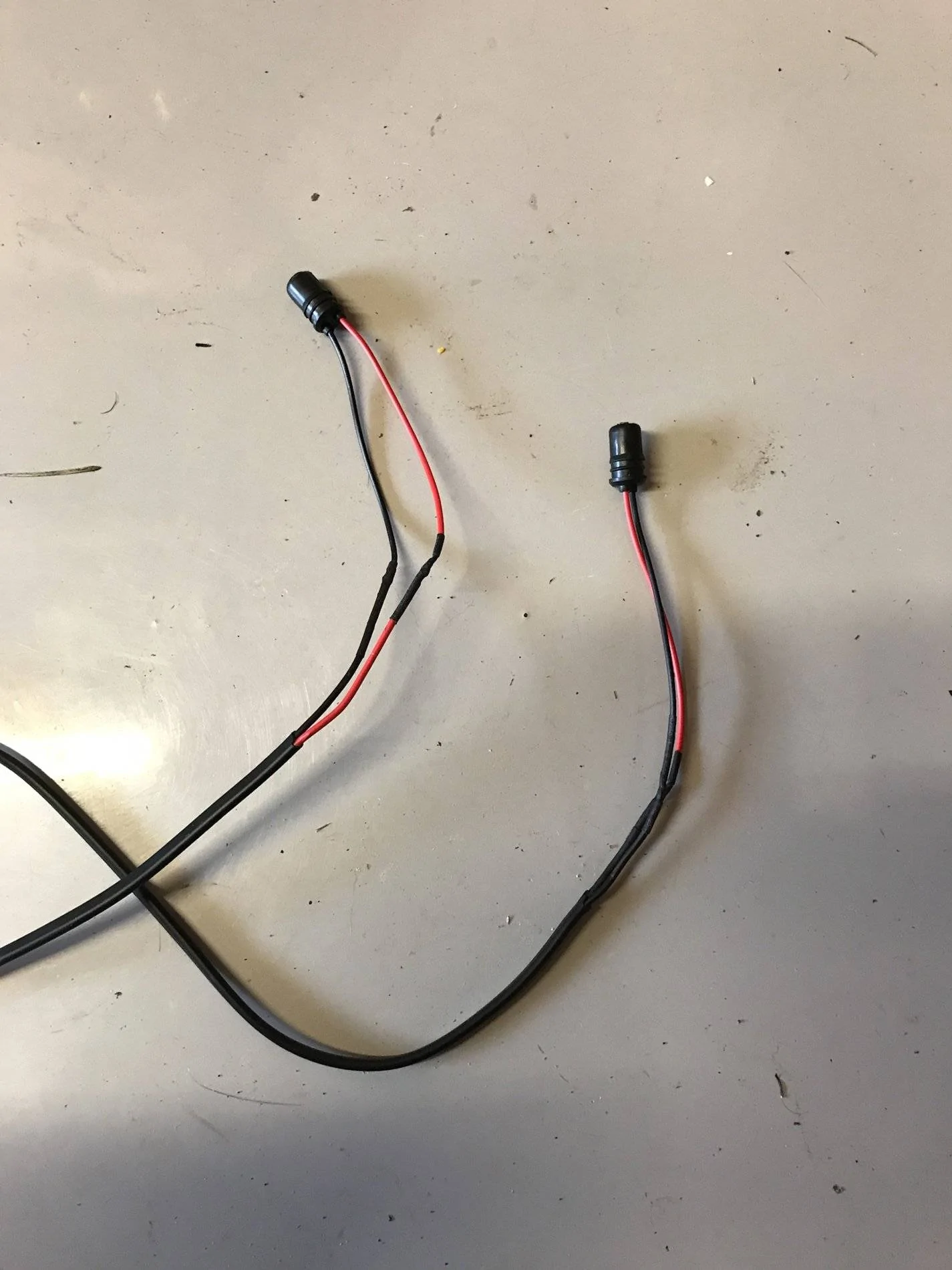

First up I made my own wiring harness where I sourced the ‘waterproof’ female bung fitting for the led marker light spade fitting to fit into. Note you need to seal this up with silicone to ensure it’s fully watertight. Any water ingress at the back will prematurely end the life of the markers

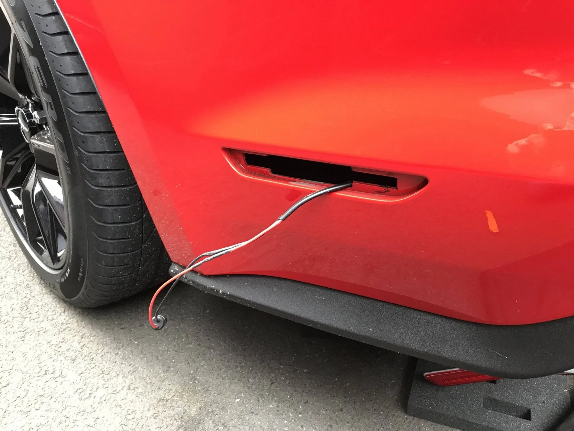

Pop number plate lights then fish the cables down to the ground. Best to have car jacked up (on axel stands) so you can get underneath to see what you’re doing!
I had a real challenge on the MY19 model as I could not get the wiring through. What I learned was I need to stick my fingers through the number plate hole and as I was feeding the cable in I was pushing down so effectively the cable was going straight up then immediately straight down.

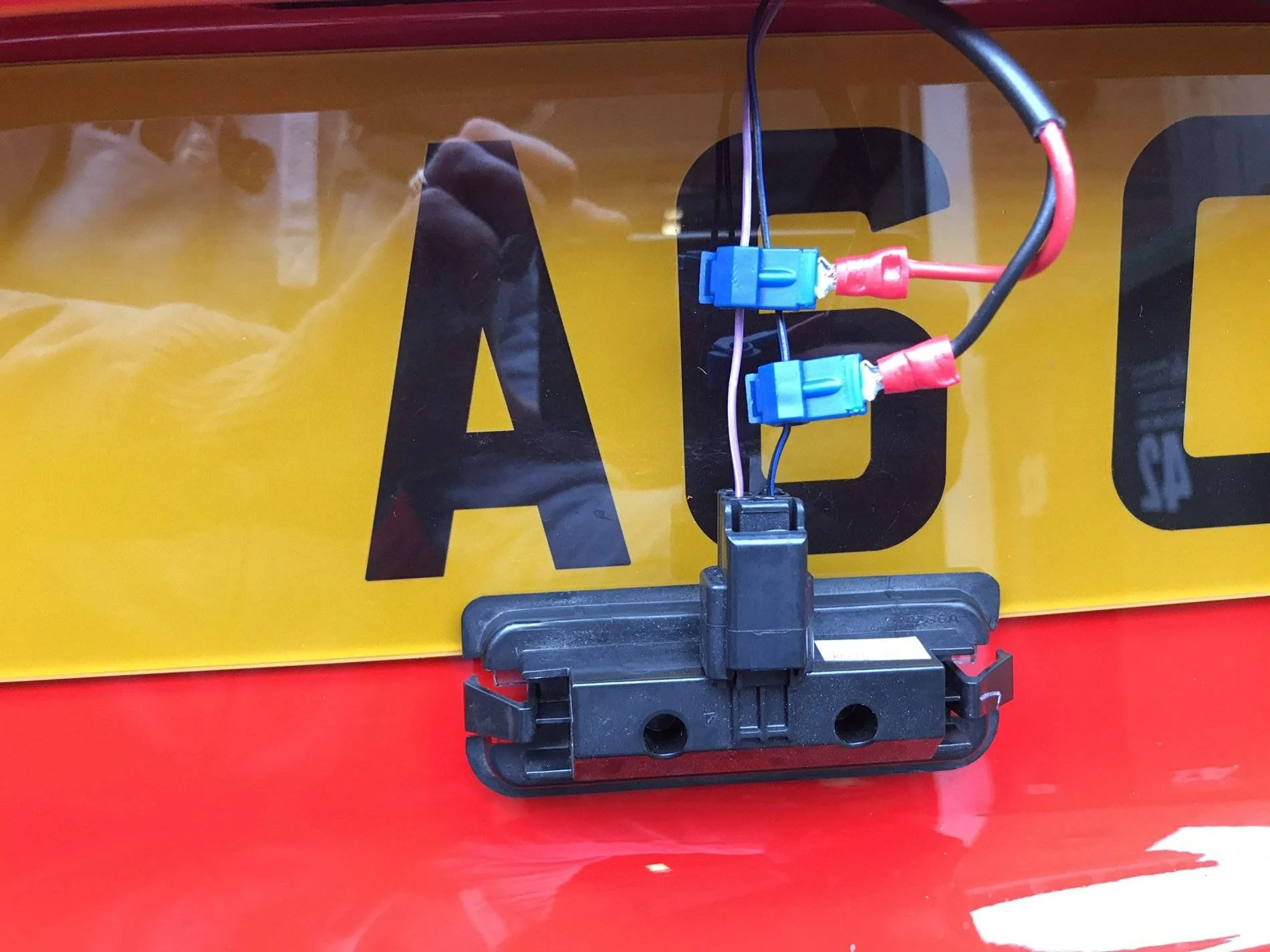

Next up is to tap into the number plate light wiring loom. Initially I used wire taps but later changed these to soldered joints as the more secure. For the MY19 install the wiring loom was so tight / short I couldn’t solder them as I couldn’t pull enough cable through to access it, so used wire taps securely taped up after.
Just make sure you tidy the cable routing so it’s not too close to the exhaust tips. I used stick on wire clips to secure the cable run, makes sure you have IPA / thinners to had to clean surface where these are to be stuck too.

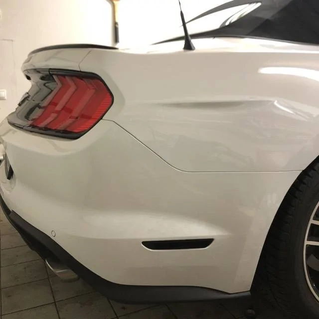

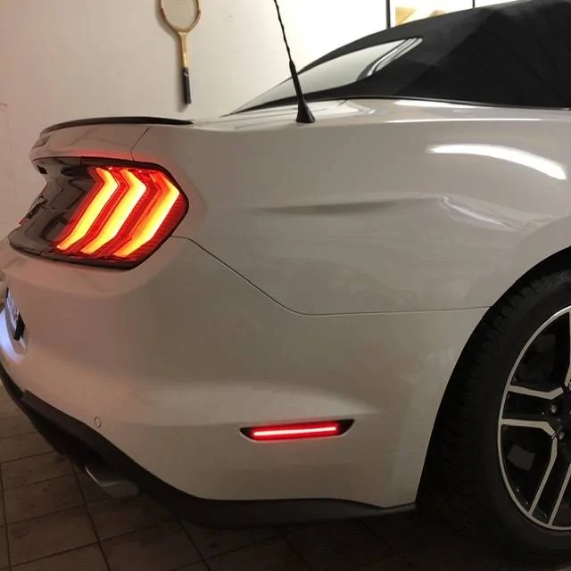

Hey! Just installed the LED markers, but dissapointed with the result :(
Looks realy great when off!!!
Looks cheap, when you turn them on:
1. The color is not fully matching the tails - more cherryish :(
2. You can see the small LED dots, which do not match any other lights on the car - this is the most dissapointing part for me. Usually you do not see that in the pictures, but in reality it is annoying :((

Interesting it looks like the tint overlay on marker is giving it that purple hint.
I’ve just gone for the plain red and it looks good. The bar is made up of individual led dots but unless you’re pressing your nose against it you’ll see it as a continuous line.
Maybe swapping it to a plain red marker will solve the problem for you

It'll be because the black markers blocking off most of the light displacement.

Looks cheap... but I wonder why don’t the make LED markers exactly like tail lights. Where you do not see individual LEDs, just a line...
My only guess is because they are reflectors there's a differing lense over them. For instance if you look closely at the tail lights and front drls there's a hazy somewhat opaque looking plastic over them. Whereas the reflectors, reflect (all around the LED Line) and then where the reflector is, is a clear plastic. I mean, you could give them that hazy opaque finish but it may look shit next to the reflectors finish.
That... or they're just plain lazy lol!
