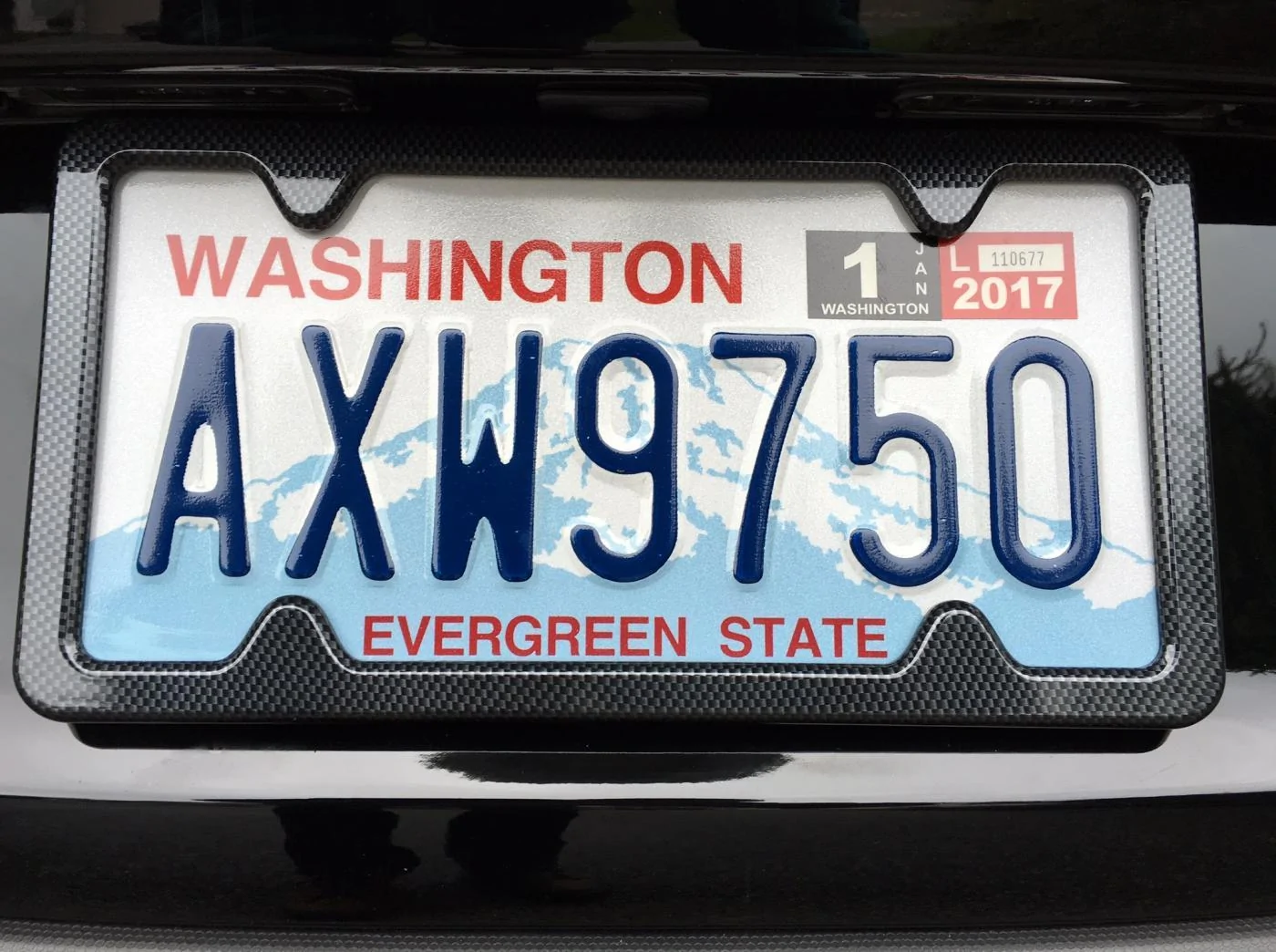

I dealer traded my Mustang GT from another dealer (wanted the electric seat instead of the Recaro in case my wife had to drive it. She is vertically challenged). They had stripped out the hole on one side (must have used a electric driver). I just put a plastic wire tie in the hole before inserting the screw, then trimmed off the extra and it was perfectly snug. No need for drilling and a nutsert.
I put little rubber bumpers under the plastic bracket, screwed it down and then snapped on frame.

Another one here who did the two top screws as normal and installed two little rubber pieces on the backside of the plate
SinisterX
Oct 28, 2015
40
west central NY
2016 GT350 Avalanche grey
where did you get that CF plate bracket ? Looks good
