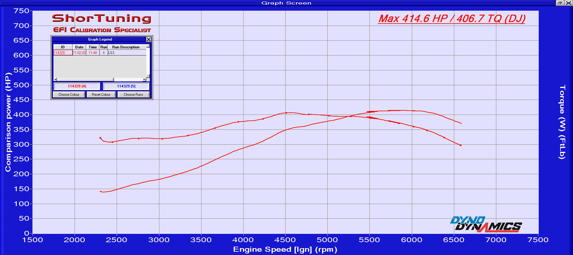

My 2 cents.
Rear gearing is part of the equation and there is no one size fits all.
I have a 68 C10 with a 2010 6.2 L99, 6L80E with 3.73.
It is stuffed with BTR goodies and after an hour or so on the dyno the very well known/respected tuner said I should put something like 3.08s in the rear to maximize the power and the 6L80.
It has 414 HP and 406 TQ at the tire.

My 2 cents.
What in the world does this have to do with the OPs question???
