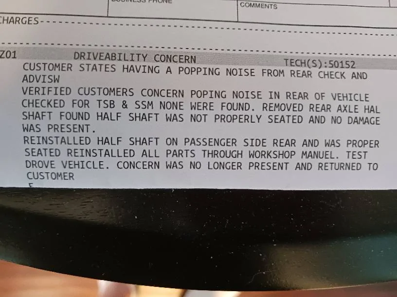

Well, I picked her up after 3 days. The dealer said this: Seems strange how an axle could be "not seated"?
I'm not sure how a half shaft that wasn't seated properly for 6k miles caused no addition damage. I would have another shop look at it just to be sure and if there is bring that to ford. Never trust dealer assessments, usually just a kid with a high school diploma who can turn a wrench working on those unfortunately.

I think @K4fxd nailed it with the inner end circlip.
Now, for the vibration, head on over to the famous driveshaft vibration thread. It is super long now. But, it could be that the dealer disconnected the driveshaft for troubleshooting, and did not reconnect it at the same clock orientation. Jack up your car and crawl under there to see if the paint marks match at both end of the driveshaft.
