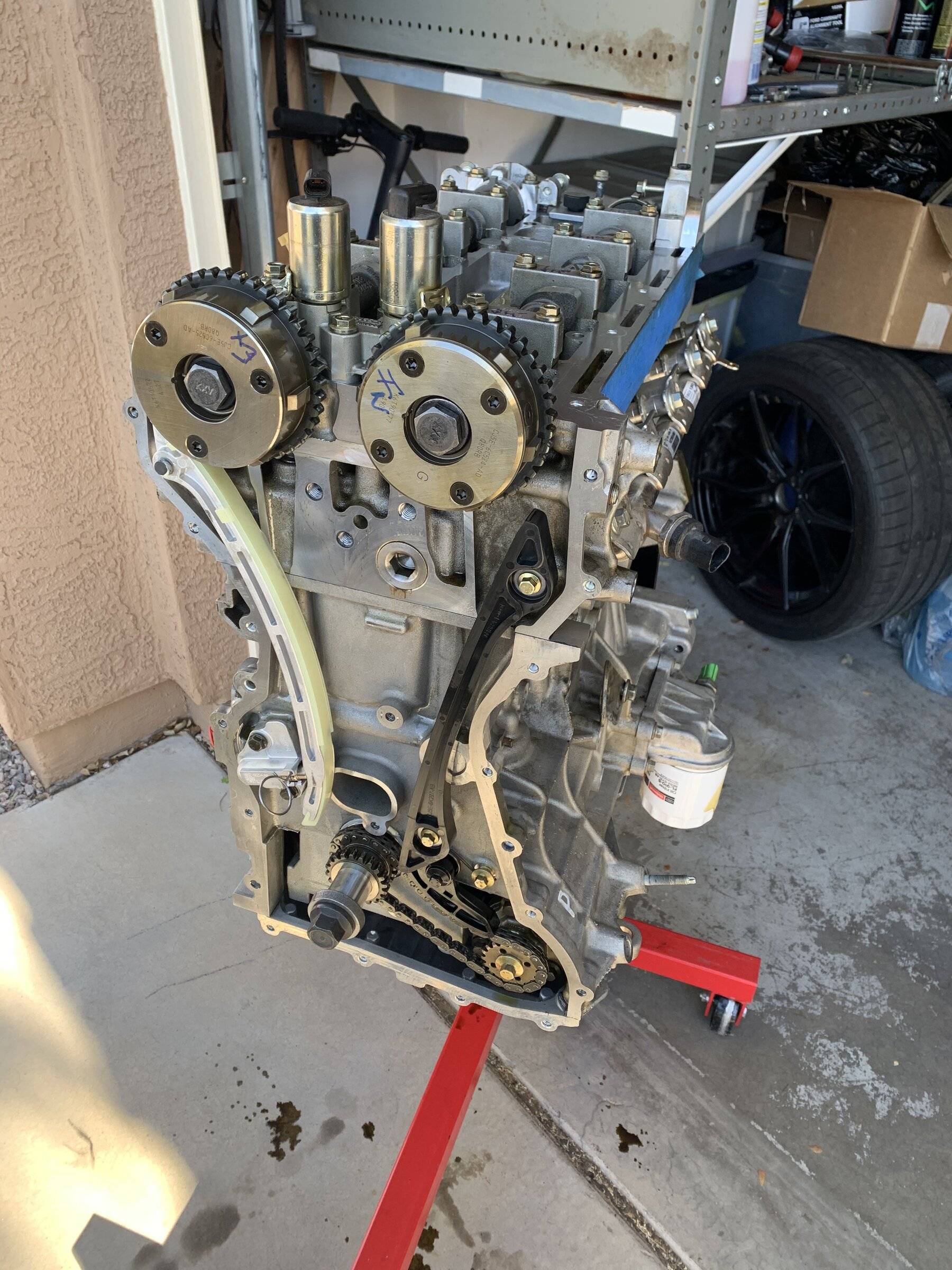

Really? I just finished rebuilding and installing the motor and you have the balls to claim I have no Mechanical skills?

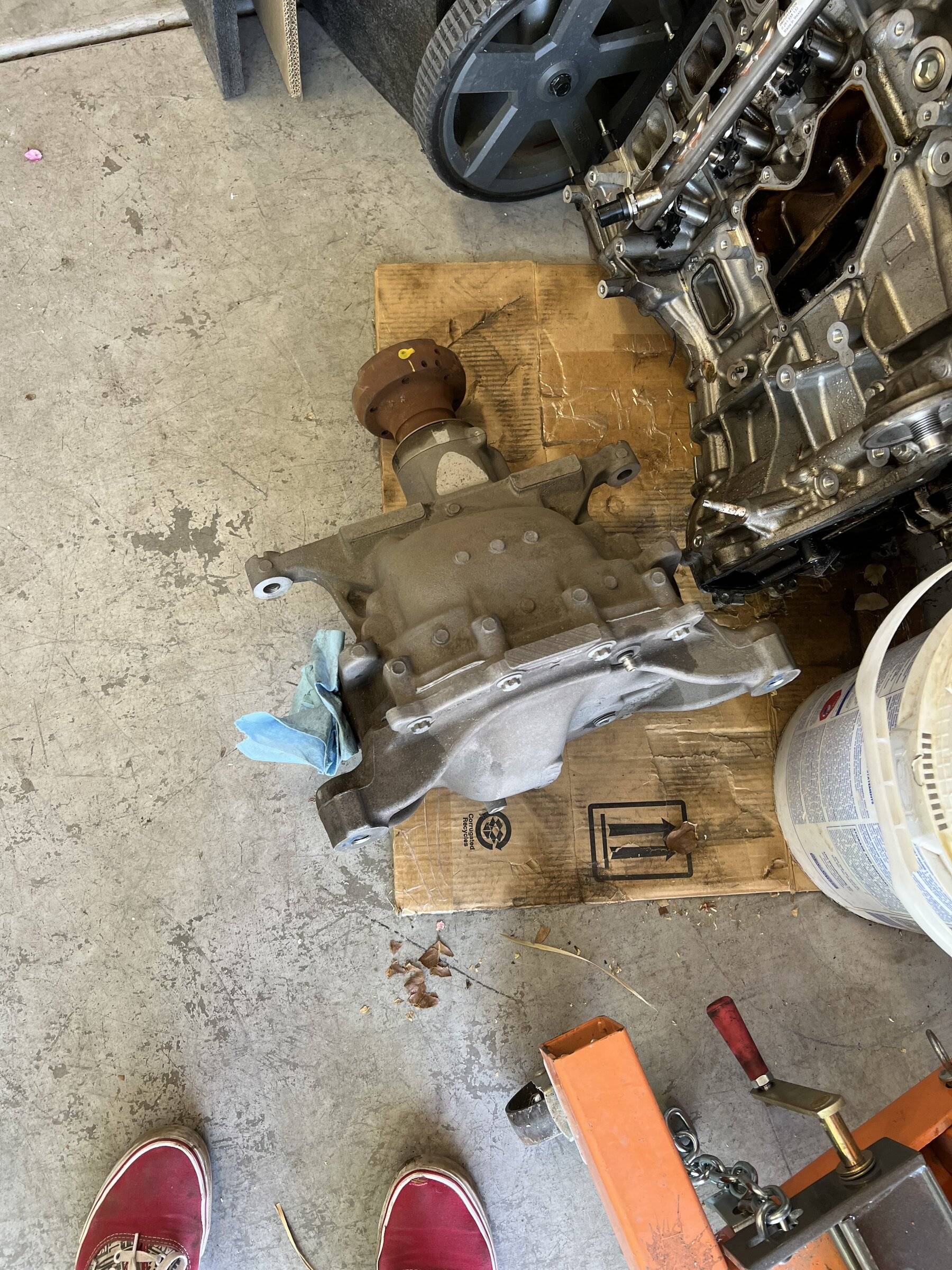

By the way, thanks to those who truly did help. Picked up this 2016 with 3.31 gears for $155 at the U-Pull-It parts store today. 58k miles.
